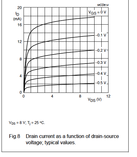

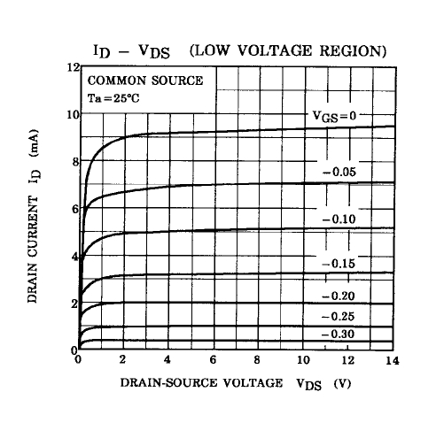

This the coparison.
ok i think i failed to see the importance of the driving fet s Vds. At such a low Vds, current varies a lot with Vgs, so we want the same Vds for the current source and the upper part. Hence, having high pinch-off cascode device minimizes this effect and helps zero the Dc offset.
And 2sk369 for example is more tolerant to this because Vds vs current are less dependent at low Vds compared to bf862, i.e hwat you said about early voltage
does this makes sense or am i in need of some reading?
edit: thus the 2sk369 has less distorsion than bf862 (for instance) because its Vds varies less for the given load and "works less"?
The more horizontal the drain current to drain source voltgae is the higher the ouput impedance of the Fet is. You could also say that it is a good constant current source.
The less the drain current varies with variations of Vds , the less distortion. The cascoding helps anyway because it forces a constant voltage ( more or less ) over the input Fets. My buffer has really minuscule distortion, BF862 or not.
