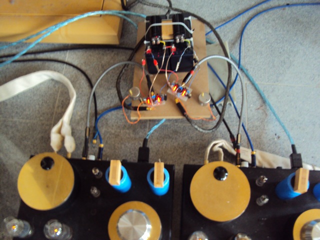

I have finished the work on the filter-buffer for the EUVL ESS9022 board. It is named 3.1.
To use a higher value resistor did the trick. Now the sound can have the mind drilling penetration i sometime need when i listen to soul or electronic music but it can also sound smooth, dynamic and full playing tube miked Jazz. Modern Jazz and classical has air and sparkle, without sounding sharp. Voices and instruments are just "there", present and natural. See the schematic.
I made other small changes. I raised the amount of local decoupling on the buffer power lines by 470uF Panasonic FM each. I placed the filter-buffer closer and more symmetric to my power amps ( i do not need a preamp, the power amp has a potmeter at the input like in Japan ) so i can use shorter and better cable. I changed the grounding of the cable from the ESS boards from digital ground to analog ground. The tiny hum is gone now. What is left is the noise of my tube amps that they produce by themselves. I have to work on this too to get it dead quiet.
I will post a picture soon.
best, joachim
Here is a picture of the new, more compact setup.

One question -- does R1C1 make a real sonic difference, or you just want another LP at 2MHz ?
The PCB layout is basically finished and measures 30x50mm approximately.
(for 2 channels, with an option to parallel 2 FETs at each location of the schematics)
I'll see if I can squeeze in R1C1 by using SMD pps film caps (Panasonic).
Silver mica would be too large, also expensive.
Patrick
This buffer is very wide band. When you simulate it at very high frequencies ( actually the layout and the PCB plays a role too ) you will see that there is a peak, then a minimum and then again the response can co up. This is because first the circuit goes inductive and then capacitive again. I like to stay out of that region. Also the input capacitance of a Fet is not very linear. I fact it is a very bad capacitor with distortion. The cascoding reduces that effect somewhat. You can use an NPO ceramic. That works well too. It is basically an open circuit in the audible range.
