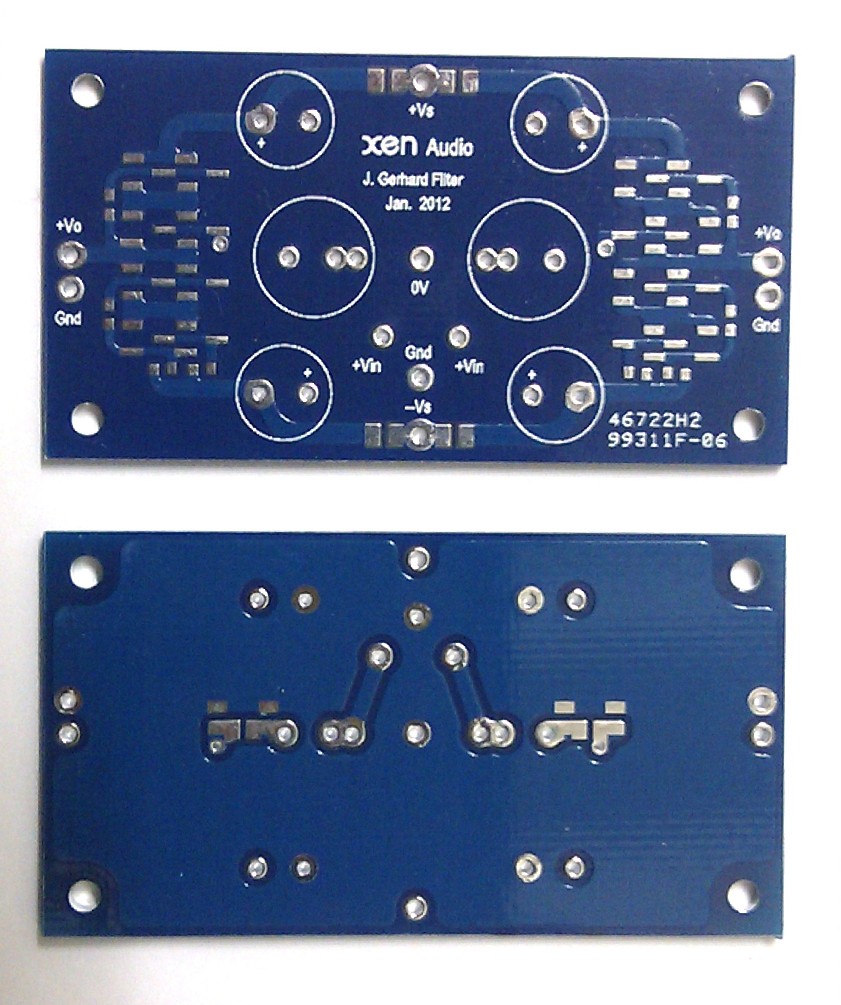

I got interested in this thread and made a PCB for the filter circuit by Joachim Gerhard. It uses MELF resistors and 805 Capacitors. I will be etching the pcb this weekend and try it out.
Thought would publish the PCB so that interested DIYers can make one for themself. The pdf file has the 100% scaled image for PCB and the image has the silk screen on it. Its on the top layer so make sure you do a mirror print when transferring to pcb.

For proper DC tracking, you need to thermally couple the JFETs, so they want to be placed closed to each other and also thermal glued to a common heat sink.
Our prototype PCB is being factory manufactured right now, but the Fastron inductors might take longer from Mouser.

Thanks Patrick for the suggestion. I will try to move the JFETs closer and when I build I will stick a heat sink on top of them.

I built Joachim Gerhard buffer / filter over the weekend and listened to it for few hours on Sunday. Sounds good and I like it. Will play around with it for some more time. I used the Fastron Inductor from mouser.com.

I was requested by PM to give an update for the Joachim gerhard buffer.
We have the PCBs as you can see. We matched the BF862's.
But before we could match the J111, the team member involved has a family emergency.
