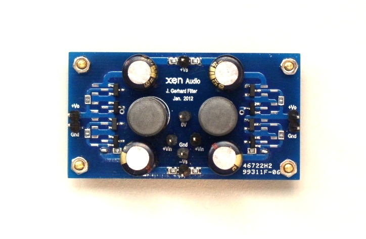

The first prototype of our J Gerhard Filter Buffer is working.
We'll do some listening on the ES9022 as well as our "new" PCM5102 modules, before sending it to Joachim for his final approval.

That looks very good !
And you got the brand new PCM5102. That claims very little out of band noise to begin with.
