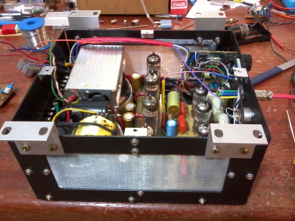

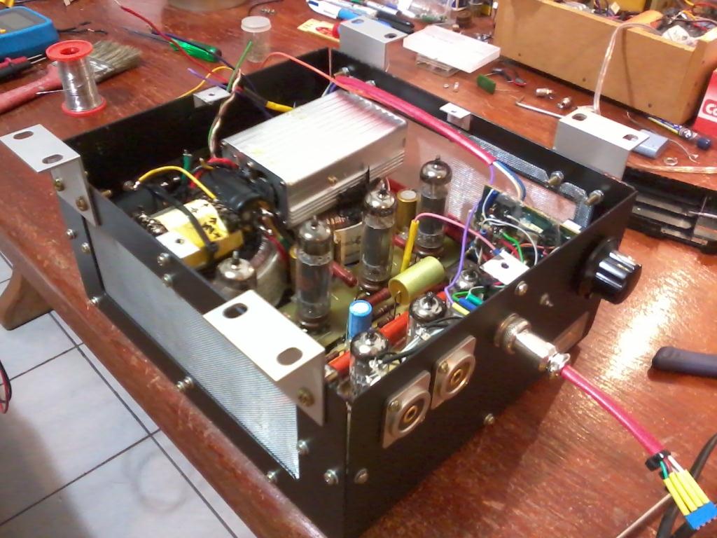

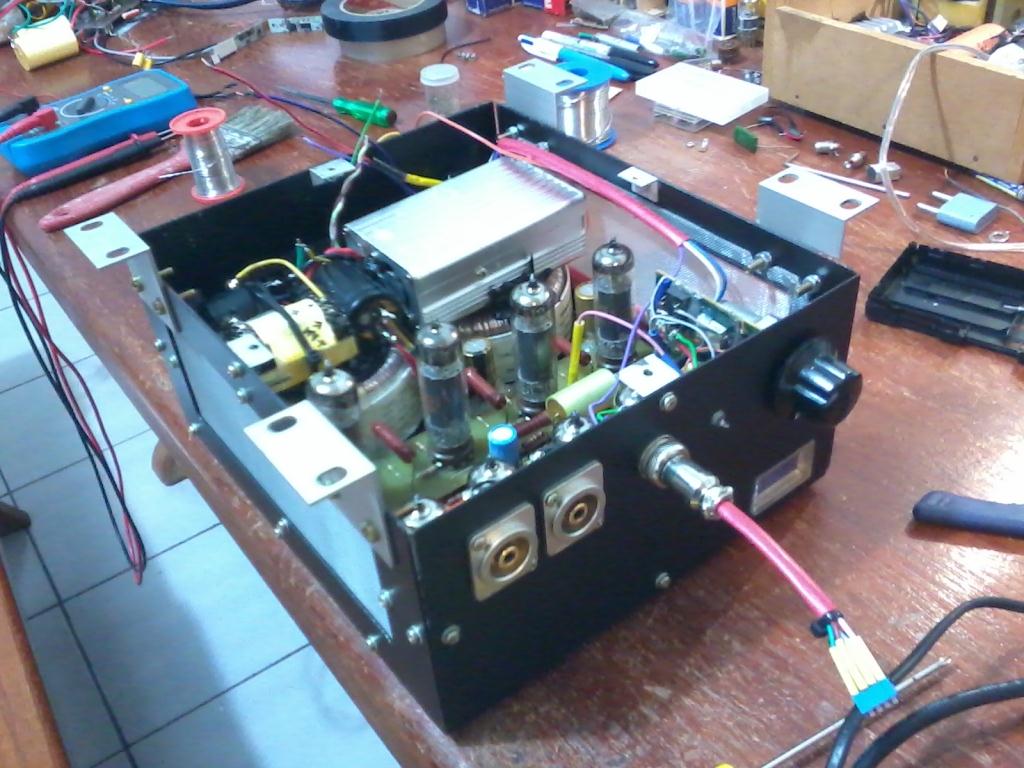

My tube car amp! Yes, I use!
Using 6EM5 in PP-Schade output, and input more-or-less-like Quad II, with EF86. Filaments connected in series, and all "6V3 mid-taps" are connected together, to average the filament unbalance between series'ed tubes. Used since nov/2013 at least one hour per day and tubes are like new. Microphonics are non-existent or non-perceptible.

I used in my project an el-cheapo China inverter (to 220V with chopper output). I added an choke to make them DC regulated (LC output rectifier). With the that supply I regulated to 275V and maintain regulated to 11V from battery.use a euro dc to 220v inverter. should have about 300v dc at 75 watt . Ditch the 50 hertz ac output circuit.
