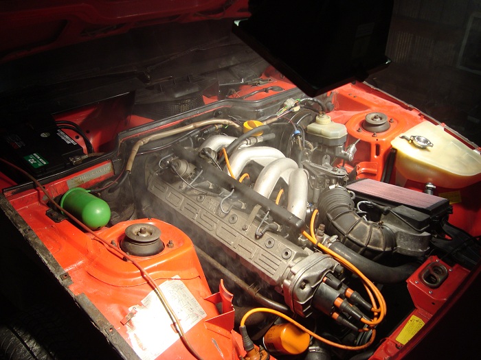

well, the engine is from a VW commercial van...
I believe the Porsche dudes wouldn't quite agree on this...
But it's an other story...
No it's not, do your research, my car is a 944.
Typical jealous statements, I have heard them all before.
A 944 has a 944 engine designed for a 944 based on half a 928 engine.
I have even been told it's a kit car, seriously who get's a 944 kit car?
Now show me how to put this large 2.5L into a transport, or produce one single picture.
I've never heard or seen a VW van hitting 6K on the tach. lol

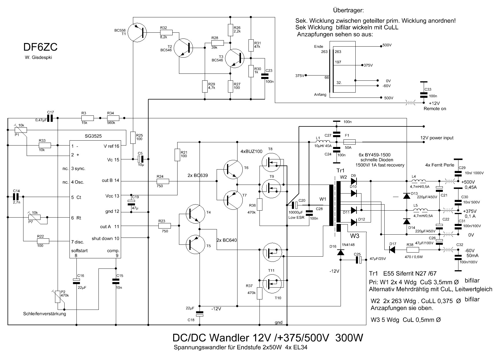

Hi all,
I made some considerations about an valve amp for car installations. I think it is feasible to build an reliable and safe amp. It can be done with any kind of circuit design . The limitation is only the power supply. It unlike at home where you have near unlimited amount of electrical power. In a average car the maximum input for additional equipment is somewhat of abt 500W with the engine running. For practical reason you should not draw the maximum available current from the cars power system. The generator shall after all have enough headroom to charge the battery after the engine crank action.
If you design an amp so it shall draw no more than abt 30 Amps. I build an power converter which was intended to run an HF PA with 200W for ham use in my car . But the project was superseded by an old 400W army power amp I came accidently across the other day.
The schematic of this inverter is shown below. I made a breadbord setup to make some measurements. At 13,8V input the output voltage for plate is 500V / 0.45A, screen supply are 375V/ 0.1A, and finally the grid bias 60V/ 50mA.
The efficiency is abt 80% at full load. The non load consumtion are 1A.
the inverter is build with common available parts, exept the transformer which is an double E ferrite core , Siemens/Matsushita/ Epcos EE55/20 mat. code N27. The core I used was salvaged from old equipment. The output chokes are also scrapyard recycled items.They are from PC power supplies.
The inverter will deliver enough power to run a 2 channel 2x50W amp with EL34/6CA7 or 6L6GC . As someone posted to use the russian GU-50 with the tank type sockets. They are intended to use in aircraft radio sets. They will be ideal for car hifi use.

i successfully use hybrid car amp (made by me ) with no problem.
Power supply isn't a problem. Simple push-pull SMPS and many many many turns for the HV Or you can make a boost converter from the positive power rail (in case of hybrids) like Nixie's smps.
