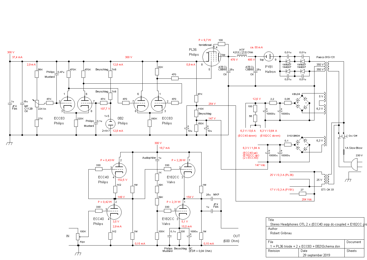

EL504 could you please explain the role of the tubes in the PSU ? an elaborated regulation ? Especially the pl36 role ? Thx !
Hello Cbueche,
The power supply is based on a schematic published in AudioXpress: https://audioxpress.com/assets/upload/files/bicknell2890.pdf
I used a PL36 in stead of an EL34 and an 0B2 in stead of a zener diode.
The PY81 serves as a time delay. It takes a PY81 about 50 seconds (old production) to 30 seconds (newer production) to start to conduct.
Thank you for the pointer, certainly an elaborate way of filtering, but as the article mention, quite wasterful in energy. OK for a headphone amp, but doing the same for a power amp would be even worse. As such I like the capacitor multiplier of Pete Millett better. Not really a regulation but it does a fair job of getting rid of PSU ripple. Or his approach with the Tentlabs MEC is cool as well. Anyway I was intrigued because I have got 40 PL36 tubes, this triggered my curiosity.
