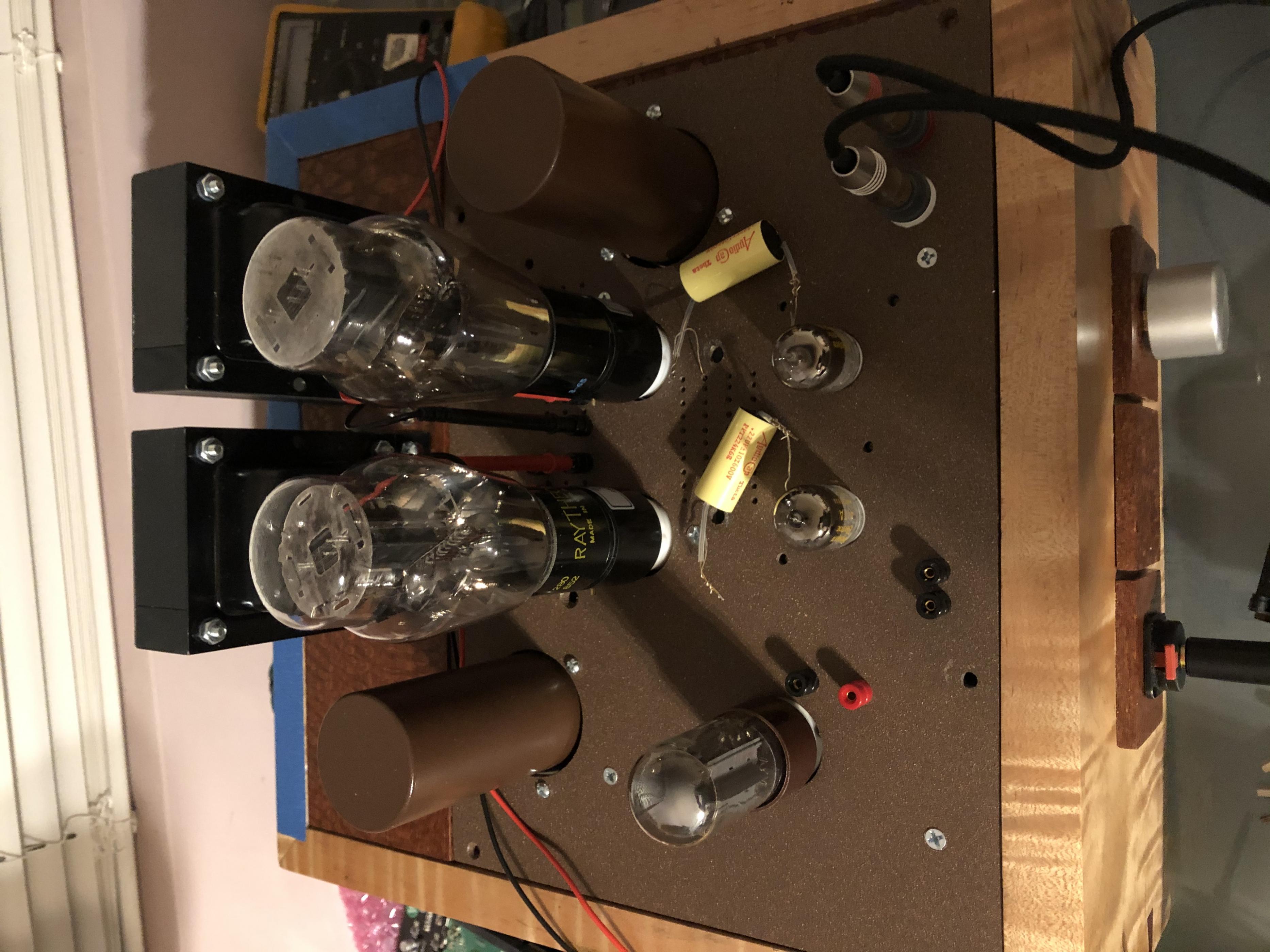

I attached a pic of my tubelabs se #45 amp.
The power tranny is in the chassis, back left corner in picture.
In case you're wondering, these are actually #46 tubes with an 4 to 5 pin adapter.
I had a breadboard version, will see if I can dig up a pic of that, which was really quiet, no hum. When I moved it into the chassis shown, hum showed up.
In the breadboard, power tranny was in the front of everything, in the front left.
I have tried adding some strips of magnetic shielding material on top of the power tranny, but based on comments the field is going around my material, was wondering why it didn't seem to make a difference.
Any suggestions for making a housing? What material to use that isn't too expensive?
I'm thinking about moving the power tranny outside the box, and see if it helps. Might even try a 2 box solution. Would move it to the left of chassis, left of the rectifier tube.
Pic rotated when I imported. My references are if the front was facing towards you.

EM fields couple,what under normal conditions goes unnoticed. Because of distance fields weaken, so the effect drops under the radar. It is a fact none complete shielding weakens the coupling, think about the heads of a taperecorder for instance. Shure, for optimal result there must be several layers of different (magnetic) properties so the energy is soaked. Just like isolation of airborn energy.

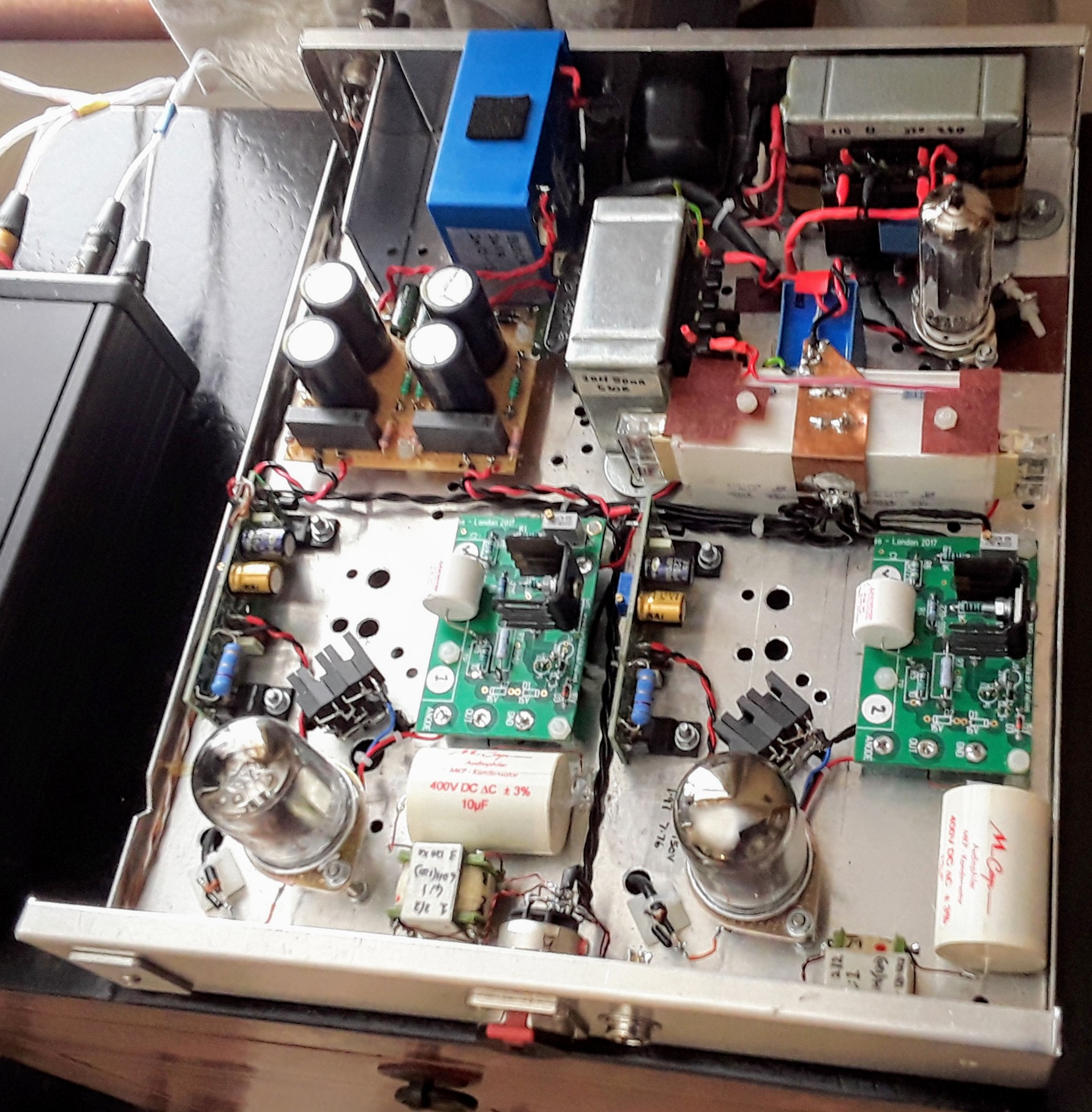

View attachment 790491Pic of my amp in transformer o/p mode :-

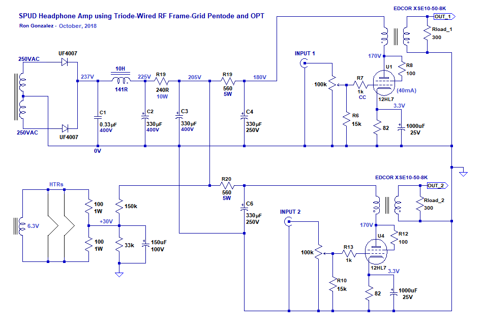

Does anyone in Hungary or EU make a cheap 8k:50 (12.5:1) output transformer good for 5 watts output at reasonable bandwidth? If so, you could make a super-simple single-stage OPT-coupled amp that could sound quite good, and for cheap too.
Edcor in the USA makes such a transformer:
EDCOR - XSE10-8K
Perhaps a triode-wired D3a or Soviet-era 6Zh52P into such an OPT? 6S45P?
I used a triode-wired 12GN7A and it's working quite well. It has only 6dB gain after the step-down, but that's enough for my needs.
The design could not be simpler.
Audio is a volume control on the input, triode-wired pentode with cathode bias (fully bypassed), into the above-mentioned Edcor output transformer.
Power supply is solid-state rectified 500VCT 150mA EI core transformer, choke-input with a common stage of RC decoupling, and then one more RC decoupling per channel. Target Ebb is about +180V DC. Heater supply is 6.3V AC, elevated to +30V with a simple resistive voltage divider. Somehow I managed to wire it cleanly enough that there is no audible hum, none at all.
Easily point-to-point wired (no PCB necessary).
I can post a schematic and a picture of my little monster after I get home. I built it into a discarded amp chassis, so it's not pretty. But it's functional.

Schematic of my little monster, attached.
I use it to drive Sennheiser HD650 (actually Massdrop HD-6XX) and Fostex T50RP. It drives the Sennheisers better, but it can drive the Fostex cans to satisfyingly loud volume.
I have an Objective2 amp to compare. I find the O2 sounds more sharply detailed, and of course its bass response is more authoritative ('faster', 'punchier') and sounds like it goes lower in frequency. I find the little monster sounds smoother, a bit darker in the highs, generally more mellow. But it does not sound woolly, fuzzy or 'slow'. Just a tad 'dark', which I actually like. That could be the sound of the OPTs, which are cheap (about $25 USD each) and probably have limited bandwidth compared to $100+ OPTs.
