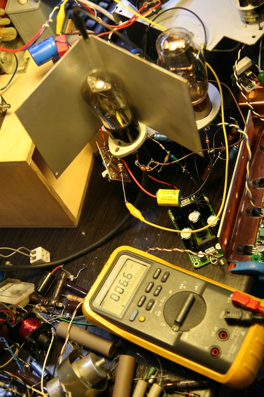

Hopefully not derailing this thread, but I'm fighting a hum problem right now in my headphone amp. Its a Tubelabs SE amp with 45 DHT's. Looking at shielding the power tx to see if that helps. With the high current required for DHTs, I don't know if putting the tx in another box is a good idea, but maybe I'll try and see what happens.
My low impedance, planar headphones sound fine, tiny bit of hum, more noticeable on my hd800's.

Take an iron sheet and just put it between power tranny (or choke) and your output transformer. If you find appreciable lower hum it's a sign the transformers are coupled and should be rotated. If no improvement you should investigate grounding or wire dressing.Hopefully not derailing this thread, but I'm fighting a hum problem right now in my headphone amp. Its a Tubelabs SE amp with 45 DHT's. Looking at shielding the power tx to see if that helps. With the high current required for DHTs, I don't know if putting the tx in another box is a good idea, but maybe I'll try and see what happens.
It won't help, you need it around. Such a way you can shield capacitive coupling, not magnetic.

Im Geoff in Ale,s blog. I wanted to use a single chassis for space reasons and I have a few of the cases
available. They were 300mm deep x 250 wide x 70 high. I placed the mains transformers at the rear of the chassis along with the graetz bridge ez80 rectifier. The two valves along with their coleman reg boards and Ale,s mu follower boards were about 2/3 along.
When I got the amp running I got hum as I probably should have expected. I moved the valves right to the front of the case hence the extra holes and tried different oriientation of the transformers plus a belly band around the ht transformer. All this did reduce the level of the hum but did not eradicate it completly.
What did was rewiring the amp to minimise the loop area of signal/return and power/return cables.
Finally I wanted to have the signal i/p sockets at the rear of the case but I didnt do this initially because the transformer for the Coleman regs would be quite near. I placed some mu metal foil shielding between the transformer and the sockets which worked. I could see the reduction using my scope
probe as sniffer.
The amp is absolutely quiet and sounds gorgeous. It drives my Sennheiser HD800,s with ease. I can drive them directly from the mu follower o/p as its o/p impedance is about 30ohms but it needs a big cap so I use a 100uf/500v dc-link polyprop. Ive also tried using a 4 1 step down transformer in parafeed so as I can use a smaller "audiophile" capacitor. The sound is slightly different but I cant make up my mind which I prefer.
Im about to make another one with some 10Y,s because I want to see if thoriated tungsten cathode dht,s are as good as Ale and Andy Evans say they are. I will use the same chassis because if I can make one quiet I hopefully can repeat it.
