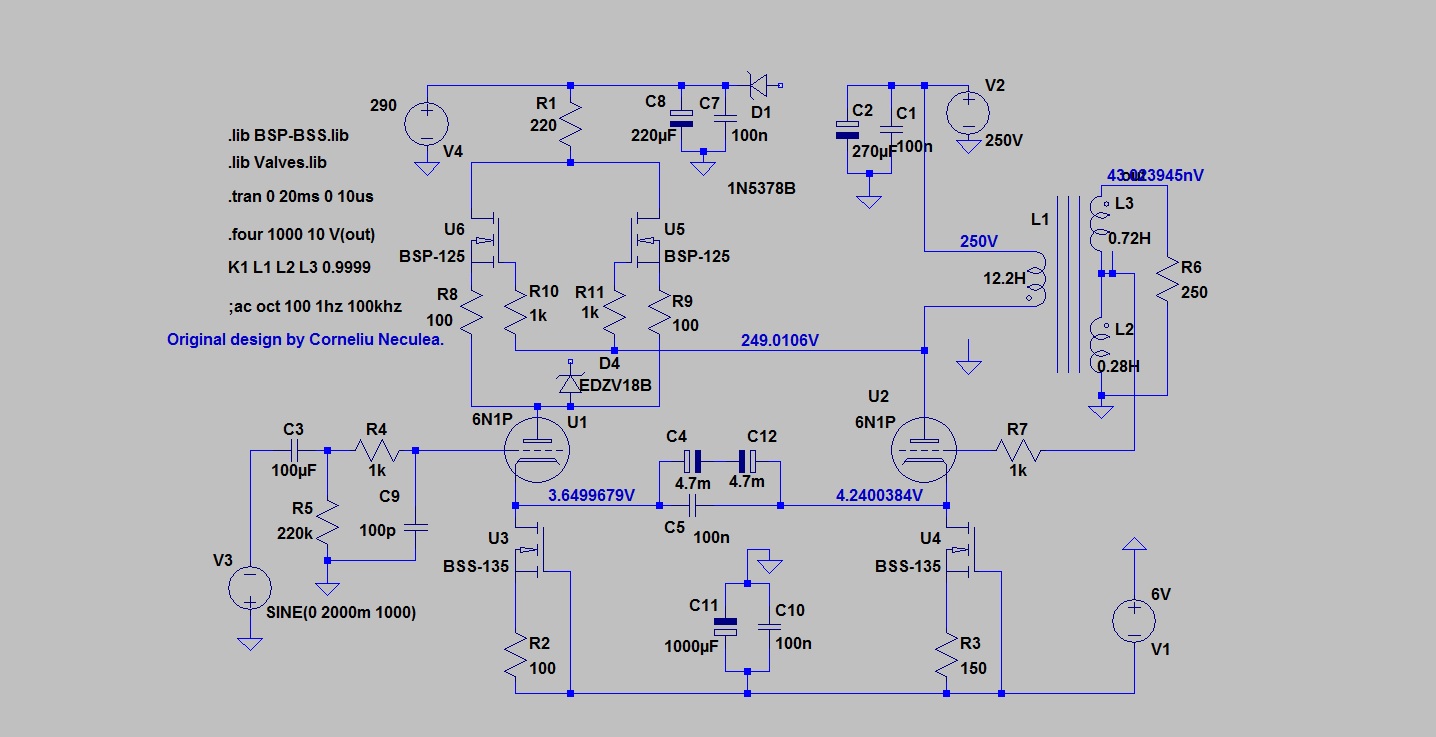

Interesting headphone amp circuit, especially the relatively
low plate supply voltage.
But I cannot find a specification or characteristics of this tube on the internet.
Can someone be so kind to supply it?

Interestingly its a frame grid tube with a 10 watt plate (TV video amp):
https://frank.pocnet.net/sheets/135/1/12HL7.pdf

Schematic of my little monster, attached.
I use it to drive Sennheiser HD650 (actually Massdrop HD-6XX) and Fostex T50RP. It drives the Sennheisers better, but it can drive the Fostex cans to satisfyingly loud volume.
I have an Objective2 amp to compare. I find the O2 sounds more sharply detailed, and of course its bass response is more authoritative ('faster', 'punchier') and sounds like it goes lower in frequency. I find the little monster sounds smoother, a bit darker in the highs, generally more mellow. But it does not sound woolly, fuzzy or 'slow'. Just a tad 'dark', which I actually like. That could be the sound of the OPTs, which are cheap (about $25 USD each) and probably have limited bandwidth compared to $100+ OPTs.

There is a 4.7uF coupling capacitor to block DC through the primary. As it sits I am using a 230:24 volt transformer as the OPT. My phones are 55 ohm giving a reflected impedance around 5k. 230/24=9.58... 9.58 squared equals 91.8. 91.8x55 ohms = 5.048k. Toriods are notorious for parasitic capacitance, killing the upper frequencies. This can be overcome with biasing the tube to pass more current. I haven't done a frequency sweep with this setup (currently biased at 40mA). But my tests with a 6p15p headamp with Anteks indicated that bandwidth was over 40khz or so with bias as low as 30mA. I don't remember the exact results and my frequency generator has limitations. And for those who don't want to fork up the cash for Coleman regulators up front... 2 volt SLA cells can be bought for cheap on Amazon. You will need a charger for them though. For amps that aren't swinging a lot of voltage, I have found that toriods work exceptionally well.
I use this. It will swing 42mA. 28R is close enough to 32R that this circuit will drive it. Bonus: No OPT!
The tubes aren't JJ, but you can use ECC99 instead of 6N6P... 6N6P is cheaper though 🙂

Reflecting to above design, I found something on the big internet with help of Google. I think the aforementioned design (drawn on black background) stems from this circuit design, right ? Especially when I look at the filename of the black circuit schematics (Aikido).
So at the very end - which one would you build ? (32 Ohm headphones).
In the linked 'original' I very much like the idea of safety resistors, should anything go wrong in the small amp. So I would build the 'safer version' at the very bottom of the page, would you please just have a quick look at it - will it still suit for 32Ohms just as well ? I also like the simple design and the possibility of using different tubes (within range) without altering anything else.
I would then order the tubes and let the fun begin.
Another question to the PSU part: +220V needed (except heating of course which will be separate). I assume I should strive for a stabilized and filtered one than a very bare minimum/simple one, right ? 🙄

I would build the one I linked, but I guess I'm biased 😀 It is based on Broskies Aikido, but it doesn't use the "aikido"ing, just the active loads.
As far as the PS, I just use a 12V SMPS and a DC-DC boost converter...
Here's a 12V SMPS: New 6A-8A Unit For 12V 100W Switching Power Supply Board AC-DC Circuit Module | eBay
And the DC board: 150W Inverter Boost Board Transformer DC-AC Converter 12V to 110V 200V 220V 280V | eBay
