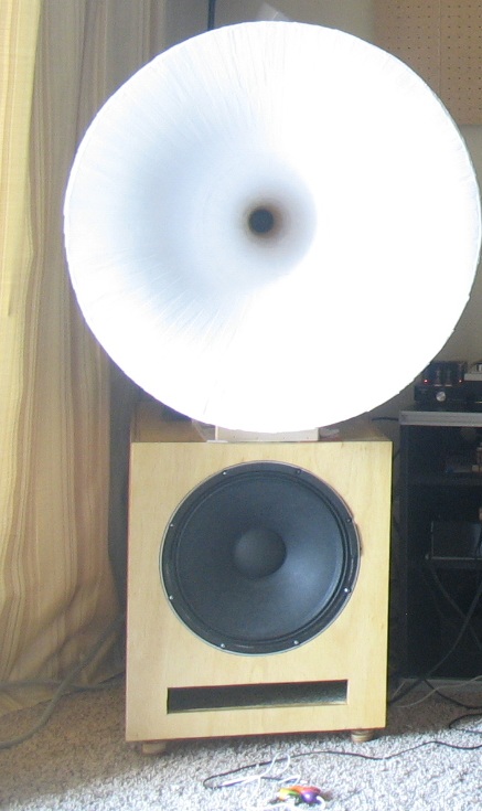

By modern standards, yes, very large. At that point, I tend to lose interest, since if you can accomodate a cabinet that large, you might as well have a couple of quality 15in HE woofers XO'd to compression mid-tweets from ~500Hz > which covers all the wideband bases, and gives you a heck of a lot more dynamic range.
Quite good. All the things Scott said. It is a 15" HE woofer crossed to a 2" CD on a large tractrix horn. Crossover is 500 Hz LR24.
Still a lot of work to do. But sounds effortless.
It's already telling me a lot about my system. I thought I had a pretty good digital front end: XMOS async board going to a CS4398 with output trafos. But hey, a DL103 on an SL1200 beats the crap out the digital setup.
There are similarities to the ANs, but there are differences also. Similarities would be the same kind of musical, lifelike sound. The horn+woofer combo does have massively lower distortion, no resonances to speak of, smooth HF dispersion, and quite flat above 300 Hz.

You mean something like this?😀
Sort of, but I'd prefer twin 15s (minimum) in a much larger box with a slightly smaller mid-tweet horn. Altec for preference. But in terms of very general concept, yes, along those lines. Sadly, I don't have the space. Which
Sort of, but I'd prefer twin 15s (minimum) in a much larger box with a slightly smaller mid-tweet horn. Altec's for preference. But in general, yes, along those lines. Sadly, I don't have the space.
