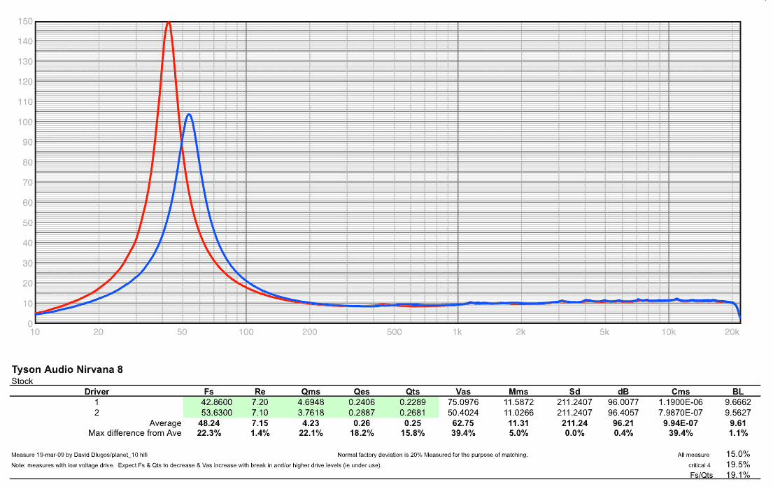

re: AN10 - how far off from spec? - look at the right hand column in this woofer tester screenshot
here's the numbers from that WT3 run - - I used a sealed box to get Vas as added mass method
seemed problematic with AN10
Re = 6.959 Fs= 95.94dB Qts= 0.4218 Qes = 0.4818 Qms = 3.384
Le = 0.1808 mH Mms = 20.93 g Vas = 3.498 cubic feet
http://img218.imageshack.us/img218/7884/an10vasin24cfboxsl2.gif

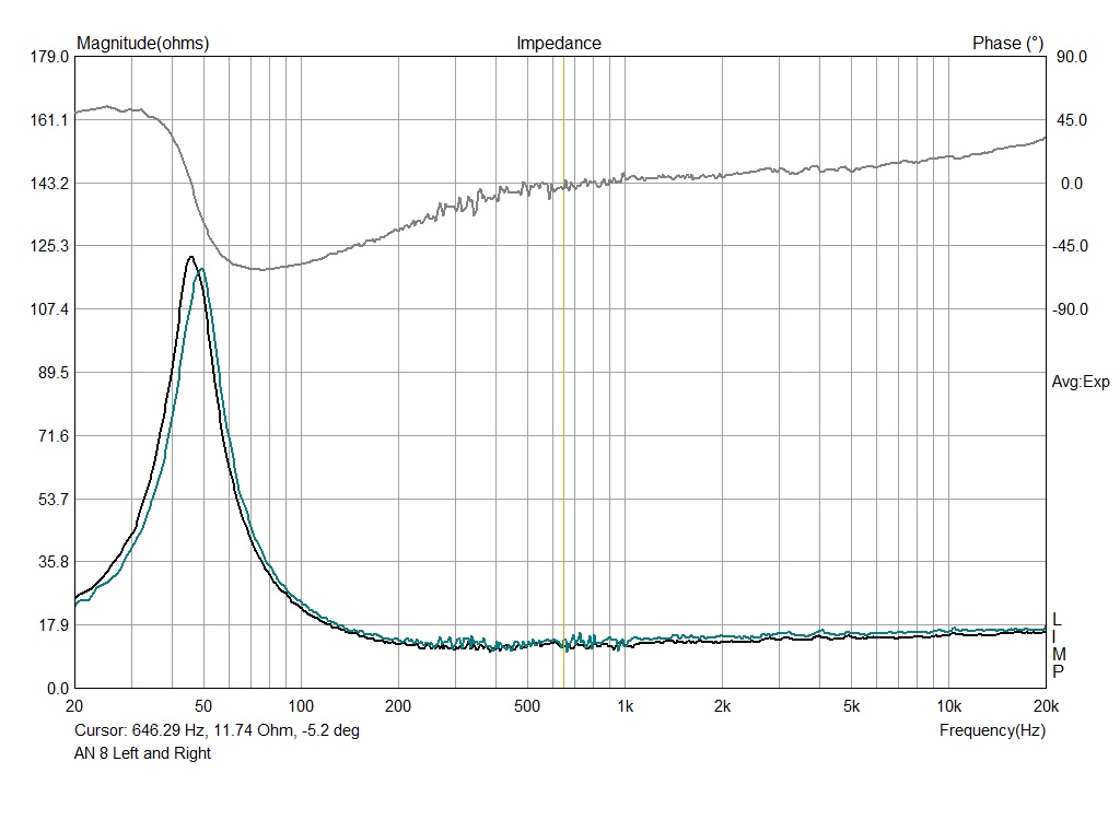

For the record, I used S&L's woofer tester to test the Super 6.5's and Super 3's. I used both the sealed box and added weight test methods for the VAS measurements. Guess what? I ended up with two different results. Is that CSA's or S&L's fault? No! There are way too many variables to overcome for consistent VAS measurements at the diy level. In other words the test results will vary from user to user. Short of doing the VAS test in a ANECHOIC CHAMBER and everyone using the same test equipment, good luck. On a positive note, the electrical measurements according to my S&L woofer tester were pretty much on the money with CSA's spec's.
Hope this helps🙂
