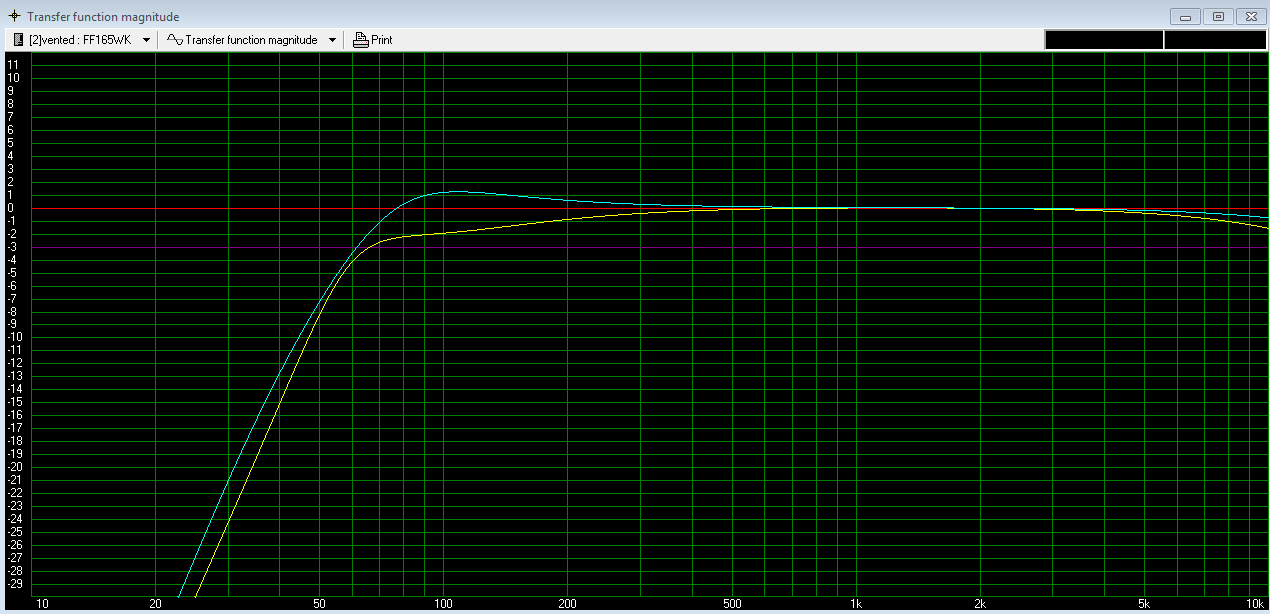

Same driver (an FF165wk if you're interested). I simply fooled with the T/S values slightly to give an idea of how the alignment & behaviour changes with a given vented box Vb & Fb. Speaking generally, huge problem? Depends on driver, circumstances, alignment et al. Audible? To paraphrase somebody else (Francis Urquhart), 'you decide. I couldn't possibly comment.'

To be sure, the room dominates below ~300Hz, & when relevant the amplifier output impedance has to be factored in. I'd still call that an unacceptably wide variation in alignment though.

True, but consider how much more impact the room has on a severely under-damped alignment if the specs indicate a small cab tuned high that instead should be in a large cab tuned low.
Another consideration is that how much the alignment 'rings' isn't affected by the room, only the cab alignment, so for 'FR' drivers this situation can be very audible up through the critical mids.
Bottom line, for folks that like their music 'colorful'/'rich', it's probably not a big deal, but for the rest of us, specs that vary this much are completely unacceptable.
