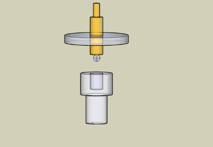

I have no problems contacting Vinyl Addict, and getting a qoute. I have solidified a local machinist, but yet to receive a quote.
I think I have what I believe to be an original design for the bearing, so no thoughts of intellectual property" issues. I also have another design in the wings that may proove to be at least as quiet and able to carry a "loaded" platter (if anyone wants to do that), and a bonus is theat it may be less expensive to have made.

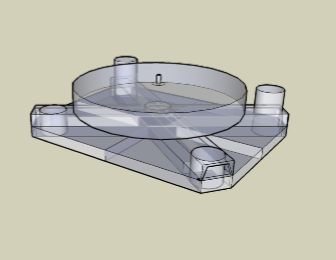

pushing the plinth design....
well, this is where individuality may come in.
I've drawn up a "Constructor" plinth, I beam IRON, allowed to rust in an appropriate manner welded into an "X", with the intersection of the "X" the strongest point and where I would put the main bearing if I were to build it. lots of clear acrylic so it would mimic many of the materials in "skyscrapers".I also like particularly "traditional" appearing turn tables, like the Roksan Xerses .
The turntables linked to are absolutely stunning. But it is almost like the more skeletal, the more common (consider how uncommon the original Oracle Delphi, Ja Michell, and the Transcriptors original looked when first intoduced) today.
If a Garrard style or Thorens style plinth similar to the Shindo Labs or Loricraft is desired, that's easy enough.
In no way am I thinking that there is a "universal plinth design" out there for everyone to make, or buy.

my thinking is to go with as much mass as possible using wood. in the end, I will probably go with something like the teres. The use of wood makes for a nice look and sound.

Re: sketchup of two turntables
Sounds like a recipe for an inverted bearing with no oil bath.
Jeff
Nanook said:I haven't settled on materials for the bearing, but most probably a sintered bronze bushing, ceramic or hardened steel ball, a thrust plate (teflon or hardened steel or polished unobtainium), with a brass body.
Jeff

I'm starting to think we might be building the camel of turntables (designed by committee)😀
It will be hard to satisfy so many people with one design specially since this is a do it yourself group. I think the best way to handle this is to offer what you have designed for yourself. If others want it then you get enough to make your group buy financially viable.
