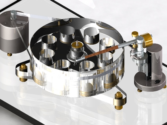

The large offset between platter hieght and arm mounting plane
could cause problems with arm mounting, looks somewhat awkward.

Please know that this is a unique design and not actively copied from anyone. However, there really only a few ways to skin a cat, if the design parameters are the same or similar. The bearing is unique, the platter is 315mm in diameter, the thickness is 43mm, the label area is .005" deep. Presently I have a 40mm bearing housing, using a 20mm bearing shaft, and a 1mm hardened steel thrust surface. I am thinking that a total length of the bearing/housing will need to be in excess of 60mm.
I agree the tonearm mounting has not been optimized, and that needs to be addressed. I am thinking that a rotating arm board, with a mounting collar and a height of say 1" or so should provide the required vertical offset, and provide enough room to mount a 12" arm if so desired. This could be placed in the existing mounting location or another one.
C of G calculations put it at 18mm down from the top of the platter. The distance between the bottom of the platter and top plinth (or only plinth if so desired) needs to be reduced by at least half. The prototype used an old bearing from an old discarded direct drive (after I threw out the original bearing, because it was absolutely terrible). I'd say that overall, the turntable is easily on par with my Oracle. Even with the bodged bearing the sound is very robust and very quiet. The motor has its own electronics, but I do not like the housing nor the "pillars", they simply are not required unless trying to appear like a Delphi or similar.

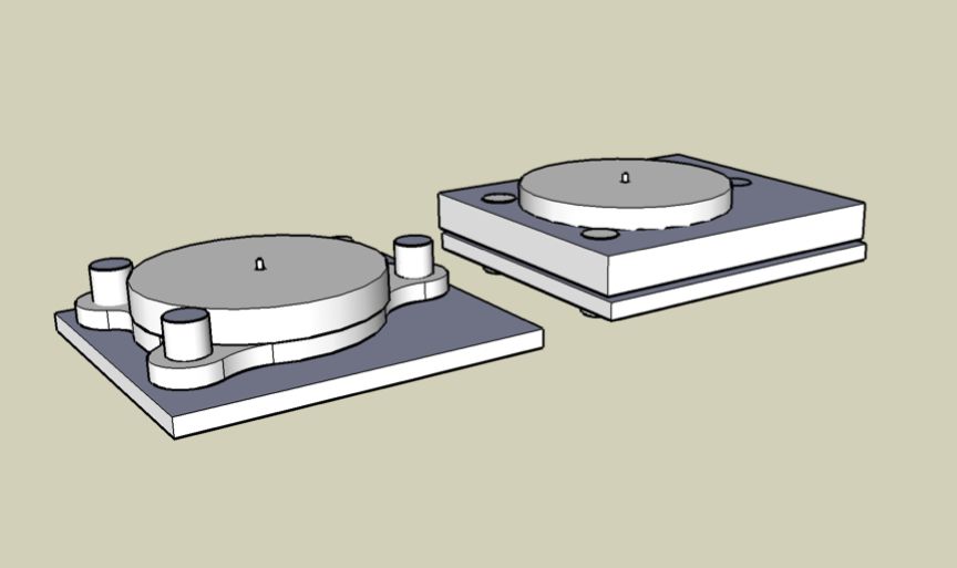

sketchup of two turntables
all,
please have a look at the image "two turntables". Only meant as an idea of finishing a table.
the bearing drawing is completed as are the two "plinth styles" and the platter
Obviously not everyone's taste, but typical of many tables out there.
enjoy. Now that the drawing is done, I'll work at getting the quotes together, or if existing parts are available for the bearing, a list of what might be needed (from McMaster & Carr or similar).
I haven't settled on materials for the bearing, but most probably a sintered bronze bushing, ceramic or hardened steel ball, a thrust plate (teflon or hardened steel or polished unobtainium), with a brass body.
So folks please stay tuned. Once I get in touch with those that can quote me, I'll post the results as soon as possible.

all,
