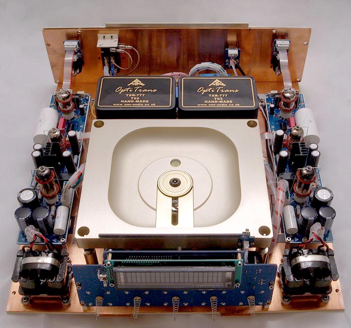

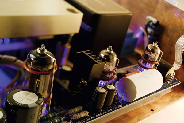

There are no IC's in the Analog Signal Path of the AMR CD-77.
Is Mr. Thorsten Loesch delusional?
Can there be a possible reason as to why he uses no IC's in the Analog Stage of the CD-77? ...I don't know.

Yet they were the preferred choice of the foremost authority on TDA1541 chip, when
deciding to create what according to MANY, is:
the best digital sound machine on the planet.
Do we still need to insist on using IC's?

any idea of the circuit?
Fast Audio review:
Fast Audio
Thomas Fast
Brählesgasse 21
70372 Stuttgart
www.fastaudio.com
View attachment Image%20HiFi%20Review%20AMR%20CD-77.pdf

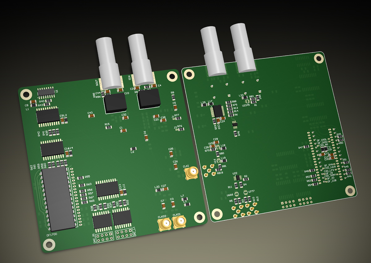

The digi interface PCB is 50% complete. SAA7220 dropped as it was counter-productive. It was a bad performing DF anyway.
No PS section yet 🙁
Wow, looks good dude!
Here I am drooling over tubes and you're actually getting some work done! Keep it up!

Yep, the PS pins arrangement of SAA7220 looks so 70's. Fortunately i've already dropped it. SAA7220 has 180mA(!!!!!!) supply current, what the heck?!. CXD is qouted for 100mA absolute maximum, when DF1700 is just 50mA...
Another reason of why people favor NOS desings over the "classic" 7220 🙂
The CXD1244 and DF1700 have much better PS pin locations - right next to each other, in the middle of the IC. As close as anyone could hope for.
I plan to throw paralel regulators all over the digital section as i don't want the currents from nasty logic ICs to flow all over the place. At least the DF and WM's PS. Other ICs shouldn't be so angry for the PS as they have no processing inside and don't need to charge much capacitance on their outputs.
That's the reason of separated digital PCB. Clock section is tad compromise, so i threw EXT connector to be able to override PCB's clock circuit with external one. Anyway, the onboard clock should be cased separately due to different EMC and thermal factors. I'll need to measure it one day, and i'm already getting ready for that: half-built software tool for displaying long FFTs in a manner the good old SSA do:

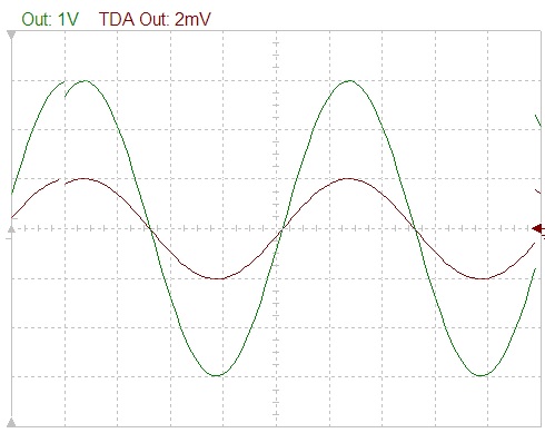

This is the simulation of the tube output stage I'm building for the TDA. Tube's models are generated from real curves extracted with a curve tracer. No IV resistor is needed. No feedback.
The green plot is the output signal of the stage, around 3V p-p.
The brown plot is the signal developed at the TDA's output, around 2mV p-p. So the DAC see 1 ohm impedance.
The simulated harmonic distorsion is less than 0.001%.
