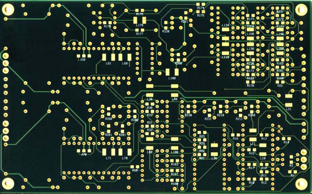

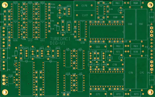

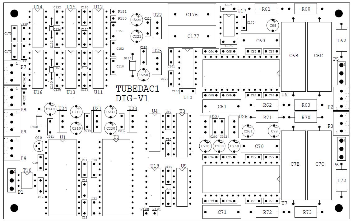

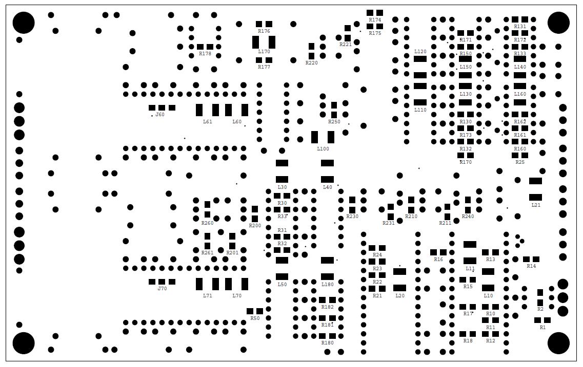

Hi all,
Yep, my 1541 project was abandoned one, due to different things i've stuck with:
1. To evaluate the design you have to listen to it. My amplifier is on the worse side, so i began to build a new one, here.
2. To make this board work, and be worth of investement, you need
- A good low phase-noise clock. To make it, you have to measure it, understand it, etc. Lots of RF + low 1/f noise things in single design, which takes a while to figure it out.
- A digital interface board. Including digital filter, and some sort of suncronizing music source with the DAC clock. I began to draw it here. Stuck with the demanding design, as
- I tried to make it fitting any old DACs
- I tried to make it possible to operate it without compatible back-syncing sources as regular SPDIF. That requires low-noise path of recovered SPDIF clock and everything.
Thus, the PCB should be low-noise, high-speed, low EMI, and have a plenty of logic elements and customization. Yep, there is CPLD too, which you have to program.
To ummarize - this PCB should be absolutely analog, RF, digitally allow 0Hz to 10s of MHz, with BW of 0.5GHz, everything clean, matched AND low impedance. When i tried to route it, i've figured out i either have to cross traces with other traces, or go 4-layer. As i have to implement three dimensions of traces - power, signal and control, all over the PCB. Given we need to make as much of signal integrity as possible, we get 4layers quickly.
- Outut stages (I/V converters + filters) should be placed on the same PCB as DAC, as you don't want the return currents of DAC signal to flow all over the place. They come from PS rails and decoupling of I/V converter. Yet we'd like some degree of experimentation, thus removable PCBs.
As of sharing.
- I'm not interested in selling PCBs as they require debugging skills to be implemented. Thus support. Thus headache. They aren't ready for use anyway, as newer been fully powered on.
- No release of gerbers for this time. I don't want to spawn "group buys" of any sort, nor the "do it for me" 3rd party services.
- The design files are of Altium, a pricey piece of magic software. No value of DIY community as it is way too pricey.
So, to summarize, you get what you see - unfinished schematics, layout, and hopefully by the end of the following week - part values used in actual working implementation (i'm powering the thing on right now, with all the debugging involved). For your inspiration.
Please notice, this is my 2nd PCB in my lifetime, the transistor footprints are reversed, i've got some mistakes of power calcutations (but they seem to be OK). Since the "completion" of the board i've learnt quite a lot of current flows when i designed the power amplifier, and EMI/EMC stuff when i've tried to understand all sorts of it...
The PCB needs rework. Most of it is fine, yet all of the connectors should be placed on single side of the board, the 4-channel DFF should be replaced with tinylogic of some sort, larger DFF footprint on DEM-clocker, and i have no idea what else, yet several cycles of design reviews will prove i'm wrong.
The Digi-interface board might be obsolete, as i'm currently thinking about more sophisticated implementation, either around bad-*** FPGA or with fast MCU to do all the async stuff, lifting out all the "low-noise" thing out of the board into separate clock PCBs...
Or make it dirt-simple - 44.1k clock only, single DF, single back-synced SPDIF or USB.
Once again: Hallelluyah.
As of sharing.
