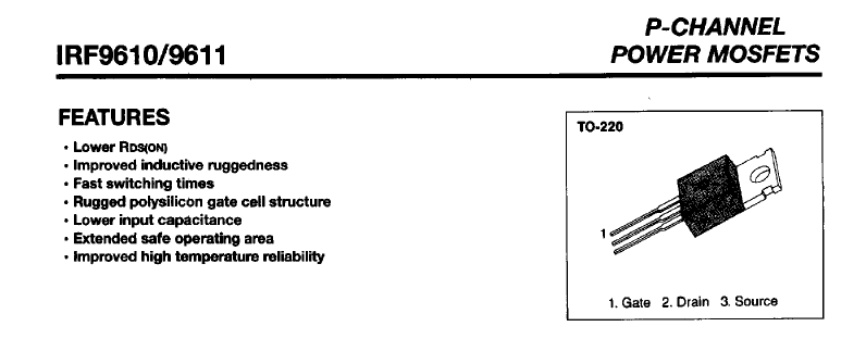

I have downloaded the datasheet for irf9610 from International Rectifier, but it doesn't show the pinout - just says it is a TO220AB package. As far as I can find out, this seems to have a pinout of G,D,S (looking from the front). Can anyone confirm this? I am drawing up a PCB and obviously need to get this right. I can post a jpg of the PCB if anyone is interested, or would like to give feedback on it.
This is from a Samsung Electronics datasheet.
Thanks - G,D,S it is.

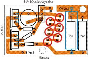

The first PCB will be for the 2 mosfets. My past experience tells me that mosfets tend to be quieter, or at least more benign-sounding than BJT's. (J-fets are my real preference - after valves of course)
This will not be an Eagle or other commercial effort. I am doing it in Coreldraw. I print it out on label paper, stick the paper on to the top side of the pcb sheet and use it for a drilling guide. Then I connect the drilled holes as required with a black felt-tip marker and etch the board. Primitive perhaps, but cheap and effective. (I have built up a library of parts at exact scale in Coreldraw over the last few months.)
If you print them out at the measurements shown next to the boards, they will be exactly to scale. All resistors are 1/4 w except those shown as 2w. There is an optional larger resistor instead of the parallel 2w's. It is shown in blue, but please note that since I did not have one to measure, I took a bit of a guess at the size of it.
Why MOSFETs? The obvious solution should be to go for a PJF or MOSFET at the top followed by a PNP.
Even if MOS are easier to handle they are not the obvious choice due to their extreme capacitances. This also shows as they give a more restricted bandwith than with BJT.

Did you think of space for sinking the lower part? There are voltage and current situations that it will need sinking.
In the first place, why make PCBs for a prototype? Even if it, as in this case, seems very promising. As Salas indicates listenning test should be done.

Forgot the capacitor! I feel really stupid now. Back to the drawing board. Of course, since there are so many different options for capacitors, the board will have to be MUCH bigger. Any other problems?

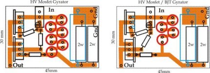

Revintage, if you look more closely, you will see that the board on the right is a for a Pmos + MJE350.
Heat-sinking for the 2-mosfet version , no problem, but since the BJT is turned around the other way, that board as it is would not allow for a heatsink.
Why a PCB for a prototype? Why not? I am tired of messing about with stripboard, and since I make the PCB's myself, there is no cost involved. Besides, I fully intend to use this design. I am convinced that it is better than a resistor or a CCS.
Sorry, didn t look close enough:clown: !
Also make enough room for the cap as it in some cases needs to be at least 22u, plastic type.
And if you are stuck to make the board for prototyping, make place for alternative MOSFET/BJT on the same card.
On the downside of this circuit is heavy phase-errors. Any suggestions Wavebourn? With 10mA 300V/150V IRF9610/MJE350 I get indications of over 20degrees at 20Hz.
First edit - added place for 10mm 'lytic with 5mm leg spacing. Also added 2 mounting holes. By stretching the board slightly to the left, another can be added top left, or a heatsink can support the left side of the board. Serious redesigning will be required for plastic caps, or they will have to be mounted next to the board and connected with wires.
Any other comments before I redo the BJT version?
