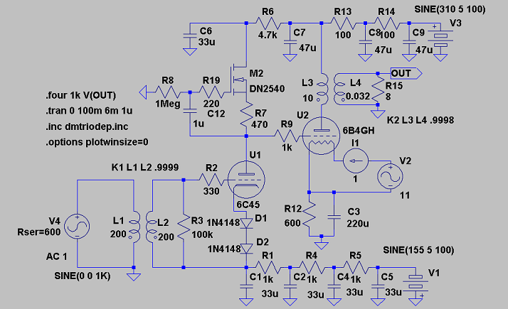

MJK, do you have any ideas of what value the two "source" resistors in the triode-antitriode configuration ideally should be? Reread the thread and found you presented the constantvoltage version already at page one:clown:.
My main concern is if the internal caps of the DN2540 really shows up on the sims? I use the Supertex Spice model.

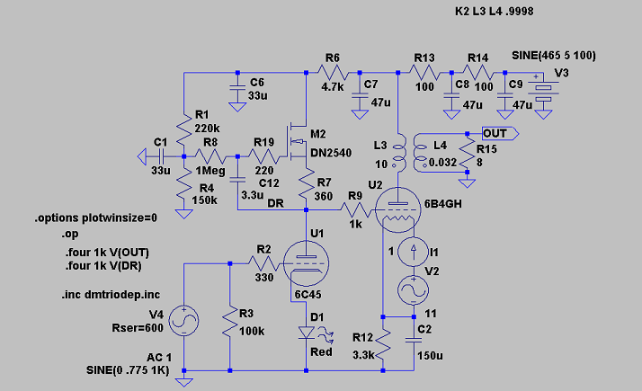

Remade the the tests at 1kohm load. Not so much more impressing with the triode anti-triode, even if it was slightly better.

I'm going to order PCBs for 2 types of gyrators: like mine from a mic preamp (cascoded), but more flexible, for adjustable voltage drop and different power dissipations (like to load 6V6), and one with 1-FET like Michael suggested.
The price per PCB will highly depend on the number of them I order.

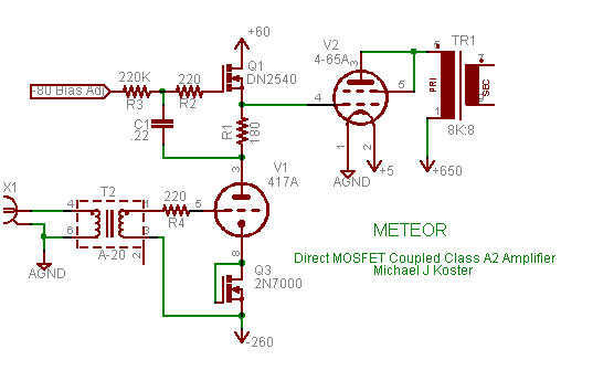

revintage said:
This is an idea of a DC-coupled SE with gyrator-loaded driver.
Instead of DN2540, 2SK216 could be used. IRF610 is not recommended due to its high capacitance.
Excellent!
If you use Mu-follower mode, you can drive some grid current,
as in this amp I'm currently breadboarding (simplified schematic...)
Michael

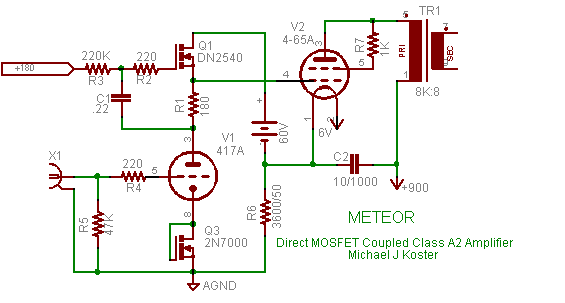

Simple, w/o input transfomer and negative rail. R12 dissipates over 12W though.
Michael,
Your amp is not far from the 813 SE circuit I have been working on. Can not decide wheter going PP or SE. However, I will not go A2 so I skip the sand-follower. Guess 4-65A could be looked upon as 813s little brother. Found Slagles 4-65 triode curves at AA.
Class A2 Hybrid Monkey
But if you did want A2 operation, using MOSFET drive allows you to
implement a class A2 Hybrid Monkey.
I'm thinking about trying single supply operation as well, by using a
floating supply for the grid drive returned to the cathode. All the grid
current thus stays in the local loop and doesn't affect voltage across
R6.
I'm using Slagle's curves also. I think the 4-65A looks pretty linear
but you need A2 to get good efficiency with these.
I also want to try anode-anode feedback in pentode mode using
a D3A pentode driver, but that's another story.
Michael

Hi Ken,
I'm guessing that you're referring to the 2N7000 in the cathode
branch of the driver circuit.
I have it arranged as a constant voltage device, with the gate wired to
the drain. I have found this to be a stable self-bias method that
drops 2.7 V at 20mA and has a dynamic resistance of about 7 ohms.
It's dead quiet also.
I really need 3 volts so will probably add a schottky diode as well.
I also left off the gate protection zeners, etc. to simplify the concept.
Michael
PS I thought of an advantage in using an enhancement mode FET
instead of a depletion mode device; you only need a single zener
diode for Vgs protection as opposed to back-to-back.

MOSFET source, MOSFET gate, and and FET hopefully follow the Triode's plate.
We should never see the FET's RC constant. But one might still see FET Miller if
the MOSFET above tracks poorly due to its own Miller... Then this error drives
from FET source back into MOSFET gate to slightly compound itself.
We have FET gate cap driven by 8.2uF in series with 1K and plate resistance,
but corner frequency is not so clearly related because of all the bootstrappage
goin' on. We don't really know what gate cap dynamically is? Or maybe I don't
understand the question?
I'm not offering easy answer, just sayin' I do see why this might be confusificatin.
My head hurts just looking at it! Sim should be accurate so long as the MOSFET
drain holds 10 or more volts in reserve to keep the channel shape from changing.
If the channel shape relaxes too much, the Miller cap becomes big like the gate
to source, we don't want that...
