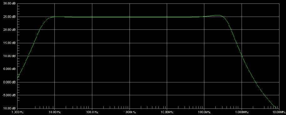

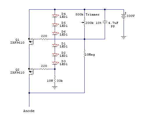

6V6, 10Meg, 220k and 4.7u will give you a 5Hz cutoff with bypassed cathode resistor. With an unbypassed R you might need to double the cap value.

IRF9610 seem OK. Even if my initial big cap was OK, I would prefer the 10Meg 4.7u option because of possibility for film cap. Does the 10X original resistor gives problems with noise rise?
Salas said:Does the 10X original resistor gives problems with noise rise?
No, it is shunted on AC.
10mA might be a tad much through the LEDs. I usually go for ca 5mA.
Also noted the two bypass caps interact so check this. Maybe Wavebourn can shade some light on this?
I always use around 10mA, they work OK. I remember SY recommending around 10mA if memory serves correctly. If someone wants to relax that at about 5.7mA, we must notice that the alternative is a 56K 5W resistor (1.8W dissipation with example B+).

Was looking at IRF9610 this afternoon. It looks like a pretty high speed device. Won't it have an increased possibility of instability? Will 220r gate stoppers be sufficient?
There wouldn't be any unwanted interaction with this circuit if I use LED biasing on the cathode, would there? (currently designing for 5687, and soon for 6n6p. DHT to follow, possibly1j6g)
Salas, you said way back in the thread "It is not like changing points by varying a CCS. B+ choice is the key so to hit the bias you look for."
Could you (or someone else who understands this circuit) please explain a bit more clearly? Eg, when you adjust the trimpot, what will actually happen to the voltage and the current?
Originally, you said the circuit would hold the anode at about 1/2 B+, but a number of changes to it since then will no doubt have changed that. Is voltage drop proportional to the voltage divider formed by 10meg and trimpot?

Set anode voltage by a trimpot, and current by a cathode resistor. Instead of a bottom MOSFET you may use a PNP BJT. I don't understand why you want to run a LED biasing current through cathode resistor.
Edit: sorry, I misunderstood about LED cathode biasing. Yes, it is fine to bias cathode by LED in terms of it's low dynamic resistance, but for longer tube life resistor shunted by a cap is preferable. Your choice.

For IRF9610 I don't know yet, my tests were done with IRFP9240 which were pretty happy with 220R. I guess you can start with 1k to be on the safe side.
For the other questions, Wavebourn covered. Respect to Anatoly, its his idea, I only did it with cascoded Mosfets.

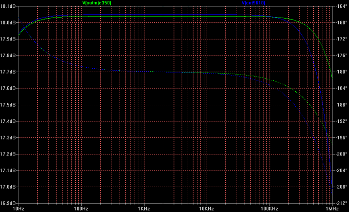

I simmed with a MJE350 at the bottom and, as suspected, get indications of better bandwith.
Another option could be to also use a P JFET at the top. Doesn´t change bandwith though.
I don't know if anyone here has had a close look at the datasheet for IRF9610. While the capacitance is a lot less than 9240, there is quite a steep curve to it (all 3 capacitances), which only really flattens out at about -25v. I would think that, unless the device has about 30v across it, the modulation of the anode's sinusoidal output would cause extra 2nd harmonic distortion in the mosfet. Perhaps BJT's (particularly in the "lower" position would be a good idea for this reason also.

hihopes said:I don't know if anyone here has had a close look at the datasheet for IRF9610. While the capacitance is a lot less than 9240, there is quite a steep curve to it (all 3 capacitances), which only really flattens out at about -25v. I would think that, unless the device has about 30v across it, the modulation of the anode's sinusoidal output would cause extra 2nd harmonic distortion in the mosfet. Perhaps BJT's (particularly in the "lower" position would be a good idea for this reason also.
I just used IRFP9240 since it was handy, despite its limited bandwidth due to higher Ciss. At least it did not oscillate. Lars has seen more in to it and said that 9610 simulates a lot better. Maybe he can help more with your question if had run Fourier for both Mosfets too.

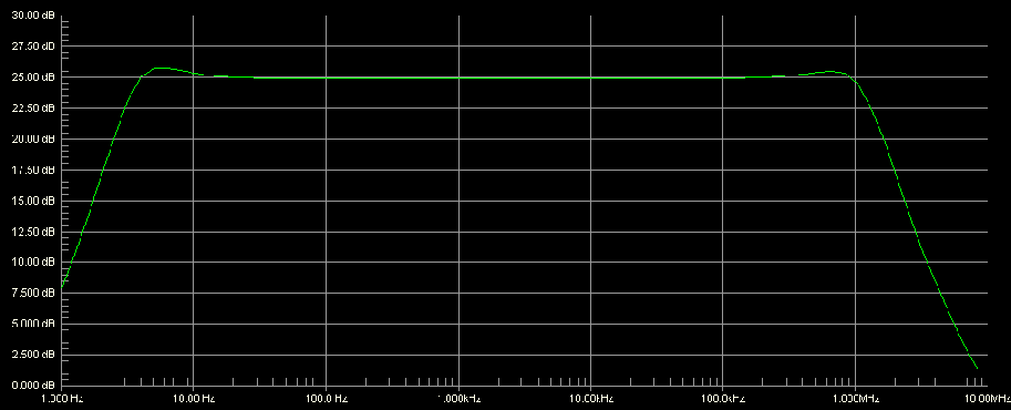

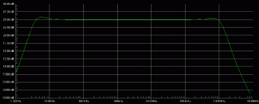

Simulated bandwidth with 9240 and 12AU7.
