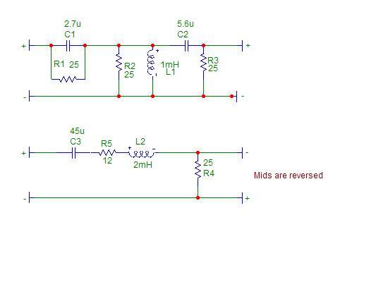

GM said:FWIW, here's the XO that I saved as being the original, but have no proof otherwise, so Nick, TD or an owner would have to confirm/refute:
GM
That's the one I got for use with the TAD 2001. It was one of Nick's last sets, so I assume it was the latest at that time. Actually looks like my figure (done in Microcap demo version)

Patrick Bateman said:I was too impatient, so answered my own question LOL
The crossover on your page and the crossover on moosebog ARE different. This is intriguing, as I used the crossover from moosebog as the basis of the crossover in my Unity project from 2006.
Basically I tried to do my own crossover, and it was a bit of a disaster. Just couldn't get good results. Then i took the crossover from moosebog, modeled it in Speaker Workshop with *my* drivers, and started tweaking the response until it looked good.
I'd post my crossover, but it's on my other laptop.
Long story short, here's Tom's *new* crossover:
Here's the one from Moosebog. I don't know the origin of this. I found it on the bass list eight years ago.
Those are 2 different crossovers for 2 different tweeters as marked. Top one is for the B&C and lower is for the TAD2001. The TAD2001 did not seem to change response with the corner fill we did while the B&C was very sensitive to it we learned.

The crossover you show is for the TAD, not the B&C which is what the crossover I use is for. There were another few versions for the B&C and Radian, too. They are all quite different. The TAD crossover has not been changed at any time. The horn related response problems were only seen in the B&C crossovers. The TAD has a much longer throat and was not effected.

The problems with Tom's crossover not matching the slightly different horn profile that Nick was providing has been rectified. Many owners of these horns have been in contact with me and I've shown them what is required to get the most out of this version of the Unity horn. The fix was made available and the problem resolved in 2002. No point rehashing it now.
BTW I have measured several versions of the Unity crossover in my Unity Horns and there was a very real on axis discontinuity at 4KHz with the first version. My current crossover (see hand drawn crossover posted above) is dead flat through that region (see plots on my homepage).

Wayne Parham said:Maybe someone could make a measurement using the old crossover and another with the new. Compare the two to see if the notch disappears. Hopefully, that's the case. If not, then maybe it is a reflection and the foam (like Geddes HOM foam) solves the problem. Either way, I suppose it's probably good information to know for DIY'ers making Unity-style horns.
From what I remember it was in the raw tweeter response coming from the midbass holes. I don't remember it being there in my tweeter only versions of the horn. Tom did state that foam on the outer lip of the horn lowered it a bit. The notch was only found directly on axis.
