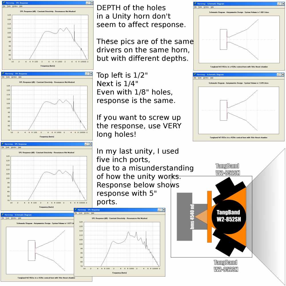

Also, if anyone is following this unity horn thread, it's basically moved over there. When I started this project I couldn't decide if it was going in my car or my house, but I bought a pair of Summas in the meantime, and that basically sealed the deal.
This is definitely a car project now.

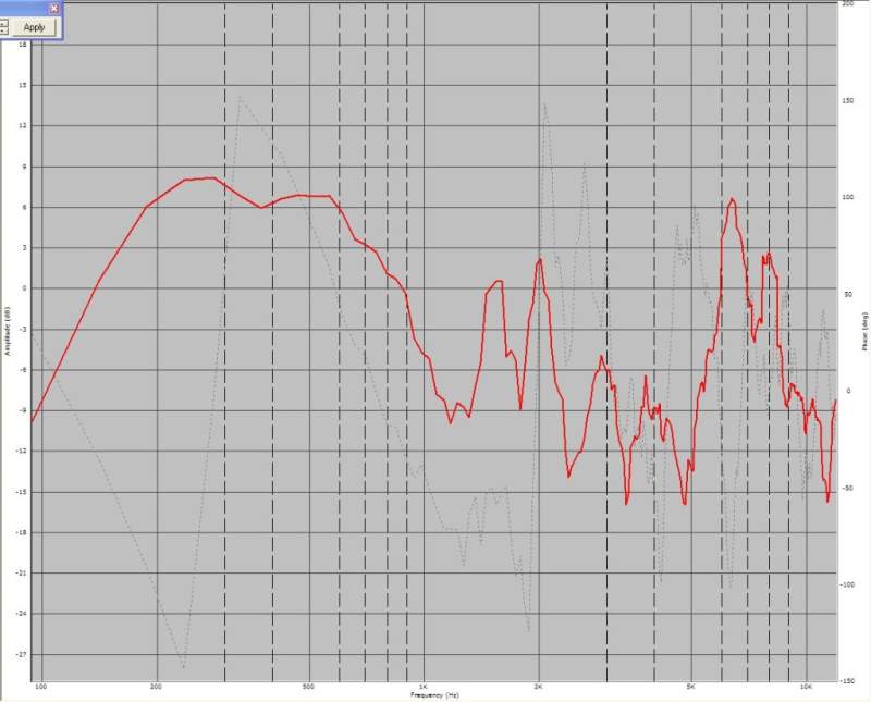

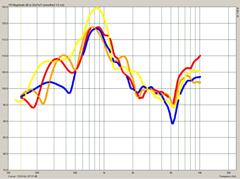

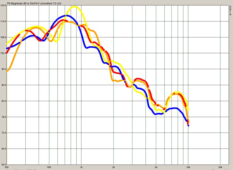

Hey Tom,
I did some polar measurements of a "unity clone" using a Geddes style oblate spheroidal curve. The measurements are almost freakishly good. I was shocked!
Here's a pic of the polar response of the midranges mounted to a 72 degree x 108 degree elliptical OS waveguide. This is with no crossover, and no EQ. Note the response doesn't waver a bit, all the way down to 200hz. Even in the high frequencies, there's no weird humps on or off axis.
Compare that to this measurement, which uses the same midranges, on a waveguide of comparable size. This waveguide uses a different curve, it's not OS.
You'll note that it's only maintains directivity for an octave and a half, and in the rest of the range the beamwidth varies dramatically. In the upper frequencies the beamwidth widens, and in the lower frequencies it narrows.
Here's the kicker. Both waveguides are about 12" x 6" wide, and they were measured in my car. Looks like the OS is able to "mate" with the dash, but the other curve doesn't.

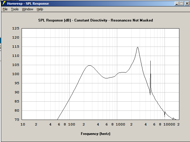

Hi Patric
I have a idea to make a synergy horn who can go together with a tapped horn who is ready to build now.
I have 4 visaton wsp26 s bass 10 inch, and it work very well IF I am right.
Do you now a good learncourse about this horns? I am amp man, but want also learn some about horns.
I have seen that finding a back closed mid loudspeaker is not easy, I have then get a open one and make a little enclosure behind the mid as replacement for the closed one,
the viston mid who was closed has high qts because of the small enclosure formed.
I did see that for bas there are two holes per speaker but one hole is open to the back is this needed for use the back energy of the woofer?.
thanks
kees
