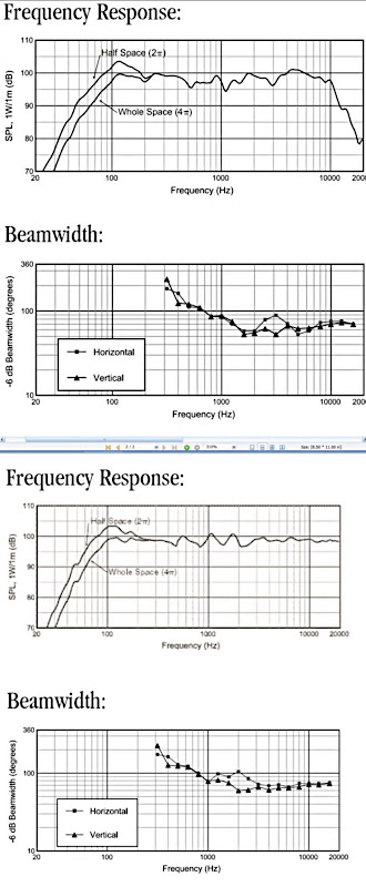

Yesterday I was suprised to find that JBL is now using a BMS ring radiator in the newest version of their M-Pro line. This gives us an opportunity to compare the response of a BMS compression driver and a conventional compression driver on the same waveguide.
This is because the predecessor to the MP 415 used a conventional compression driver, which has now been replaced with a ring radiator. The baffle is the same, and both designs use a 15in woofer. The BMS is crossed over a bit lower, at 1.5khz. (The old design used a 1.7khz xover.)
The crossover, schematics, dimensions etc are all available from JBL. The woofer is $179 and the compression driver is $140. The waveguide isn't for sale
The top pic is the conventional compression driver; the bottom pic is using a BMS.*
* See this thread for an explanation of JBL's relationship to BMS:
http://www.audioheritage.org/vbulletin/showthread.php?t=6368&page=7
