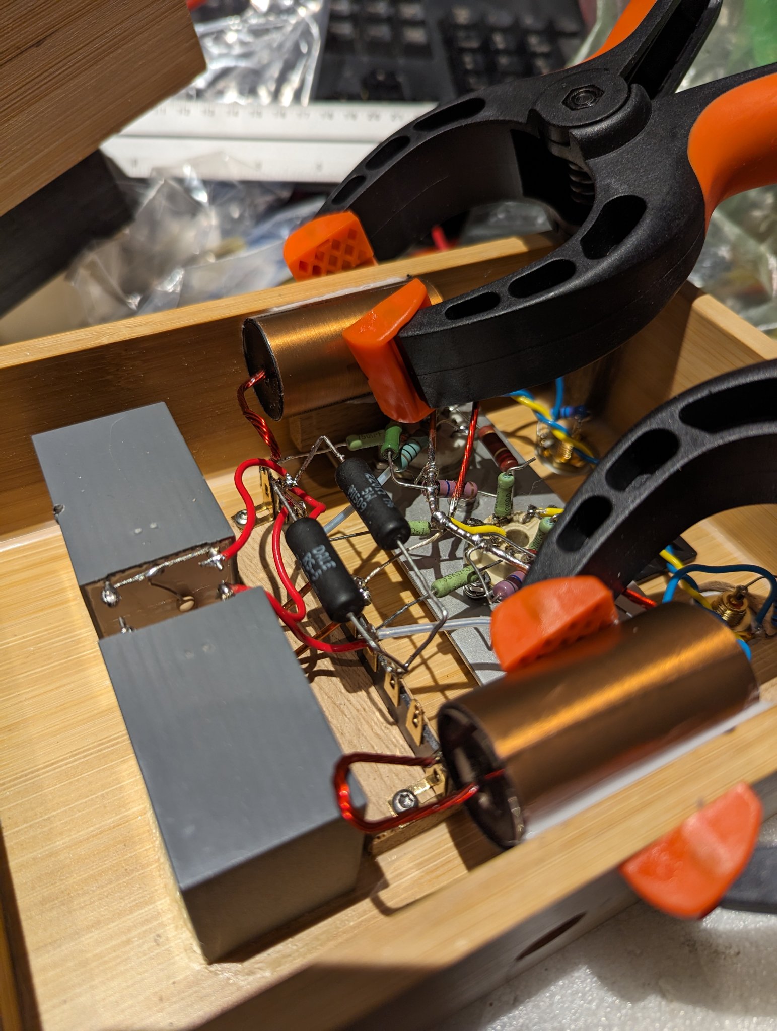

375 Ohm.
So about 15Vdc across DCR assuming 40mA.
Implying somethings not pulling current.....are your el84s at heater voltage and current spec?
Indeed. Something (EL84's) are not pulling current.
Will check the voltage. The transformer supplies 4A or should supply..are your el84s at heater voltage and current spec?

The heater supply loaded with all the tubes in is 6,7VAC (a little too high). Unloaded above 7VAC.
Hi Bas!
So with the black probe at ground you measure 20V at the cathode, 0V at the grid, about 300V at the plate, how much at G2?
The cathode resistor is still 130R?

Wait, wait, wait, measured from where? Is there both a "fixed" bias to the grids and a cathode resistor bias? I've missed something since the posted schematic.Cathode 1.8V
Grid pin 2 is at -20v
Cathode resistor 150R

There is no fixed bias. But I measured with black probe on ground. Red probe on grid. (Never measured it before) And my multimeter said -19v.
Whoa! Something is not as we suspected. Not being on-site, I can't immediately guess, but do expect the grids to be very, very close to zero VDC, and since they're not, must wonder about the cause. Both channels the same, so not likely a parts failure, etc. so maybe a wiring issue?
What wiring mistake could cause an issue like this? Maybe look first at the path from the "bottom" of the grid leak resistors to signal "ground", then from that "ground" to the rest of the signal "grounds". Sorry, not smart enough to imagine it, but the issue is definitely in the wiring, so conceptually "easy".
Maybe another of your beautiful photos, showing that wiring, might help an outside observer, if you haven't already discovered it.

Aha..Ok...did not know this...since I always thought a grid should be negative something.but do expect the grids to be very, very close to zero VDC

The voltage between cathode and grid is what the tube 'sees', the (voltage across the) cathode resistor is generally setting up the (usually) 0V grid to be below cathode voltage.thought a grid should be negative something
They both have the wrong current. 11mA and 12mA respectively.that has correct current to the one that doesn't have
This is a lovely simple circuit, and as none of the voltages/currents seem correct, I would disconnect the power, drain the caps, remove the tubes, and get a print out of schematic + tube bases, and carefully use the ohm-meter to check the wires and resistors in the schematic are correctly connected to all the places you think they should be.

Hi Bas, where are the 680k grid leak resistors for the EL84? I am seeing the connection from the cap to the 750R grid stopper, the 680k grid leak should go from that point to ground?And even more glueing. View attachment 1260659
They were not in at that time.
Yes indeed. That's something I forgot. No sound from the amp. And then I soldered in 680k. Currently 470k since I thought that could be an issue.the 680k grid leak should go from that point to ground?
