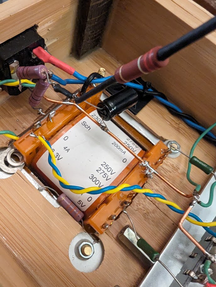

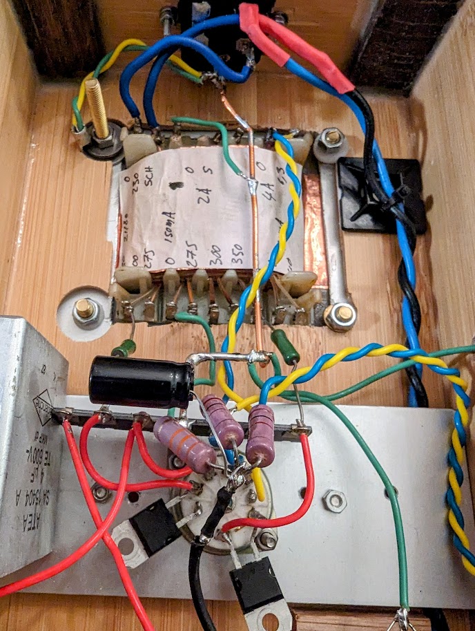

Thans Eduard,
I did the transformer swap last night. I first measured the other transformer to see if it was not perhaps mislabeled. Turns out the label was correct.
Old:
New:
After this picture I added to 33k/10Watt resistors in parallel after the choke to always draw some current as Eduard suggested. And as is customary.
New:

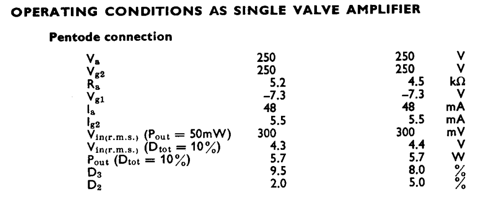

But here is the next issue. For some reason each el84 draws only around 20mA. I just ripped the 6P14p-ev out the box...so I'll try some others. The Russian EL84's are from the mid 80's which apparently was not a good vintage.

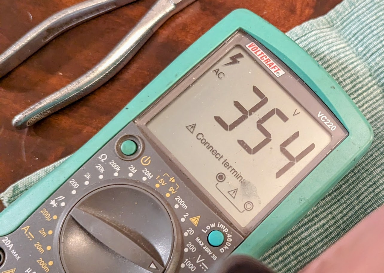

The resistors have a 700VDC voltage rating. And are ofcourse across the first cap after the choke. Voltage is around 300VDC. And goes up slowly and surely.

How strange your readings compared to #78....which were close to the mullard pdf values.

Post 78# = 30mA on one el84. 36mA.
