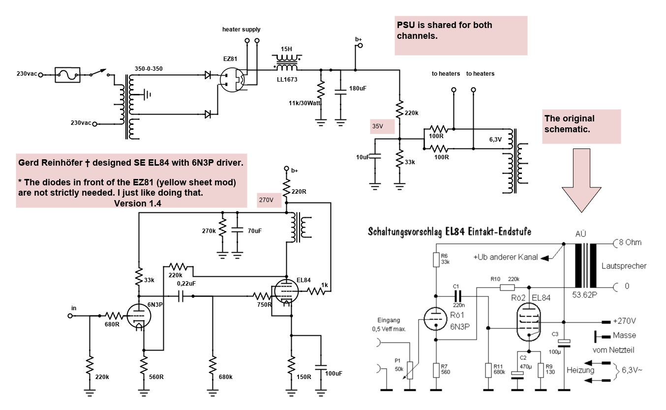

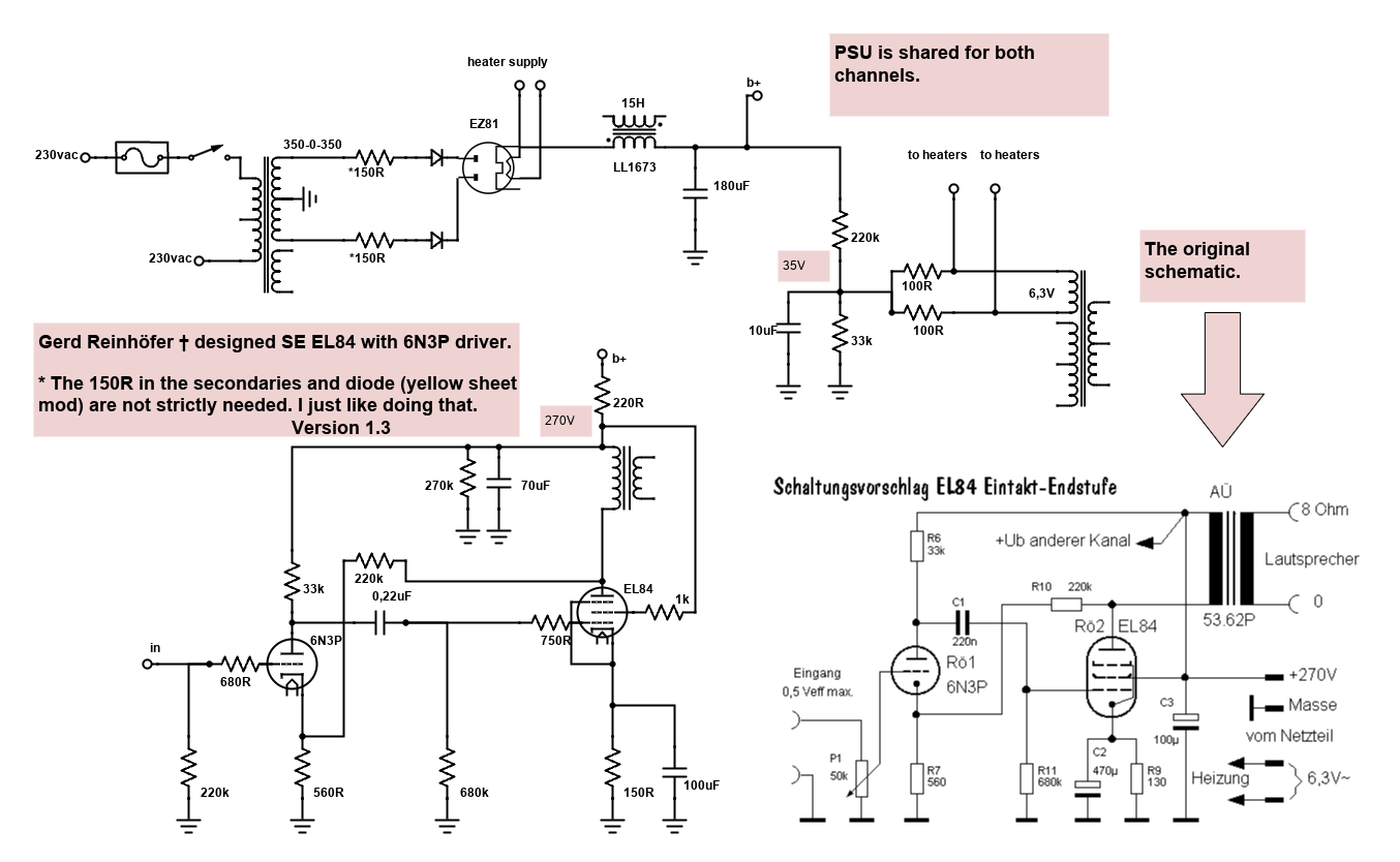

Another SE EL84. Following this schematic. Grid stoppers yay or nay?

Hello Bas,
With choke input you can create a supply with lower dcr and the 150 ohm there for are not needed. They could make things worse.
Where is the bleeder resistor?
I think 180 as first cap even after a choke is to big.
Why is the B+ from that cap not going directly into the primary of the output transformer. What is the function of the 220 ohm. Feedback.?
Greetings,Eduard

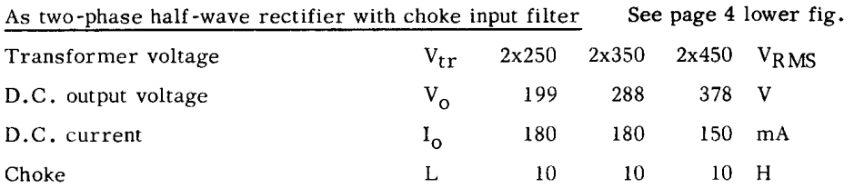

"With choke input you can create a supply with lower dcr and the 150 ohm there for are not needed. They could make things worse."
As per eduard so too the data sheet.
Hello,
The solid state diodes can also have a negative impact on the sound.

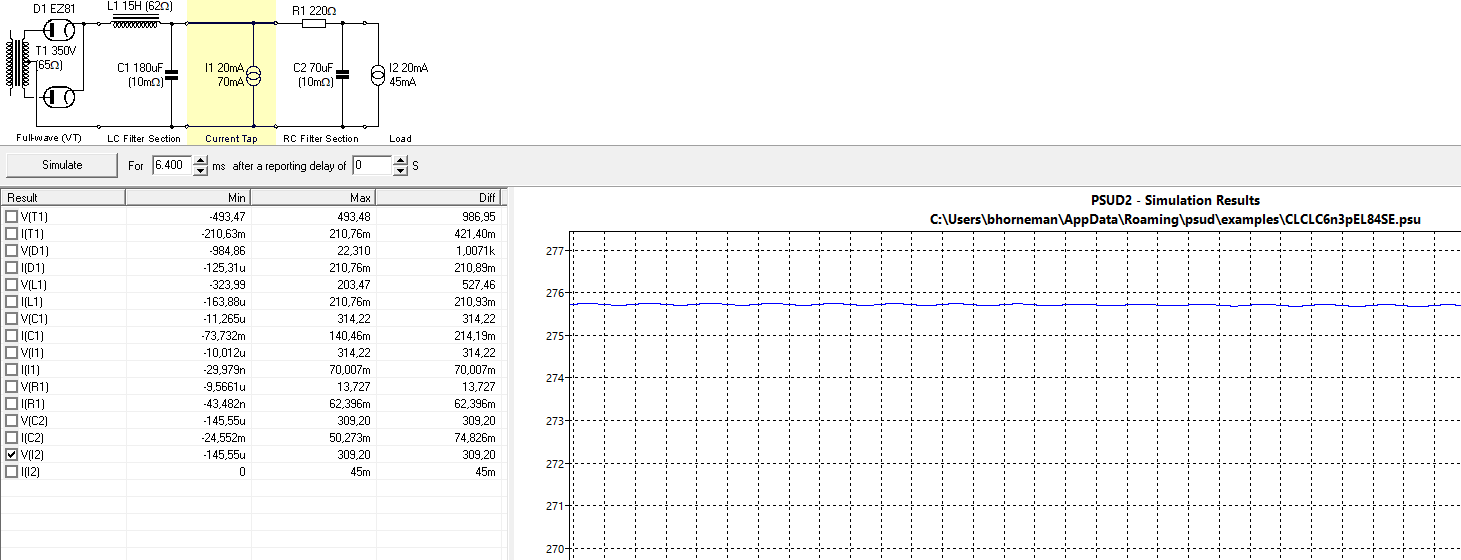

Did you calculate the TC as shown in the French publication?
It could be that switching the first and the second cap will give better results.
Because the cap is far away it looks like there is no cap and just the 220 ohm.
Sound still improving?
Greetings,Eduard
