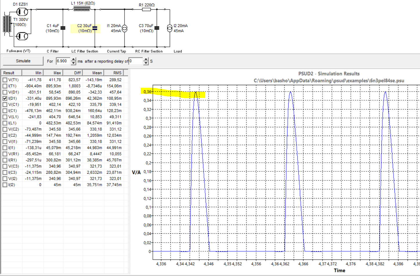

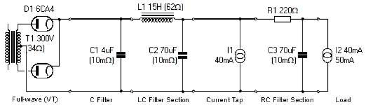

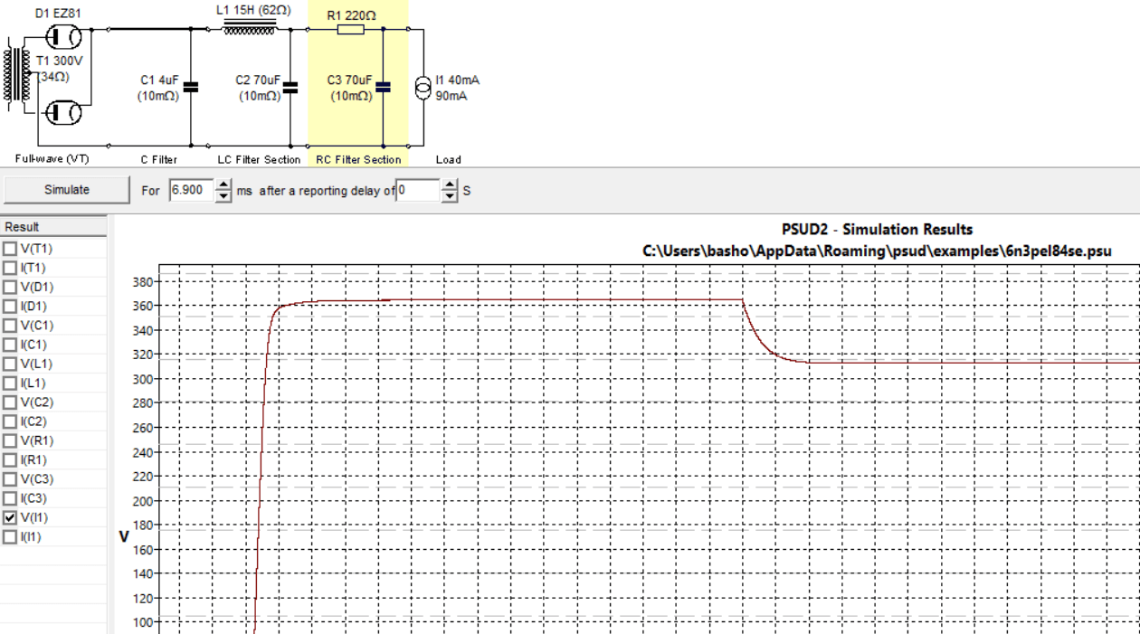

Yes. But now that you mention it. Not with the EZ81 yet. Sims were done with the 5UG.Have you simulated the power supply in Duncan.
Quickly did sim with EZ81 and real life dcr of one leg as suggested by jcalvarez

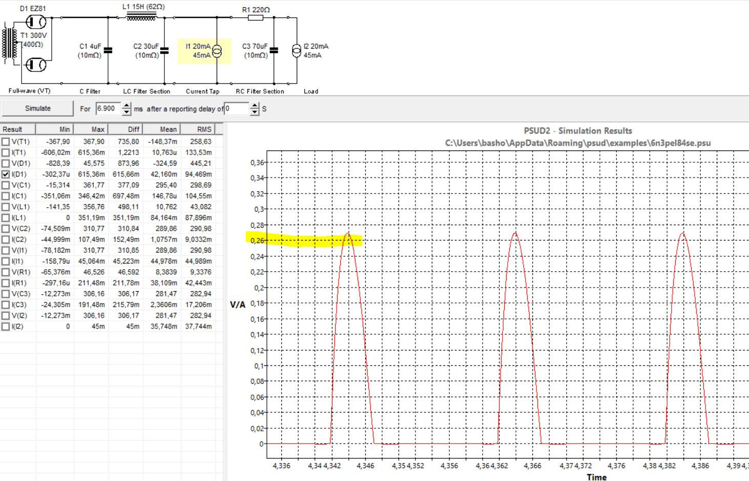

Since you said you will split the power supply with 220ohm feeding each channel, you can include the effects of the second channel by inserting a current tap where it will split off. Then just sim for the final current of one channel at the end of the schematic. It keeps it a bit more accurate it seems to me.
John
John
Thank John! Will do. Since I split the driver tube too. (In earlier pic I had them joined, but made em separate later) I'll make em 45mA each (ballpark)
I've been working on a couple of amp designs that use a split dual mono type of power supply such as yours and I found the option of adding the current tap in the middle. Before that I was halving the series resistance or inductance and doubling the final cap values to simulate the two section in parallel. I like the current tap better.

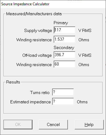

To make the transformer sim even better, click the ellipsis button next to the ohms field and then you can use some actual measured values of resistance and offload voltages for the transformer. It should increase the accuracy of the simulated voltages. Since I don't know the actual resistance and voltage numbers for your transformer I couldn't put them in these examples.

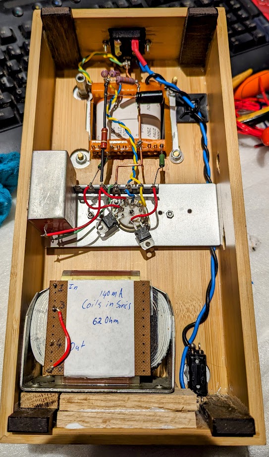

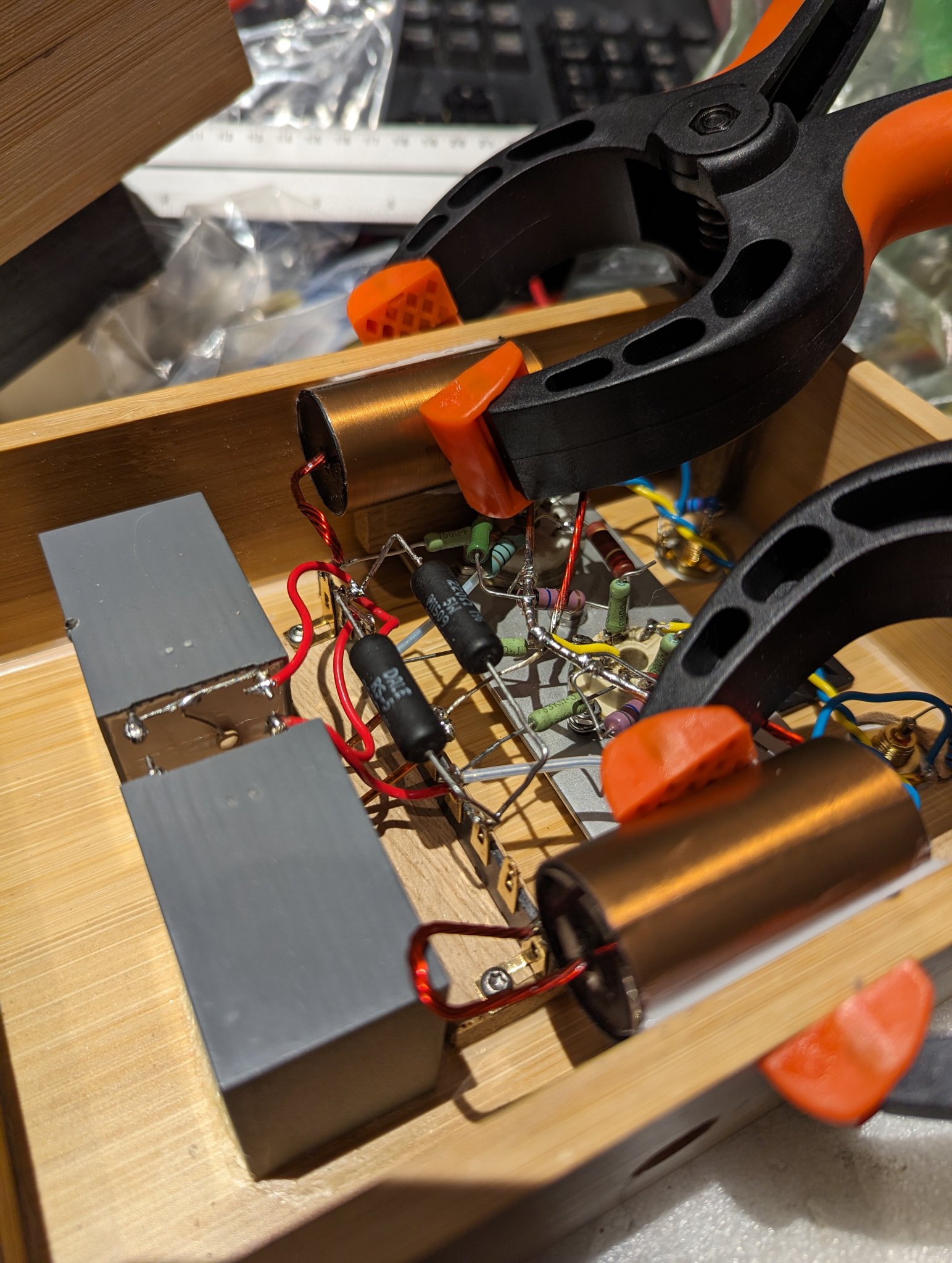

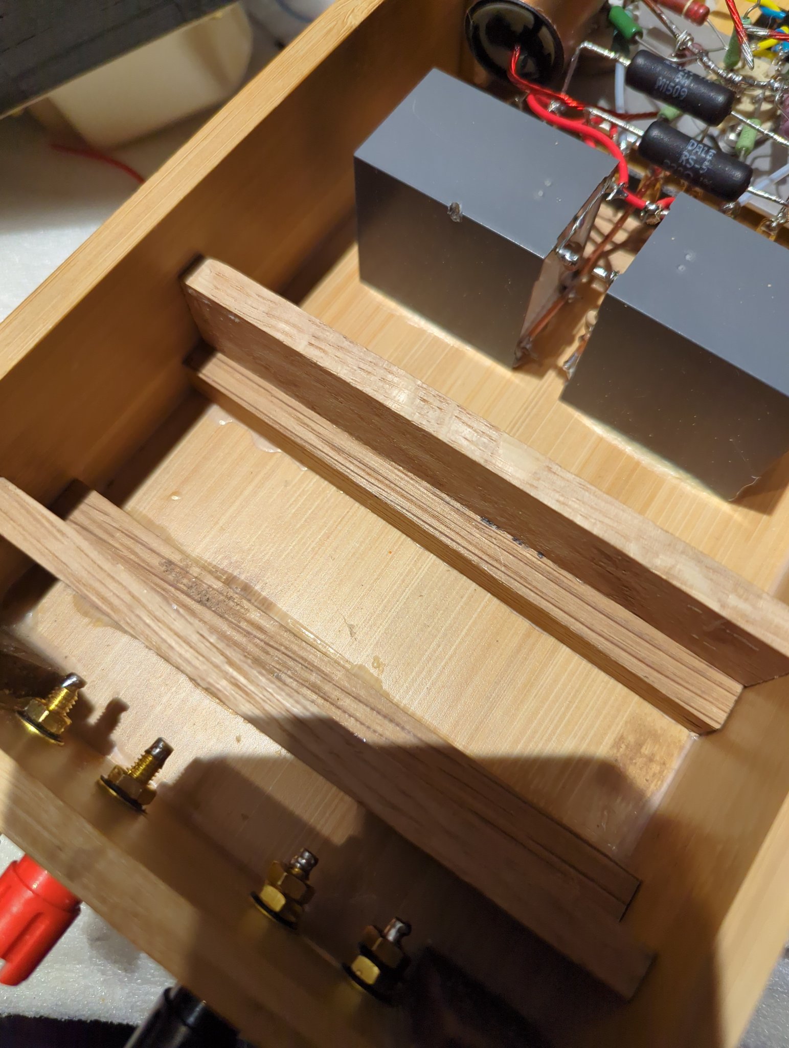

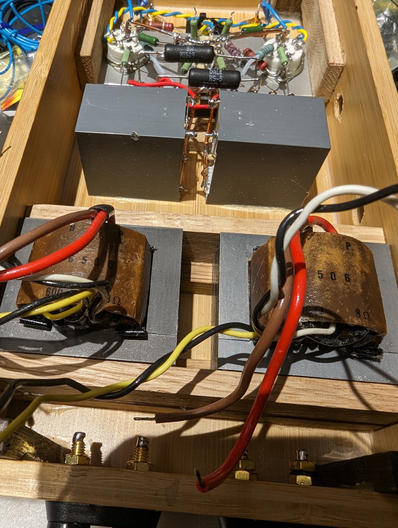

Silicone. For the choke and caps. Wood glue for the wooden 'planks' to make a little bed for the output transformers.What kinda glue?

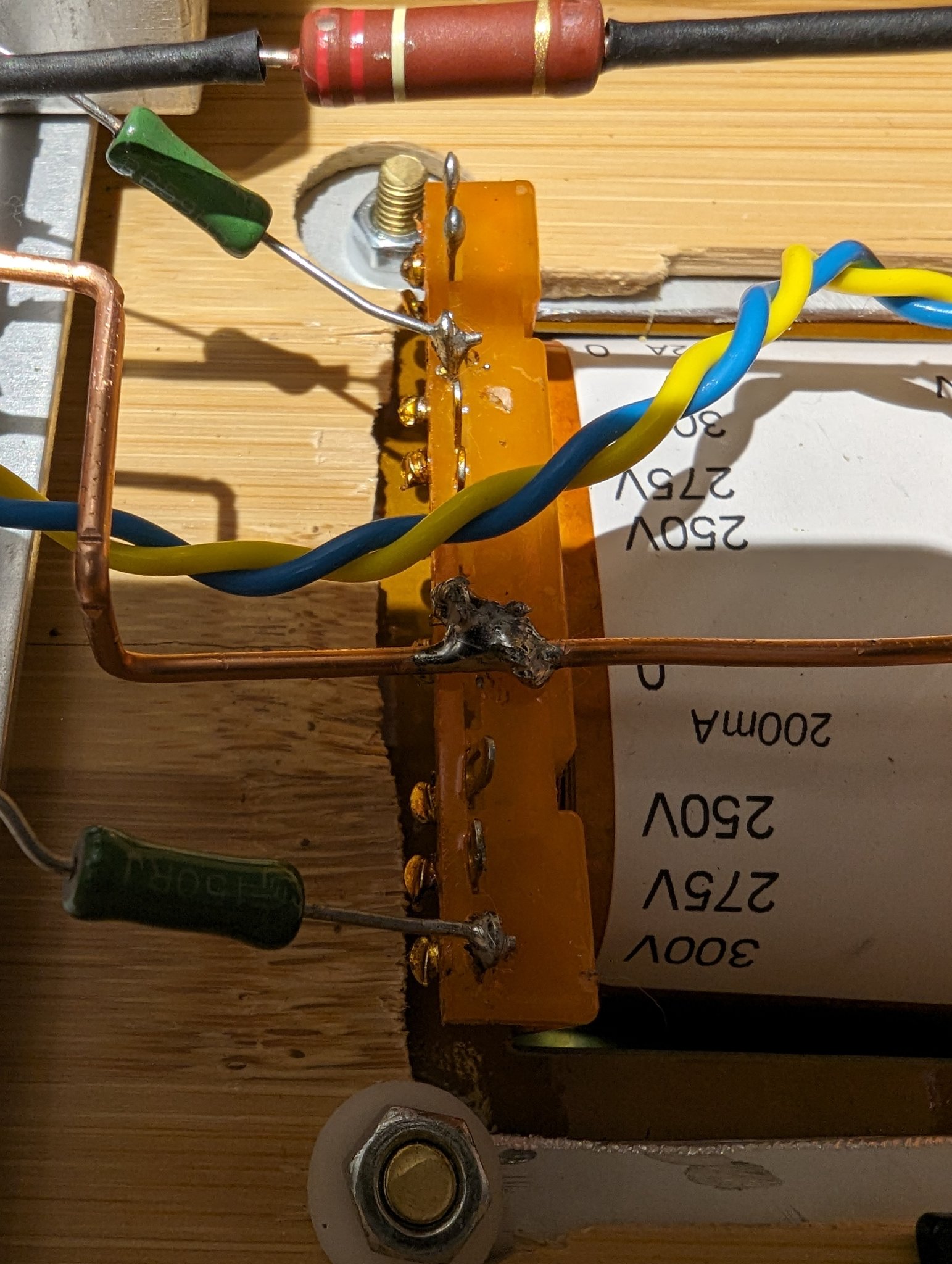

Wrapped bare multistrand silver coated copper wire through the eyelet of 0 and around the bus. So the ground bus and 0 of the transformer will forever be joined. 😊Don't forget to ground the secondary.
