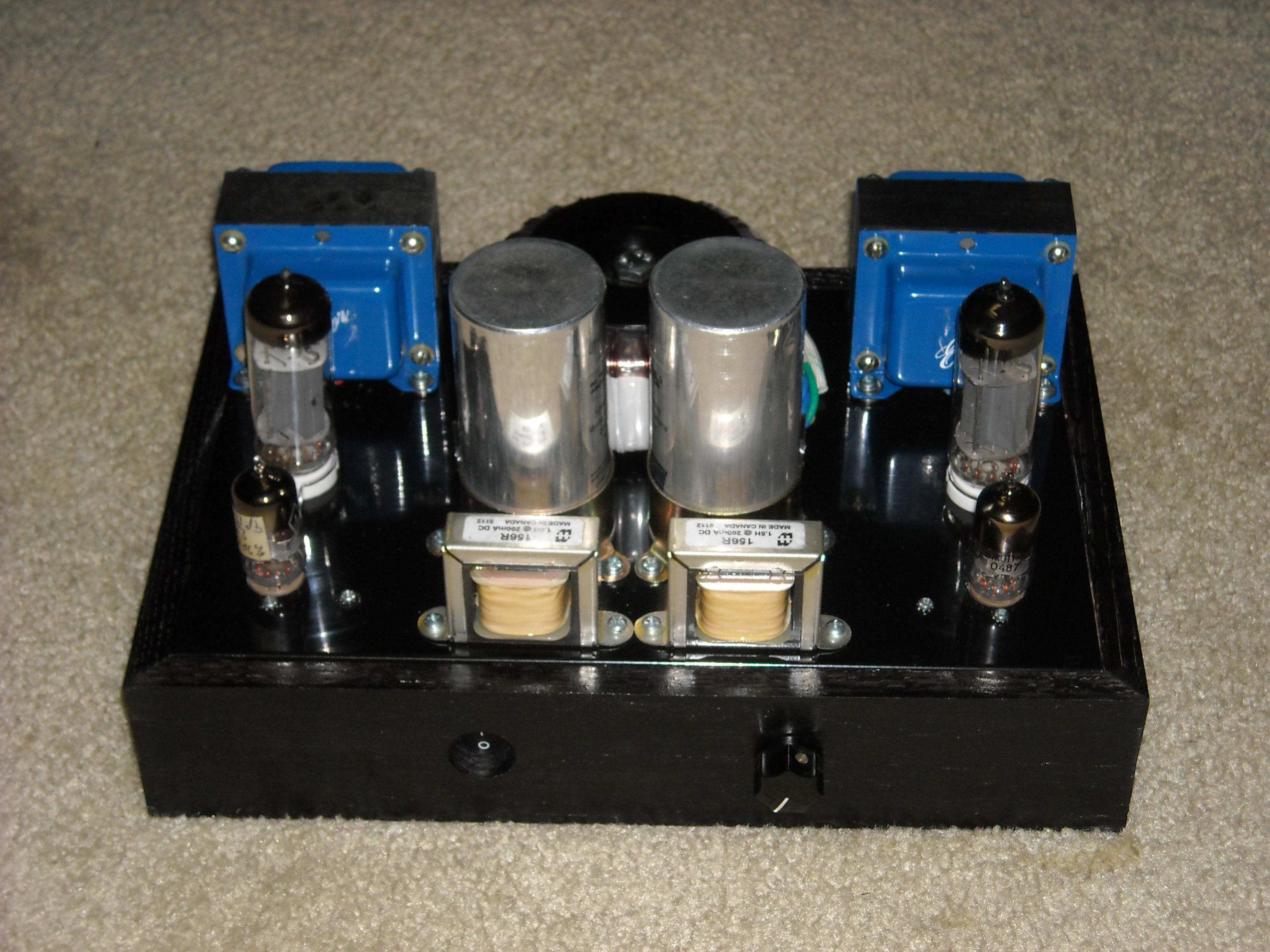

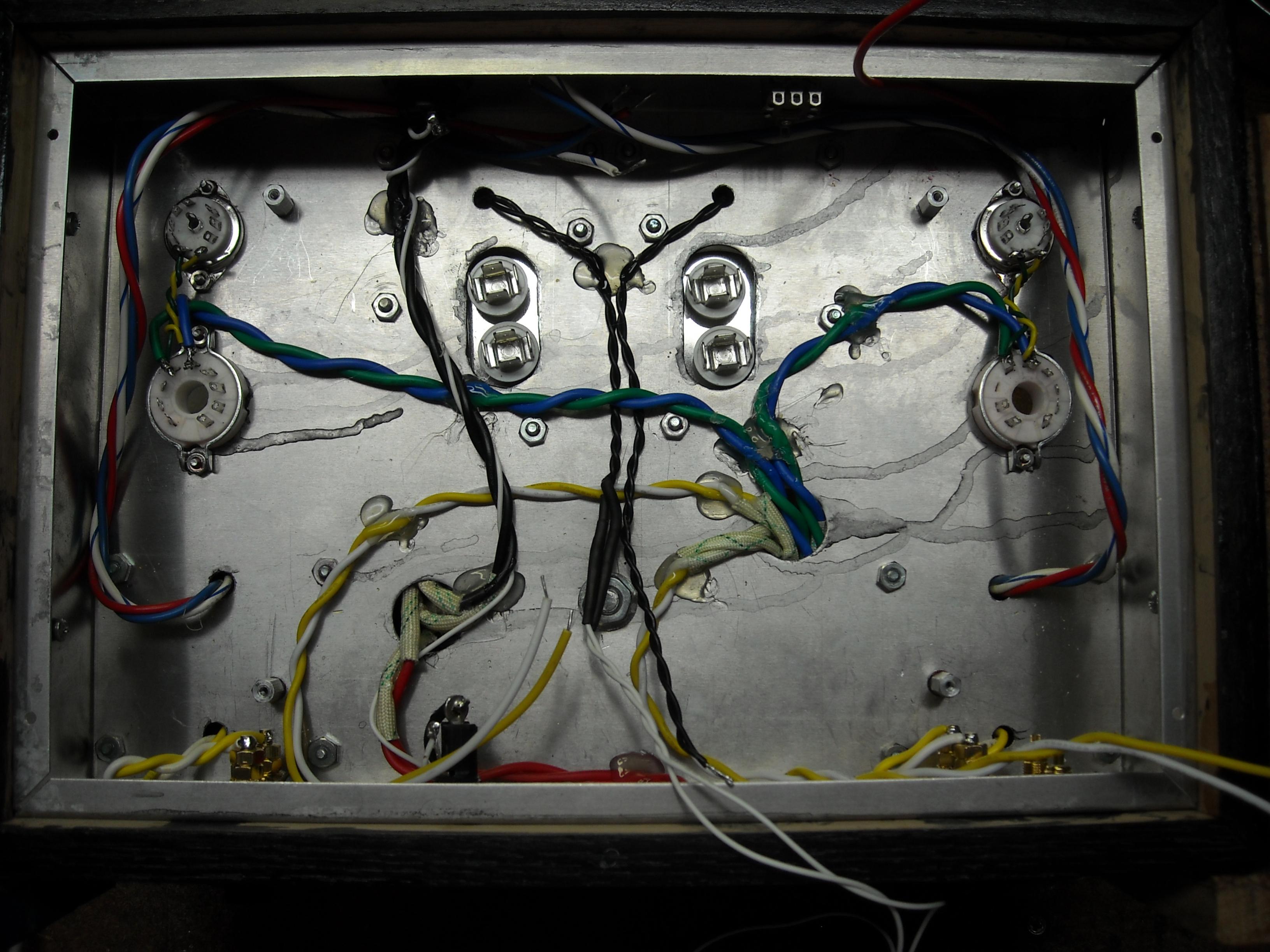

See photograph for symetry of wiring.

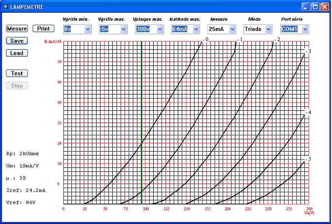

Here is a triode curve for the 6J9P (6Ж9П).

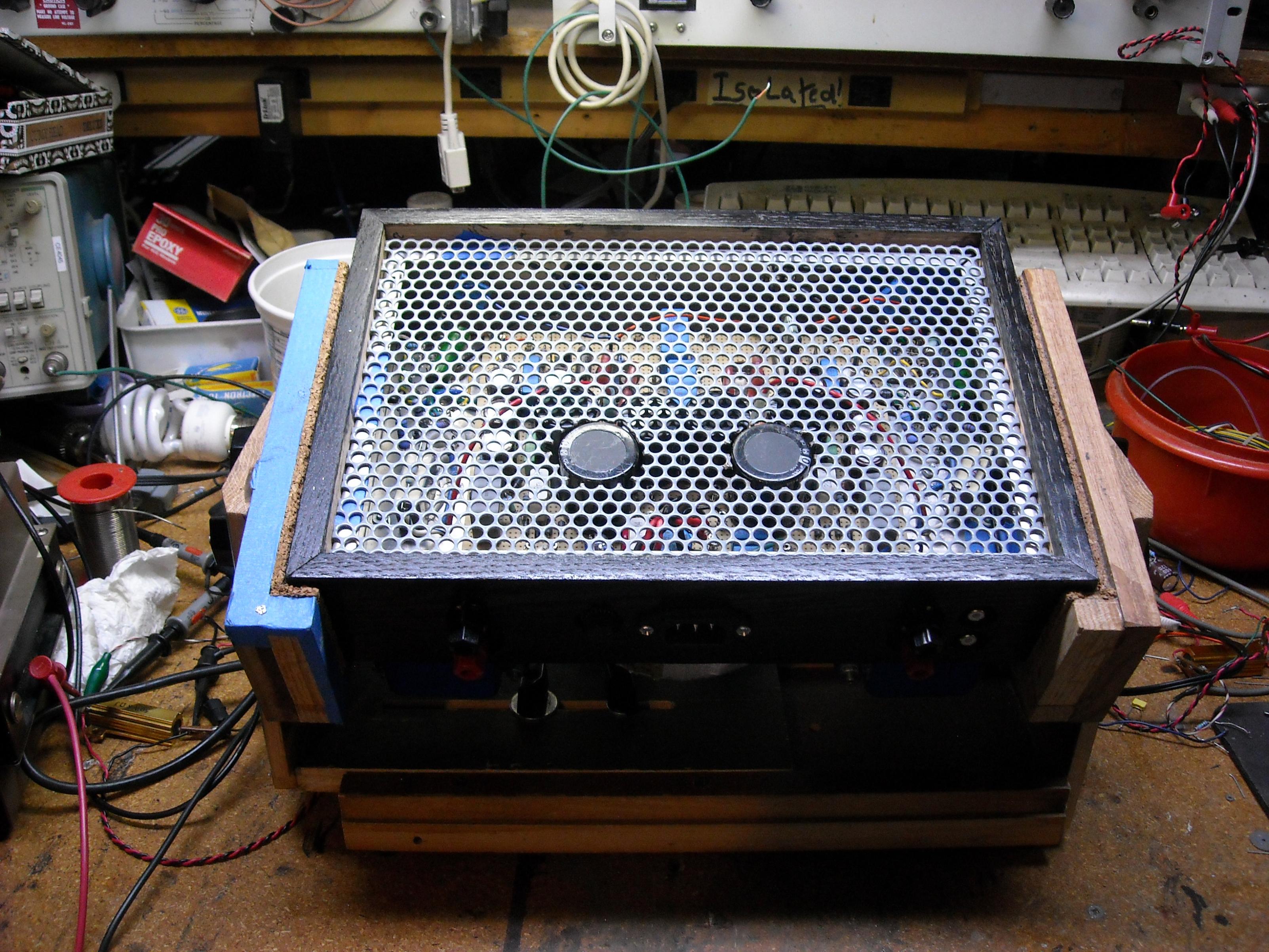

I added zobels from anode to gnd on the output tubes as they tend to oscillate without them.
I'll put a mesh plate on the bottom to allow airflow and keep fingers out, burn it in for a couple of weeks and it will be ready.

I use a bench grinder and file to soothe out the edges. The aluminum chassis inside the wood finish is recessed underneath, so the mesh will be covered by the wood when the mesh is in place. I'll add rubber feet after mounting the mesh as the feet will overlap it.
