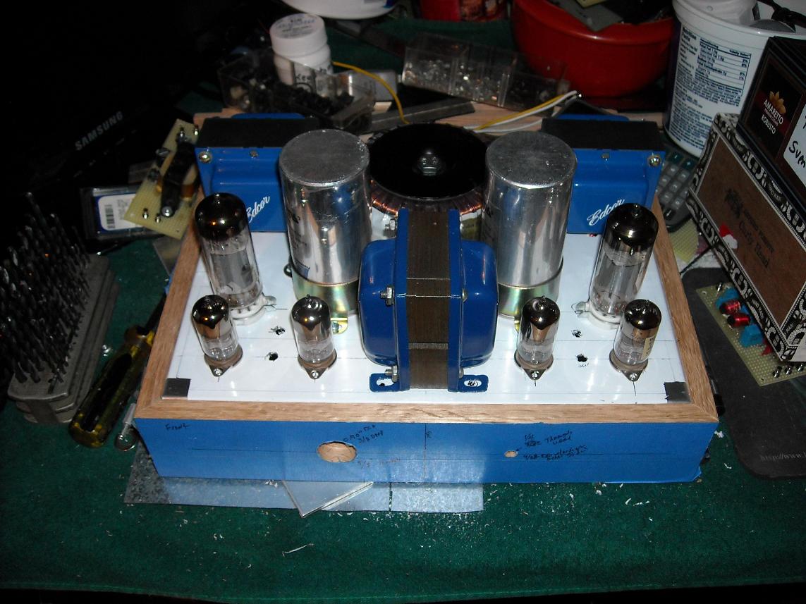

I still need a few spacers to mount the boards, and need to mount some terminal strips before I can start wiring it.
Hopefully I can get back from taking the granddaughter to weight lifting before the only real local Electronics Store closes. And, I hope they have the spacers I need.
Once I have everything placed, I need to decide if I'm going to paint the chassis (Black?) before mounting the wood cover or not. I don't think blue (sue to the blue transformers) or red would work with this one.
Canary Yellow?

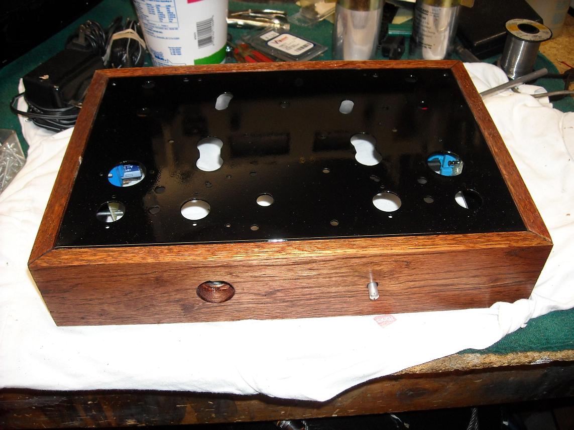

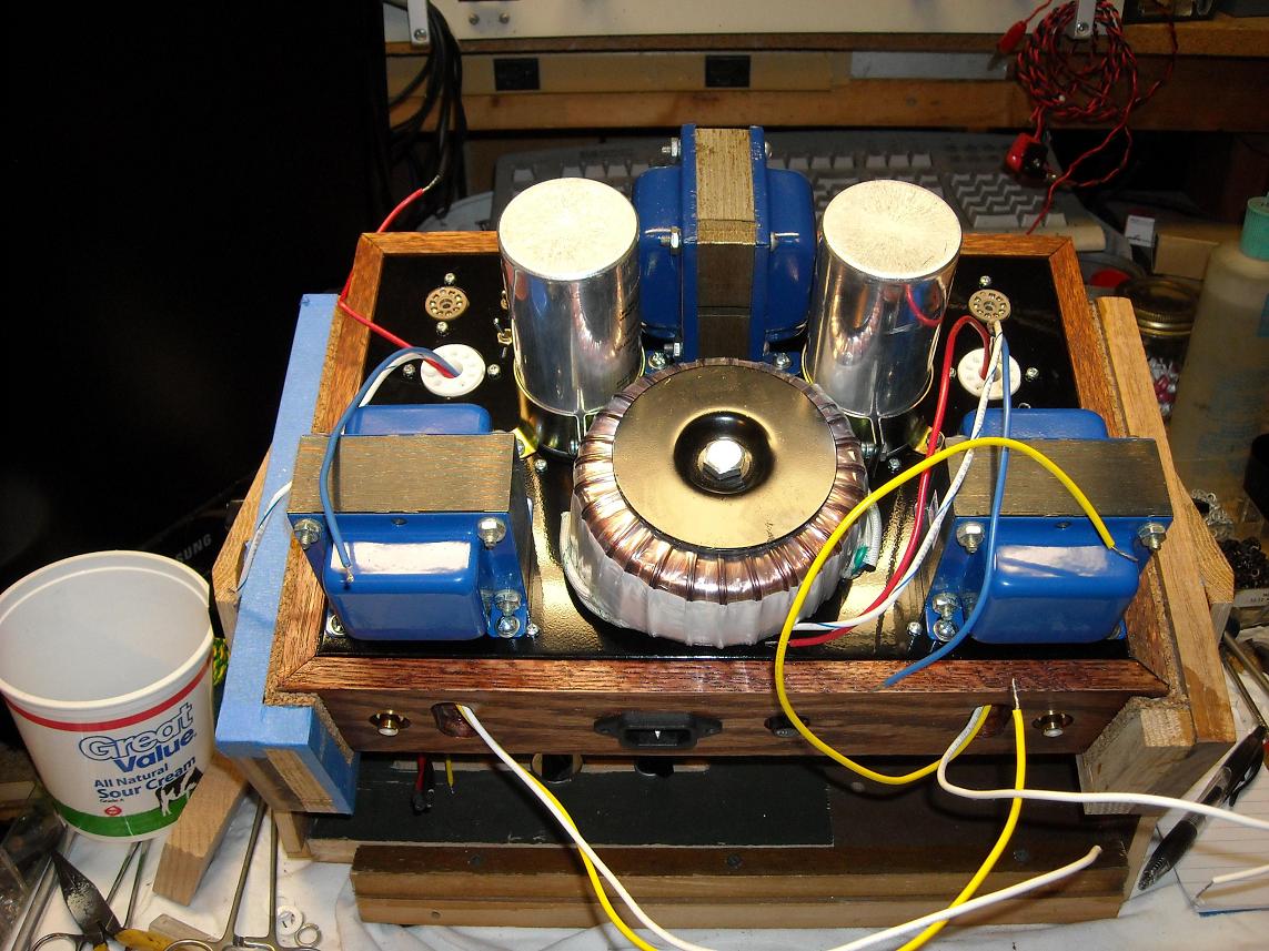

All major h/w in place and no show stoppers. There were one or two 'interference' fits but that was all.
I need to buy new switches. The ones I have are on-off-on DPDT and I do not like the possibility of accidentally leaving them in the center position with a no connect.

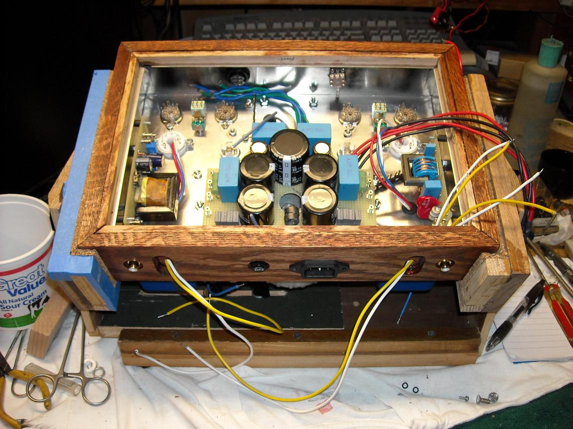

I've got the ac input circuit, line filter, Power Transformer, and bias supply wired in.
I decided to test it before proceeding as it is easier to fix now than after installing the rest of the circuitry.
Estimated power consumption is 75W, so I chose a 1A fast blow fuse for protection.
The problem is it blows fuses. I went through three trying to isolate the problem and finally decided it is the AnTek 1T200 toroid transformer. I switched to a 3A fast blow fuse and no problems.
Is this a characteristic of toroid power transformers, high inrush current?
No rectifiers or filter caps in the system other than the 470uf on the 24V transformer for grid bias voltage. Certainly that can't account for such an inrush.
I'll stick a NTC thermistor in the line to the fuse and see if it fixes it. Although it may not when I add the B+ rectifiers and filters.

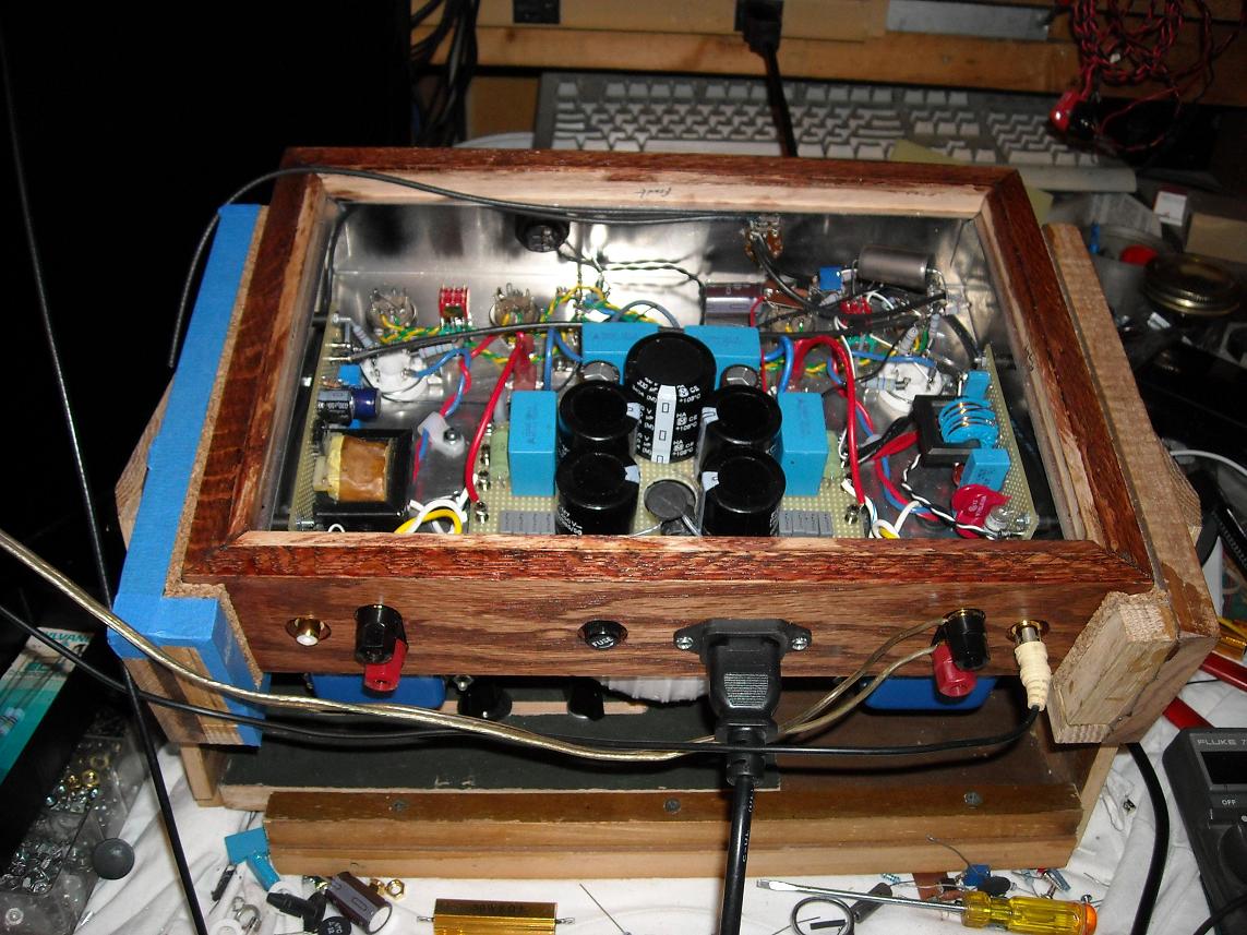

Left Channel is up and running.
WAF is already high. She heard "Have a heart" by Bonnie Raitt and said it sounded really nice.
Good attack on percussions. Vocals are nice with presence. strings are clean.
Even on 30 year old cheesy speakers it sounds good. I'll finish the other channel and move it to the den and try it on good speakers later this week.
I finished the amp tonight and I must say it sounds better than any other amp I own.
It will take a while to break it in and do some serious listening in the different modes it supports (U.L. vs Triode strapped output, and Current Source loaded Triode Strapped 6J9P vs Mu stage with two 6J9Ps for the driver stage).
That said, it is plenty loud. I measured 85dB in the shop at 6' from the speakers (two playing) with it cranked all the way up and driven by a computer CD player. I also measured my normal listening level for comparison and it is about 60dB fast response, C weighted for both.
