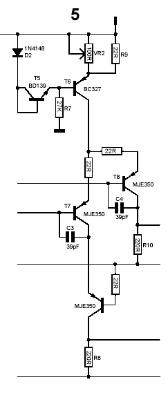

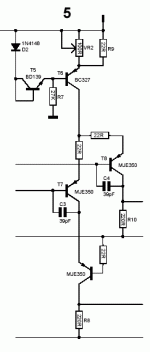

Hi quasi !
I think it's more like option #5... The 22ohms i added are optional.
But mje350 might be too weak, mje15033 is not a too fast device, i don't know which device is best here.
You might consider a driverstage to the mosfets ? Then you could keep the mje350...
Option 3 does not work like that, you must put a cap paralell to the 4.7k and discard the 2.2k.
Option 2 also does not work, the Vce for T6 is quite small, this 1.8k resistor will give ~20v creating negative Vbe for T7/8.
Mike
Michael, Quasi,
I think I like #5 too. It is beautifully configured to ensure that Vce and AC voltage swings on each of the two VAS devices are identical. This is probably as good as it gets, and it ensures that the compensation is applied symmetrically.
The best bipolars to use for both VAS and cascode would be 2SC4793 and 2SA1837, which are 100Mhz/70Mhz respectively and rated to 2A with very low junction capacitances and 150V/20W rating. These should be sufficient with rail voltages to about 70.
Commendable, Quasi/Michael. Really good solution!
Hugh

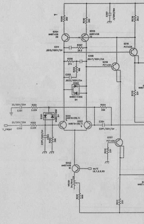

How about this connection for connecting differential and VAS? R236+Q204/205 makes the whole thing much more stable.
Q207 replaced by idea #5.
Quite different from Quasi's original, the bias setting is put in the differential CCS, and thermal compensation is Q204-205 placed on heatsink.

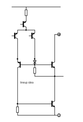

lumanauw said:
Hi, Mike,
Where is this #5 coming from? Very good indeed, but I don't see it in Quasi's options (only 4 of them)?
How about combining it with Kanwar's second stage? It has no emitor connected to rail supply, the PSRR and speed should be good with Kanwar's
I guess I am a bit to blame for this idea.
See my Post #123
http://www.diyaudio.com/forums/showthread.php?postid=810128#post810128
I was happy to hear Workhorse (Kanwar) knew more about this way
and to find that MikeB liked the idea.
Myself has never tested this in real circuit,
but the idea I got when theoretically (paper and pen) exploring ways
to make this kind of N-Channel amplifiers.
Must have been like 10 years ago.
