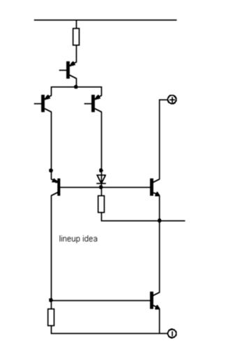

quasi
this is an old idea I have had, but havent tried yet
I have attached a drawing using bipolar
it is another attempt to 'cascading' VAS pair
in this type of N-Channel amps
to give this pair equal working condition
if it is of any use in this your project, I do not know
but I really would like to get my idea tested
by myself or somebody else
I think it may work
but
are there any advantages?
can there be any major drawbacks?

Welcome to the Quasi party guyZ

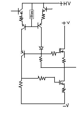

Hello HUGH DEAN,
Have a look at the attached photo...
No second differential...
Emmiter followers driven from first input differential ..inturn drives cascodes for voltage amplification & also reduces thermal drift and third single cascode facilitates symmetric drivability during high voltage swings ..& thus keeps the OLG much symmetric...
Please let me know about your views...
I implemented this topology in high power amp with VCC at + -130VDC.....The output Damping Factor [>1000@8 ohms]and High frequency response [100KHZ]was very astonishing.....Rail Loss was 0.55V....Mosfets were 12 pairs of APT30M85BVR..Driver Tansistors were BF471/472 video application 400V Bipolars
You were absolutely correct..the diodes were necessary to sustain nice operation during heavy clipping...
Well said LINEUP, this type of implementation is already in use with ECLER N-Channel amps www.ecler.com and also we use it exclusively...very good response

Hello HUGH DEAN,
Hi MikeB..MikeB said:Hi Hugh !
These clamping diodes are not across r4/5, between them. Under normal operation they would never conduct. But when the amp clips, the first LTP will saturate, creating large voltages here, in this case these diodes will prevent the 2nd diffamp entering reversebias conditions. I stumbled into this problem when i was working on a high power version of symasym, also using cascodes for the 2nd diffamp.
Mike
lineup said:quasi
K a n w a r

Re: Welcome to the Quasi party guyZ
thanks, Workhorse
Yes, I had my guess it had been used before.
Nice to hear it can work well.
Workhorse said:Well said LINEUP,
K a n w a r

Hi Kanwar,
This is a Rush Cascode, named after Christopher Rush in 1964. It is very rarely used in audio, but has stratospheric gain (giving very high feedback factor) and DC to light bandwidth.
I have experimented with it in SE in a Class AB PP amp some years back, but couldn't get it to sound good. Obviously with mosfets you have made it work.
I did find that a small resistor between the NPN/PNP emitters pulled back gain and extended linearity, but I doffs me cap to anyone who can get it to work reliably and sound good!
Hugh
Hugh
Hi AKSA...
Well said Hugh...
Besides this I have another topology much superior than this , which uses no additional elevated rails to get rail to rail swing..with drivers forming with BC558/548 complementary PP pairs driven from Bootstrapped Supply seperate for upper & lower rails .....All small signal Trannies just to drive the MOSfets....
K a n w a r
Well said Hugh...
K a n w a r
