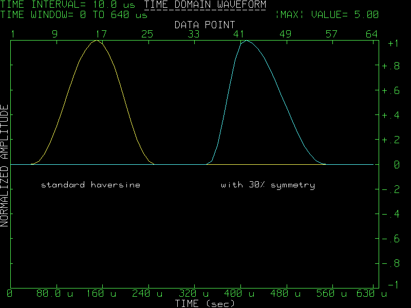

I see the confusion, we have two things being named "symmetry" now. I mean, alter the rising and falling slopes of the waveform so they are not the same. Here are a couple 5kHz haversine pulses: a standard one, and then one with a 30/70 slope ratio.
The frequency spectrum of these is in the next post.
KSTR said:All in all this is not an easy task as there are so many variables and setup conditions to consider with pretty unkown sensivity to the results, as of yet.
If it was easy, it would be as rewarding... I'm doing my best to sort things out as I go along.
Uh, do you mean shifting one of the stimulus polarities by the corresponding time (a sub-sample fraction, as it looks)?

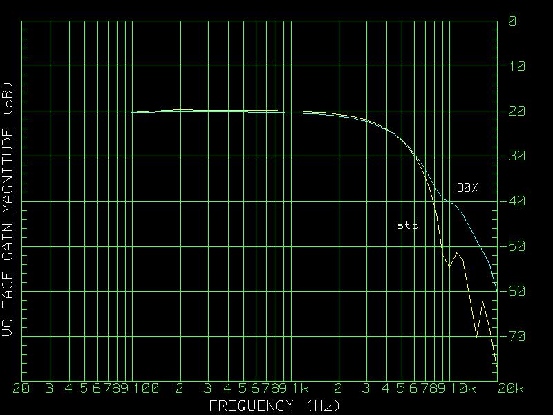

A standard haversine has a frequency spectrum that is -6dB down at the pulse frequency, then ever deeper notches at higher multiples. This is caused by the rising and falling slopes being the same. It's a bit clearer when plotted on a linear freq scale.
If you alter the rate of the slopes to each other, then the notches are filled in, giving a really well-behaved HF rolloff. It is a self-anti-aliasing, uni-polar lowpass response, pretty close to a 4th order Bessel response. As long as you have enough sampled points to define it well, it's a pretty ideal stimulus.
The graph below shows their reponse overlaid.
One could put together an ensemble of these with different rates and time placements, using Fibonacci ratios, to get steeper rolloff and more energy per window. But that's a project for another day.

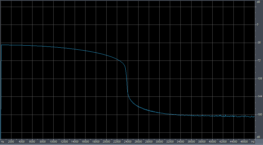

Yes, I get your point, something worth to consider. My bandlimited stimulus also has a nice roll-off, see attachment. Instead of linphase bandlimiting (as created by the upsampling) one might also try inverse minphase filtering, placing any ringing in front of the pulse. And preferably with Bessels or other low ringing filters as with 2x upsampling I have enough space to reach the stopband. Next soundcard will be a 192kHz model, so I expect to get good data to some 50kHz or so.jbau said:If you alter the rate of the slopes to each other, then the notches are filled in, giving a really well-behaved HF rolloff. It is a self-anti-aliasing, uni-polar lowpass response, pretty close to a 4th order Bessel response. As long as you have enough sampled points to define it well, it's a pretty ideal stimulus.
EDIT: I see the advantage of asymmetric haversines, impulse compaction on the rising edge to exite the DUT with a stronger dV/dt or dI/dt while having a benign spectrum at the same time
There really are many valid approaches it seems... your "ensemble idea" of differently parametrized pulse sets looks quite promising, too.

KSTR said:My bandlimited stimulus also has a nice roll-off, see attachment.
Yes Klaus, that looks very good, too.
Sounds interesting, keep us posted.

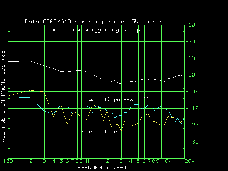

Perserverence furthers. The search for stable, repetitive triggering has paid off in spades. I spent a couple hours last night combing through the volumnous Data 6000A manual, searching for a definition of the various system control signals that can be routed to the rear panel BNC connectors. Yes, there was the "trigger conditions" one mentioned earlier. But that wasn't working as expected. I tried one called "Gate A" which had no description, but it wouldn't trigger the 625 reliably, even when using a pulse generator to reconstruct the pulse for the 625's benefit. Viewed on a scope, it danced around the "trigger" output and in a seeming random manner.
So I looked in the old, original Data 6000 manual, and there was the Gate A signal description: "negative true pulse at the first and last sample in the frame." That's exactly what I'm looking for! And then I realized - the reason it "danced around" the trigger pulse is because the trigger pulse followed it in time and was a signal to the system cpu, while the "Gate A" pulse was the start signal to the ADC.
So I traced the line back from the BNC connector to a 74LS355 mux on the plugin's ADC control board, looked at the schematic, and voila. That's the source. The 625 wants to see a positive-true trigger pulse, and the 74LS355 has both + and - true outputs, so I moved the output from the negative true pin to the positive true pin. Put the system back together, and hooked the Gate A signal through a pulse generator with a couple microseconds delay to allow the system trigger to catch up, fired it up, and there it was on the screen, motionless. At first I thought, hey, this thing isn't moving, maybe it's not really collecting new data. But varying the pulse level changed the pulse immediately, so I knew then it was triggering as solid as a rock. Less jitter than the HP 3437A, even. Exactly what I was looking for. The haver pulse is now perfectly synchronized to the ADC.
The chart below shows the symmetry error between + and - pulses (top trace), then between two + pulse records, and then the noise floor with pulse output defeated. All made using 512 averages. The scaling is dbV, and I'll use that from now on for consistency. (Note, these were taken with 5V pulses so drop the curves by 14dB for dB re: full scale.
These are really quite good measurements, especially for a 14-bit system, with excellent repeatability. (Note: the noise floor measurement was higher at low freq's because the 625 is ground-lifted and I removed it's connection to the pulse gen where it found it's ground reference to the analyser.)
BTW, if anyone has a Data 6000/6100 with 610 or 611 plugin and wants to make this mod, email me. It's quite simple to do.
Also interesting to note is the plot of the difference between two positive pulse records. It is essentially at the noise floor below 2kHz. So, when making measurements of a DUT, it looks like the way to avoid the symmetry error of the analyser is to use a second transformer: one to flip the pulse polarity, and the second to flip the DUT's output to keep it in the same polarity for the analyser.
The trigger jitter issue has been licked. Measurements can now begin!

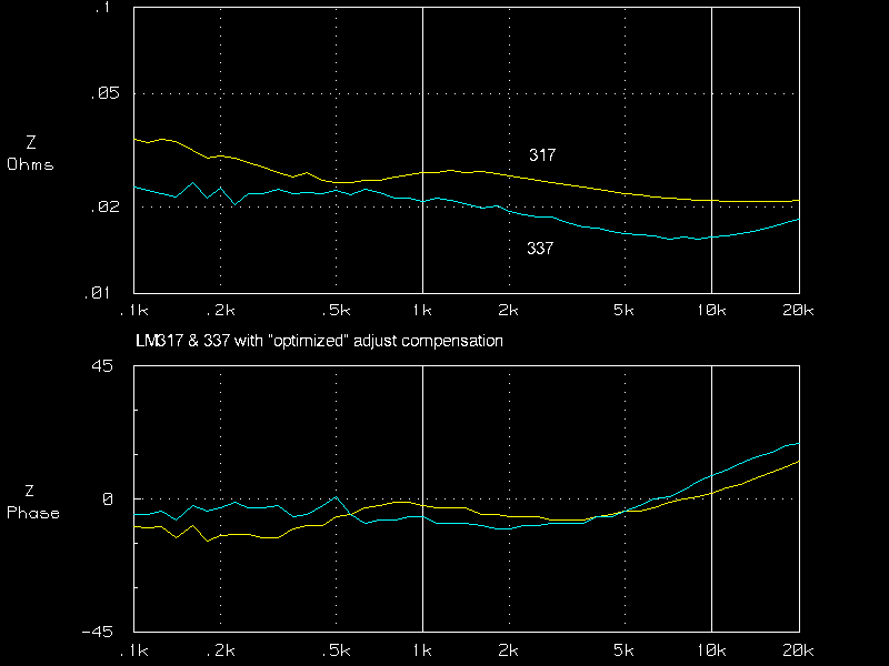

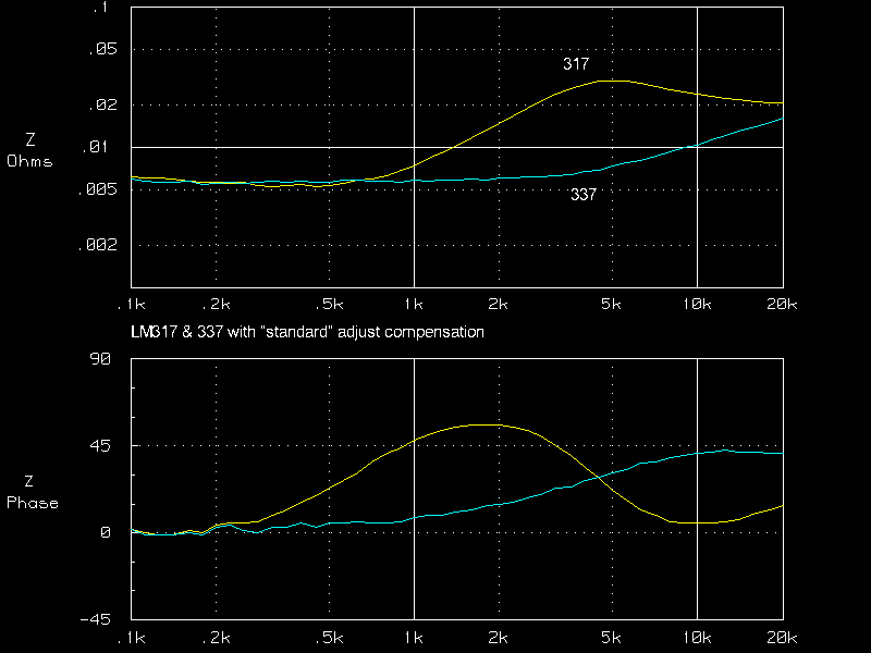

Each measurement will consist of two symmetry difference traces with nominally +-15V supplies using the LM317/337 regs: one with "standard" adjust circuit, and one with the adjust circuit "optimized" for flat Z and Zphase. The idea is to compare the symmetry diff traces to each other and to their respective Z/phase curves and see if any patterns emerge. All plots are 100Hz-20kHz and normalized to dBV.
The regulator adjust circuits are:
Standard: (except for load R, both regs have the same values)
Vin-Vout = 6V
out to adjust - 240 ohms
adjust to gnd : 2.7k ohms || 100uF
output cap: 1500uF w/ 10uF film
load resistance: 165 Ohms (317) and 330 Ohms (337)
Optimized:
LM317: Vin-Vout = 2.7V
adjust to gnd : 2.7k ohms || 120nF
LM337: Vin-Vout = 2.7V
adjust to gnd : 2.7k ohms || 33nF
load resistance: 330 Ohms
So the only difference between std and opt. is the Vin-Vout and the adjust caps.
Here are the reference Z/phase curves for the "standard" config, measured at the output caps. It's connected to the DUT board with 3" of #22 wire, 100nF ceramic bypasses there.

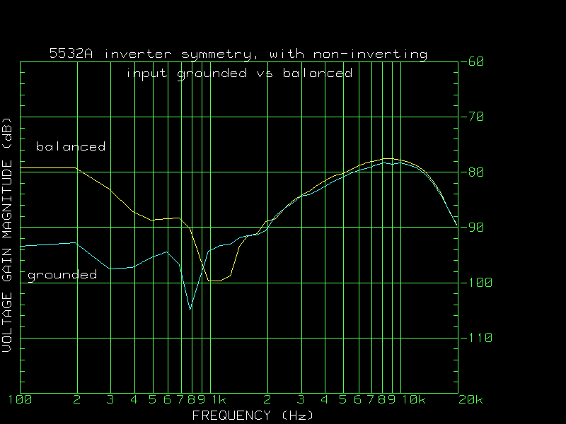

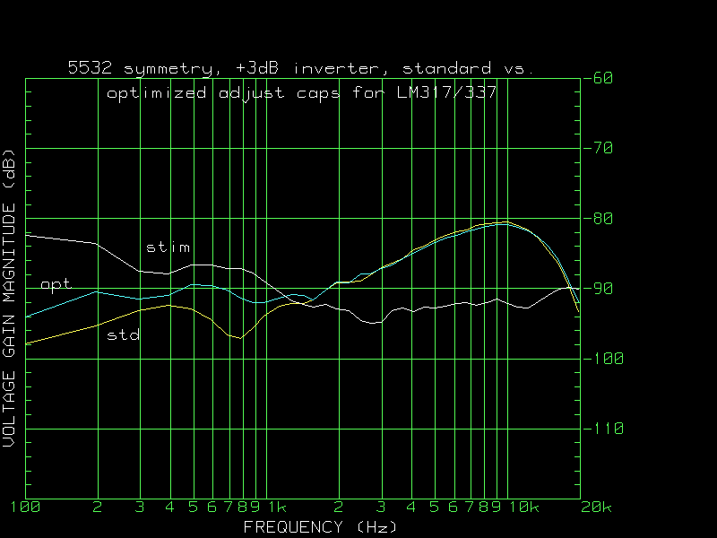

And here are the first measurements. Remember, lower dBs = less symmetry error.
The DUT is a Signetics NE5532A, with 3.2dB gain in inverting mode to avoid common mode errors. Impedance at the + and - inputs are balanced to minimize DC errors and for FET opamps if they are used. Load resistor is 10k Ohms, then a 75 Ohms output R to isolate the output from the cable C. So we're not pulling much current from the supplies at all, maybe half a mil each side.
There are two "apparent" problems with the curves.
First, below about 1.2kHz, the measurement floor is higher than the DUT measurements in either config, which is unlikely, unless this is the magic of negative feedback at work. 🙂 My only explanation for this is that, when making the reference measurements to see the generator's measurement floor, I had to raise the output level of the haverpulse generator by 3.2dB in order to get the same full-range input to the analyser, which raises it's output noise by that much. So it's possible that this curve should be at least 3.2dB lower. Other than that, I don't know how what could cause this. There were no other changes in the measurement setup.
Second, above 1.5kHz, the symmetries with the std and opt. supplies are nearly identical, swamping any other details, and looking very much like the shape of the high-jitter curves we saw earlier. That raised enough doubt that I re-did the stimulus symmetry measurement of the generator, and overlaid it on the graph (labelled "stim"). Compare this to the the upper "measurement floor" symmetry curve on the graph in post #173, and you can see how consistent and repeatable the measurement is. So the high-freq. symmetry error is real. Is this revealing an inherent high-freq. nonlinear distortion of the 5532? Or is it something else? The time trace didn't show any signs of jitter so that isn't the cause.
Below 1.5kHz, the std regs have lower and better-matched impedance in this range, and that trace has less symmetry error there. So that part makes sense.
Beyond that there isn't much to say right now. More measurements of different DUT's need to be made and examined. Perhaps lowering the opamp load R some to draw more current would help bring out details. Perhaps exaggerating the Z/phase difference of one of the rails would be illustrative. We shall see.
Stay tuned...

I've been unable to do anything that significantly improves the worsened symmetry error at high freqs. I've tested different opamps; NI 4562, AD 2132 and AD 746, and the lowly TLO72 and the pattern holds. This is the test circuit, by the way. I'm using it because it's the I/V circuit in the Sony DAT I'm modding.
39pF
| |\ 20k |
13k8 | | \ |
in ----/\/\/\----|- \ | 75R
| \------|----/\/\/\--- out
\ | |/ 10k \
8k2 / - /
\ - 39pF \
------------------------- Gnd
I did find one interesting thing, however, about the question of balancing the impedance seen by an opamp's + and - input. In past distortion tests, for noninverting configurations, I've measured (and heard) that it's very worthwhile, especially for FET inputs. But for inverting configs, measurements and listening tests have been inconclusive.
While looking for a possible cause to the high-freq rise, I ran the symmetry test with the 5532A + input grounded. See the graph. No significant difference at high freqs, but quite a large difference below say 1kHz. I can't say whether this is just lower noise or actual improvement in symmetry, but regardless, a 10-15dB improvement is hard to argue with. Also, the DC offset was actually less with the + grounded.
I'll run it again with one of the FET opamps and see if the same results hold true.
