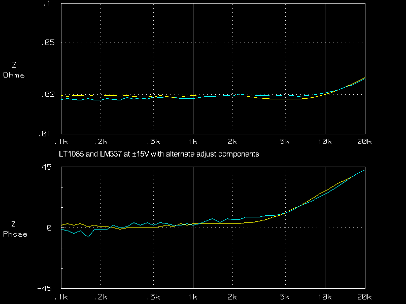

Here is an alternative, using an additional RC across the adjust cap to "shape" the overall impedance slope while optimizing the adjust cap. Everything is the same as previous, except change the adjust to ground components to this:
The resulting Z/phase curve is below. Now if you didn't see the phase curve, this would look like a definite improvement over the simpler version. The mean impedance value is around 19 milliOhms vs 24 for the previous. And the Z curve is quite flat up to 10kHz. But the phase departure is quite a bit worse. Wringing out that lower Z comes at a cost.
Anyway, do with this what you will. If you don't think phase is important, but like the idea of a flatter Z over a wider range, then this one's for you. It's still better than what the factory recommends.
One of the units I'm modding needs ±12 VDC so I'm going to cook up one of those next.

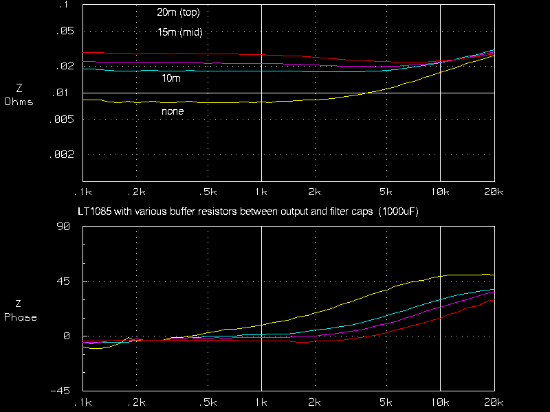

A different approach
1. I think it's been obvious to many of you that, while flattening the Zout/phase, I've essentially "detuned" the regulator, sacrificing line regulation and output noise in the process. This is the direct result of using larger impedances (smaller capacitor values) in the adjust-to-ground leg. Since I'm no longer focused on the LM317, and since neither the LT1085 or LM337 exhibit instability with larger adjust caps, I decided to seek an alternate route to flatten the Zout while keeping it as low as possible and letting the regs perform at their best.
2. Above approx. 5Khz, the Z flatness is basically determined by the regulator Z divided by the impedance of the output caps. Values in the 1000uF to 1500uF range have given the best results so far. It appears the caps' ESR sets the "floor" of this division.
3. These regs deliver AC current into these low impedance and capacitive loads with significant phase shift.
So I decided to experiment with different output resistors to "buffer" the output from the load, placing them between the LT1085 output and the filter caps/load resistor. The setup:
out to adjust : 100 ohms
adjust to gnd : 1.12k ohms || 10uF tantalum
output cap/load: 1000uF lytic w/ 10uF film || 330 Ohms
This is the same as the last measurement, except the adjust cap is a 10uF tantalum.
See the graph for Zout and Zphase plots. Buffer resistor values are:
Yellow = 0 Ohm
Cyan = 0.01 Ohm
Violet = 0.015 Ohm
Red = 0.020 Ohm
If you compare these curves to the ones of similar mean Z value generated previously using the detuning approach, you can see they are pretty much the same, except they are smoother. This is evidence of the better line regulation/ripple rejection and lower noise, especially below 500Hz.
The other value of this approach is that it is much more universally applicable. It can be used with ANY regulator to linearize the Z/phase.
The resistors used are "current sense" resistors, commonly used in switching power supplies. One could also use small-gauge wire, but the series inductance would be higher. For example, 26 gauge magnet wire has resistance of 0.041 Ohms per foot. So 6 inches gives you 0.020 Ohms. I cut a piece and verified this. But a single loop of 26 ga. 6 inches long has about 13uH of inductance and significant Zphase. So that's not the best way to go about it.

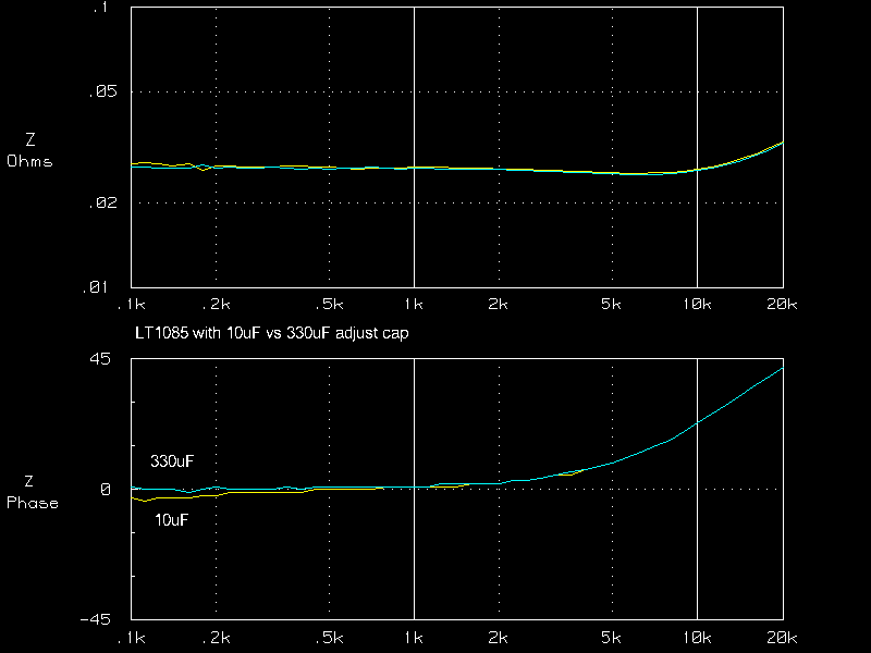

One thing that bothered me about the previous phase curves is that the phase hung below zero from the very start. The only way that happens is if the Z below 100Hz was actually higher and descending downward. This in turn infers that the adjust cap perhaps could be made larger to bring down the output Z below 100Hz and improve the overall flatness. So let's try it with the .020 output R in place.
See the graph below. The yellow curve is with the 10uF adjust cap, the cyan curve is with a 330uF lytic adjust cap. Sure enough, the Zphase below 500Hz is made more linear with the lower impedance on the adjust terminal. We couldn't do this with the LM317 without causing instability and resonance, and because of it's Vin-Vout sensitivity. But the LT1085 doesn't have these issues and definitely benefits from the larger adjust cap in this configuration.
