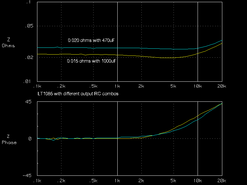

Assuming we want to keep the mean Z value down in the 20-25 milliohm range, the buffer R would either be .015 or .020 ohms. So let's look at those with the 330uF adjust cap and with output caps chosen to give the flattest Z in each case. This will also verify the Z division action I described earlier.
The yellow curve is with a .015 buffer R and 1000uF output cap.
The cyan curve is with a .020 buffer R and 470uF output cap.
Either one would probably do fine.
In order to flatten the Zphase all the way up to 20kHz, it looks like a buffer R value of around 40-50 milliOhms would be needed, and output C would probably come down to the 220uF range. I may play with that later.
Also I need to re-optimize the LM337 circuit with this same approach.
Impedance analysis is a sweet tool for fine-tuning power supply characteristics for audio.

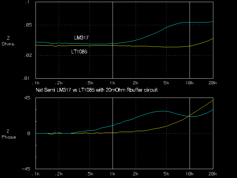

I couldn't resist the temptation to see if this buffered output technique would bring any improvement to the Nat Semi LM317. The answer is, no, not yet. It just exposes some of it's weaknesses even more. Maybe with Rbuffer at .050 it would do OK.
The LM317 is looking more like a saddle without a horse to put on. It's unsuitable for audio, and an LM78xx will do just as well for digital circuits.

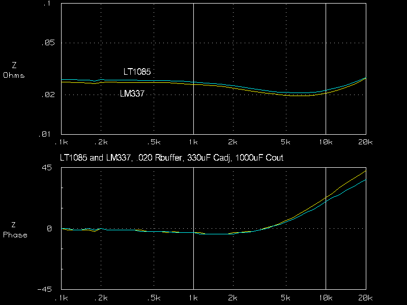

As I expected, the LT1085 and LM337 are very well matched with this buffered-output technique. Here is the plot overlay. The values used are the same on both regs: 0.020 Ohm Rbuffer, 330uF adjust capacitor, 1000uF output cap, and 330 Ohm load resistor. As before, a 470uF Cout will give a flatter Zout. Or you can use the 0.015 Rbuffer with 1000uF Cout. Your choice.
Another advantage: the output Z/phase doesn't change with different output voltage. Changing the adjust-to-ground resistor for 12VDC output gave the same Z/phase curves on both regs with no other component changes required. Very nice.
Who will be the first (besides me) to put one of these together and listen?
