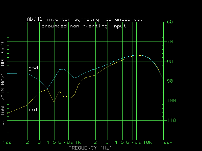

Here's the plot for the AD746, a longtime fave of mine. There is a HUGE improvement, even as an inverter, with balanced impedances at both inputs. (The OPA2132 curve looks similar though not as dramatic as the 746, which has higher GBW and OLG.) Listening tests last year showed a clear preference for the balanced config, but harmonic distortion measurements showed no difference.
Looking at this curve, it's very tempting to conclude that the symmetry has more to do with available feedback than it does with power supply Z/phase, especially at high freq's. And the fet opamps appear to have 4-6 dB worse symmetry at 10kHz than the bjt's. Maybe that's what gives the fet units that characteristic "edgy" or "better defined" sound.
Noise in a 30kHz BW is the same whether grounded or balanced, so it's not tracing the noise floor.
This measurement is bringing out some very interesting info, but not yet what I was hoping it would. Yet...

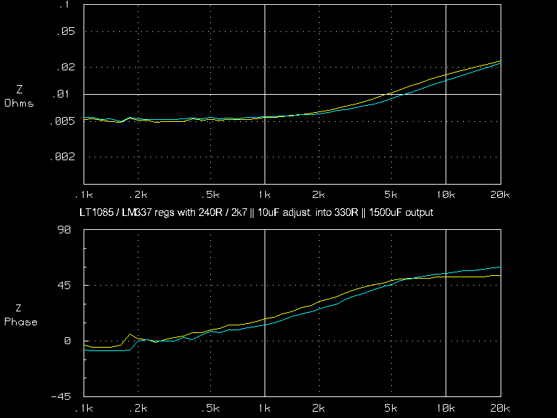

Now to run some symmetry tests with the LT1085/LM337 pair, which, as we saw back in post #147, are very well matched (the best I've seen yet) and free of the 600Hz resonance that the LM317 has. I ran the impedance curves again and you can find them below. Vset component values for ±15VDC are the same for both regs:
Vin-Vout = 6V
out to adjust : 240 ohms
adjust to gnd : 2.7k ohms || 10uF tantalum
output cap: 1500uF lytic w/ 10uF film
load resistance: 330 Ohms
In the theory of "low, linear, and matched" power supply Z/phase being desirable, this is two of the three. Linear it is not, with a 4-times rise in Z from 100Hz to 20kHz, and corresponding inductive phase from 100Hz on up. It will be interesting to see how this reflects into the symmetry error.

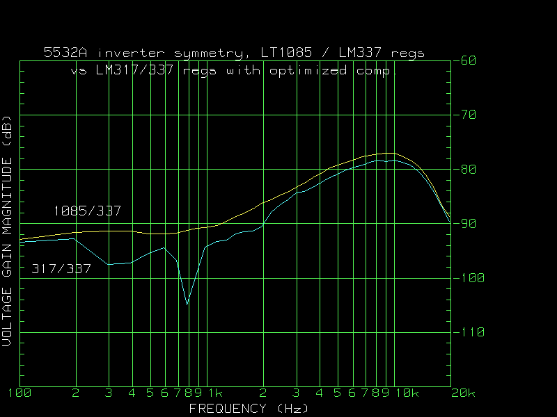

And here is the symmetry curve of the 5532A inverter, the exact same setup as before, with grounded + input. The measurement of this exact configuration with the optimized LM317/337 regs is also plotted for easy comparison.
And we see that, despite the tight matching and lower Z values everywhere (and lower noise, too), the symmetry error is WORSE across the board. The only area of improvement is in the 500-1000 Hz region where the LM317 resonates.
So obviously lower Z and tight Z matching is not enough. But since I'm not ready to toss out the "lower, linear, and matched" theory yet, I have to conclude that Zphase IS very important, and maybe the most important of the three. To the point that it's worthwhile (i.e. audibly beneficial) to give up some ultimate lower Z values in order to linearize the Zphase.
So that is what I'll do next. Optimize the adjust circuits for lowest Z and flattest Zphase. And compare that to a simple RC filter that might accomplish the same thing but with a little higher Z values.
It would be really nice if someone who has what they feel to be a superior bipolar power supply would post the Z/phase curves for it under load conditions. There are several guys on this forum who have the equipment to do it. It would be really useful for everyone to see what these other, highly-touted supplies look like impedance-wise.

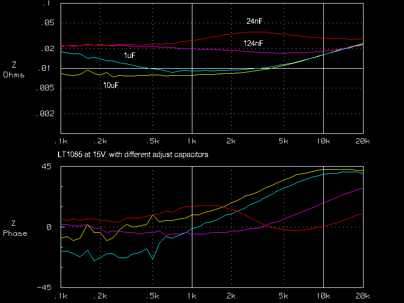

OK, back to measurements. Here's another interesting one. It's the Z/phase curves of the LT1085 regulator at 15V output with various values of adjust capacitors, from 24nF to 10uF. (There was no significant difference with adjust caps larger than 10uF so I didn't plot those.) Since the LT1085 isn't plagued by the resonance that the LM317 is, I lowered the Vset resistances down to the factory recommended value. The Vset components:
Vin-Vout : 6V
out to adjust R : 120 ohms
adjust to ground R : 1.3k ohms
Output load : 330 ohms, 1000uF
If you're not familiar with phase plots in conjunction with their respective magnitude spectra, these plots are a good example of how the phase changes as a function of the impedance distribution. Even though the values don't change that much in an absolute sense (they're all below 30 milliOhms), merely changing the impedance trend and distribution changes the phase (i.e. alters the timing relationships) before the actual impedance changes. That's why calculating things like PSRR and ripple at one frequency doesn't tell the whole story. And it's also why judgments of inductive vs capacitive behavior can't be taken as absolute reality when dealing with regulator outputs. By making some tradeoffs (i.e. optimizing), it can be easily changed. And there is great audible benefit in doing so.
Anyway, the sweet spot looks like it will be a little below the 124nF curve so I'll dial in on that shortly, and then optimize the LM337 to match it as best as I can.

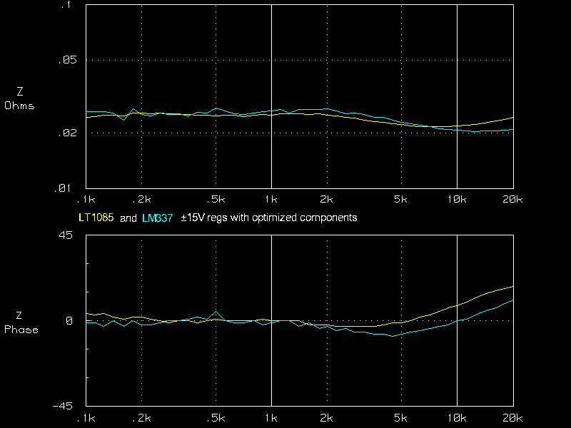

Another day of scorching outdoor temps gives a good excuse to stay inside and work on circuits... 🙂
Here are the Z/phase curves for the optimized LT1085 / LM337 pair. Average impedance level isn't as low as I'd hoped to achieve, but the Z/phase match is still the best I've seen yet. The phase is ±10º up to 10kHz. The component values:
LT1085
out to adjust : 100 ohms
adjust to gnd : 1.12k ohms || 100nF film
output cap/load: 1000uF lytic w/ 10uF film || 330 Ohms
LM337
out to adjust : 120 ohms
adjust to gnd : 1.32k ohms || 39nF film
The LT1085/LM337 combo is a definite improvement over the LM317/337's, and I see no reason to use the latter unless you have a bunch of 317's laying around that you need to use. From what I've seen so far, this may be as good as it will get for the 3-terminal adjustable regs. I'll report on the sound quality as soon as I get them installed.
Next up for me is a look at the fixed 5V regs that feed the ADC and DAC. There are millions of devices out there that use fixed ±5V regs fed from the 12 or 15 volt rails. The analog portion of these devices will benefit greatly from linearizing the phase, especially the A/D converter. I'll start a new thread for that one.

jbau - since you haven't changed the fundamental internal circuit design of the LT1085 and LM337 in these experiments, can you please explain how the impedance remains flat up to 20kHz (and actually decreases at higher frequencies) when the gain of the error amplifier in both these regulators starts falling after about 10Hz?
Also, why are the values of the support ciruit components in the optimised LM337 in post 176 above i.e.:
out to adjust - 240 ohms
adjust to gnd : 2.7k ohms || 33nF
output cap: 1500uF w/ 10uF film
different to these latest ones i.e.:
Are they both optimised??
because the output capacitor(s) is in parallel with the regulator. I see essentially the same thing. You don't have to go to much higher frequencies before Zout starts to rise as you would expect.
Gopher said:
Also, why are the values of the support circuit components in the optimised LM337 in post 176 above i.e.:
My guess is: YES they are both optimized- for the given resistor values. I think that the efficacy of the adjust capacitor is related to the adjust resistor, therefore, a higher capacitance is required when the resistance is lowered.
