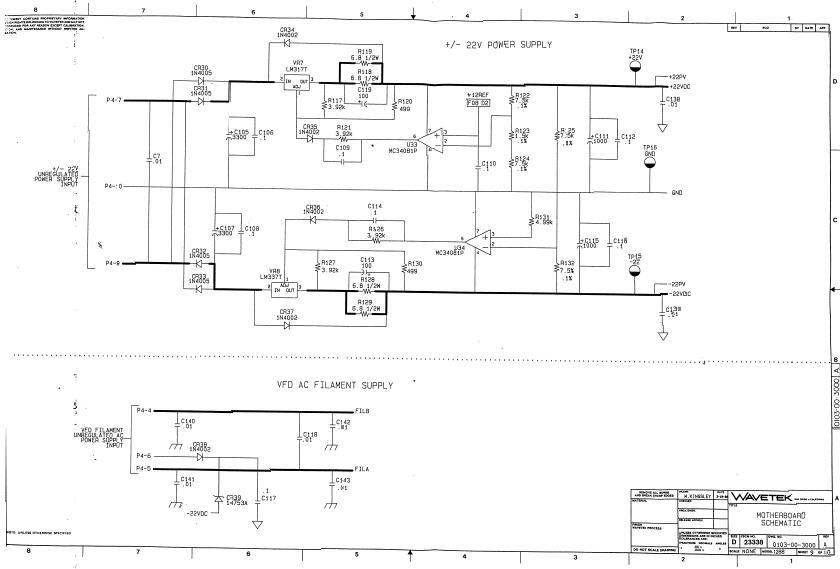

Wavetek thinks flat supply impedance/phase is important. Their 288 function generator uses 317/337 with lots of support circuitry to get the system impedance flat. But the way they do it, the 317 is 0.2 ohms higher than the 337. I can post a schematic if you wish.

jbau, I'd really like to see the Wavetek 3x7 circuits if you are willing to share. There is always something to learn.

I've attached the +-22V supply drawing from the Wavetek 288, the 12V circuits are the same except some different resistor values.
