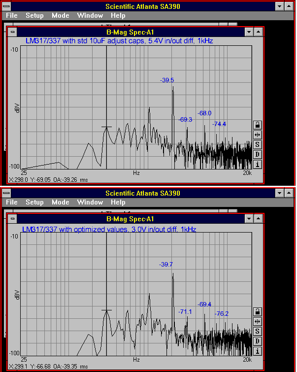

Ok, here are some harmonic distortion measurements, comparing an opamp-amplified signal first with the 317/337 pair with standard 10uF adjust caps and more normal 5.4V input/output differential, and then with the optimized adjust caps with 3.0V diff. I don't think HD is going to adequately describe the effect that balancing and linearizing the PS impedance has, but it's a place to start.
The test setup: 1kHz low-distortion (0.0007% THD) sinewave from Amber 3501a THD analyser fed into one side of a TLO72, noninverting with 10dB gain, + and - inputs impedance-balanced (yeah, I'm a nut about that). (Knowing from the past how un-fussy TLOs are about power supplies, I figured if I could see any difference at 1kHz on a TLO72, it would show up with just about anything else.) 🙂 1VRMS fed in to the TLO, giving 3.1VRMS out.
The opamp output is fed into the 3501a input. The analyser's distortion output is fed into an SA390 FFT analyser input. The 3501a monitor out (a buffered version of the input signal) was used to trigger the FFT for time-synchronous averaging. 256 averages does a great job of reducing the random noise and pulling the harmonics out 140-150dB below the signal level, by phase-synching the data records to the input signal.
The numbers shown are dB's relative to the full-scale input level. The highest peak is the 2nd harmonic, this corresponds to about -98dB on the THD analyser meter. The lower peak to the left is the remainder of the 1kHz input signal, about 16dB below the 2nd harmonic level. Not bad nulling for an "old" meter...
The top plot shows the regs with standard configuration, the bottom one is the optimized setup. I marked the values of the 2nd, 3rd, 5th, and 7th harmonics for easier comparison. As you can see, with the optimized regs, the 2nd is a tad lower and from the 3rd harmonic on up they are all lower by a couple dB. The 4th harmonic was lower too but it was buried in the noise floor so I didn't itemize it.
Like I said, I didn't expect a THD measurement would capture what I imagine to be more of a nonlinear distortion. Nevertheless, even a single jellybean opamp with a signal well within it's linear zone shows lower HD with better balanced and linear phase supply rails.

Gopher said:The measurements you've made show precisely ****.
please keep your comments constructive and professional.
jbau is one of few on DIYaudio trying to associate a subjective observation with hard data. He is actually using a control! His effort should be commended and encouraged.
Gopher said:The answer to any difference you think you hear (and that's a whole new can of worms) is most likely to be found in the transient response of the reg.
The whole point of this experiment is to come up with a measurement that captures, at least in part, what jbau is hearing NOT to quantify the differences in the power supply - something he has already done.

jbau's approach is not "scatter gun" - he changed a single variable, the capacitance of the adjust bypass capacitor. He then measured the THD in response to a 1000hz tone. Jbau already admitted that this was probably not the best measure to capture the effect of the differences in the PS output caused by the change in adjust pin bypass.

if you do decide to move forward with the THD measurement i think it would be a good idea to:
1. repeat it a few times to get a sense of the variability (i suspect you may have already done this).
2. add a positive control. For example, add a resistor in series with either the negative or positive PS output.
An alternative to THD measurement might be frequency response. Would you not expect the frequency response to role off as Zout of the PS rises?
What do you think would be the best test to capture the effect of Zout on the device it is powering?

Okapi: Yes, of course, I did several THD ensembles to see if the pattern was consistent. I wouldn't have reported anything if it wasn't. As I've said before, I'm trying to restrict my posting to things that matter. I've done several measurements that I have not reported because they yielded no or inconsistent results.
I have never felt that THD was going to show us anything. I'm experimenting with a technique that might show the effects of the + and - rails asymmetry in biased frequency response variations. Because it's time-domain based, it's difficult to get good, repeatable results through the whole postprocessing chain. Little things like trigger jitter, DC offset, and the inherently poor signal/noise ratio of impulse measurements make it tricky going. But initial tests are showing some correlation. I just need to get it consistent and repeatable.

A word about the "control" in this experiment.
The target of this experiment is to get the 317 /337 pair into a "low, flat, and as equal as possible" impedance condition. Four variables have proven to be key: the idle currrent, the set resistors, the adjust capacitor, and the input/output voltage difference. The effect of each of those have been isolated and defined well enough to find a combination which achieves better results than I expected for these units.
The "most fair" control would be a setup using the factory recommended values for those variables. In the interest of convenience, I have conceded two of them and left them at their optimum values: the set resistors and the idle current. This doesn't bend anything in my favor; it actually makes it much more difficult to come up with measurements that show a difference, because the control is so much better than the factory values. This is especially true of the idle current. It would be really easy to show measurable differences against a 10mA load on these regs. So the criticism of the control has been unwarranted.
To think that all these variables can be optimized on the basis of regulator transient response measurements is dreaming. Perhaps in a different thread, we can encourage all of the master engineers to post the impedance and phase curves of their power supply designs so we can examine and compare them. I'll bet there wouldn't be many posts. There may be others, but to my knowledge, Jan Didden is the only power supply guy who posts here that is equipped to do it and has looked into it to any degree.
