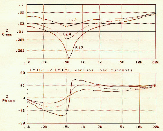

Now I wanted to see how this setup responds to load changes. Read 'em and weep below. What looks fairly nice at 13 mA becomes resonant again as the load current hits 50mA. (I labelled the bottom curve on the graph wrong, it should read 300 ohms). This is the same behavior as the resistor-only setup. Not good.
By contrast, the same test of the LM337 shows hardly any change with load in it's well-behaved curve.
So using the LM329 to lower the impedance at the adjust pin doesn't make enough of an improvement to justfy it. We still need a good, simple, positive regulator to mate with the LM337.
Output impedance below 0.05 ohm across the audio band looks pretty good to me and fairly close to: http://www.diyaudio.com/forums/showthread.php?postid=1826812#post1826812

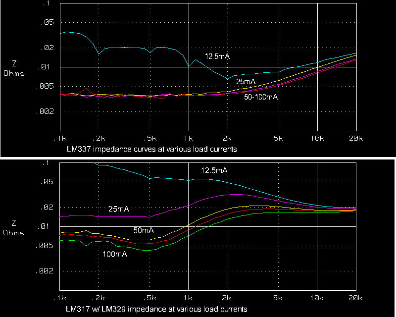

Look ma, new graphics. I'm porting the 4276A control program from the old HP computer to the PC, where it can generate GIF's directly as output, which makes web life easier. Still a couple loose ends to fix but it's pretty slick.
Below are a couple plots of impedance curves at various load currents. The LM337 is still by far the better of the two, and requires less load current to get it into it's stable region. And once there, it doesn't change, which is a good thing sound-wise. For the LM337, 25mA load current is fine.
The LM317 is a messier situation. It needs 50mA-100mA to get into a somewhat stable zone. But as the load goes beyond 100mA, that resonant notch at 500Hz crawls out of the woodwork. You can see it starting to form in the 100mA curve. By 150mA it is quite pronounced. So I certainly would not load it down more than 100mA, and would lean more toward the 50mA side so that dynamic current draws don't kick it into resonance. That makes things sound really thin, more so than it does already.
When the high-frequency impedance is stable while everything below it drops, I think that creates the voltage spike on the rails that okapi demonstrated in one of his experiments. And if your circuit's PSRR is worse at high freq's (aren't they all?), that gives things that "solid-state" sound that tube lovers enjoy rubbing in our noses at every chance.

jbau the results you are posting look great.
i see you are still using the lm329 with the lm337.
i assume you still have 1500uF or so as the output cap?
have you tried the lm329 with the negative regulator?
i can send you an LT1085 if you like.

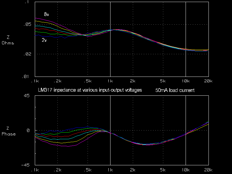

Now here are some VERY interesting LM317 impedance sweeps, varying the input-to-output voltage differential. This should put to rest some previous speculation about this. The steps were 8V, 6.5, 5, 4, 3, and 2V. Voltage was changed by putting an autotransformer in the line and varying the AC voltage to the transformer, so no circuitry around the regulator was changed.
As you can see the i/o voltage has a very well-defined affect on the output impedance around and below the critical resonance zone. This gives us yet another ingredient to optimize the output of this regulator. Optimum zone is in the 2 to 4 volts range.
An interesting angle to this is how this will change the sound of your system when your AC line voltage changes. As it goes up, the bass will get emphasized at the expense of the mids.

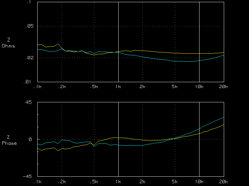

Below is the overlapped impedance plots of the optimized LM317 and 337.
