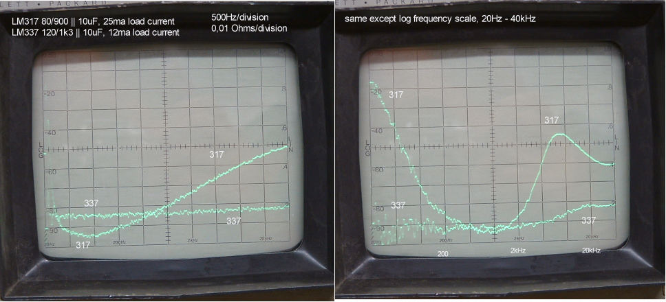

Well I shorted out a 317 by accident and had to replace it so I got to look at another Nat Semi 317. At least they are pretty consistent...
The bad news is, I could find no combination of set resistors, adjust cap, or load cap that makes the 317 impedance anywhere near as linear as the 337. I changed the measurement setup a bit to get better resolution at the low impedances, so these displays are 0 to 0.1 ohms full scale now. See the left pic. Lower values in the set resistors do help the 317, the lowest I tried was 80/900 || 10uF. Increasing the idle load current also helps it, shown with 25mA. The 337 did not change much with 25mA load current so I left it as it was.
Also see the right pic which shows the same measurement on a log frequency scale, to 40kHz. The 337 Z curve is very nice, below 0.02 Ohms throught the audio band. The Nat Semi 317 peaks at 0.055 ohms at about 7kHz, higher than the old Motorola part but still pretty nonlinear.

The impedance curve you obtain for the LM337 is quite surprising. That device has a gain setting that falls at 6dB per octave starting at about 100hz. I just don't understand how it is possible to get a flat response up to 20khz. I have used a similar negative regulator (LT1033) and see an output impedance profile that matched what you see with the 317 not the 337. Is it possible that there is an error in how the device is being tested?
Pull the load current up to 100mA and watch what happens.

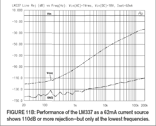

Salas said:No, cant be wrong. Jung has tested it with same bad findings.
I've got: Regulators for high performance audio by Walt Jung (part 2) in front of me. Figures 18a and 18b show output impedance rising around 10khz for 317 and 2khz for the 337.
i have never seen a flat output impedance curve up to 20khz from a 337, as jbau is reporting.
EDIT,i had the incorrect fig#s

jbau said:okapi: There is no error, the only change for measurement of + and - output is the polarity of the output cap. I would be cautious with your results using a broadband voltmeter to measure the signal levels at issue here. Resolving a signal at or below -120dBV in the presence of noise with a broadband meter is questionable.
Noise can definitely obscure the measurement and you have to tweak the set up to be able to resolve very low output impedances. Nevertheless, the method can easily resolve the rising impedance slope that i have seen on LT1033 regulators and Jung has reported in LM337 regs.

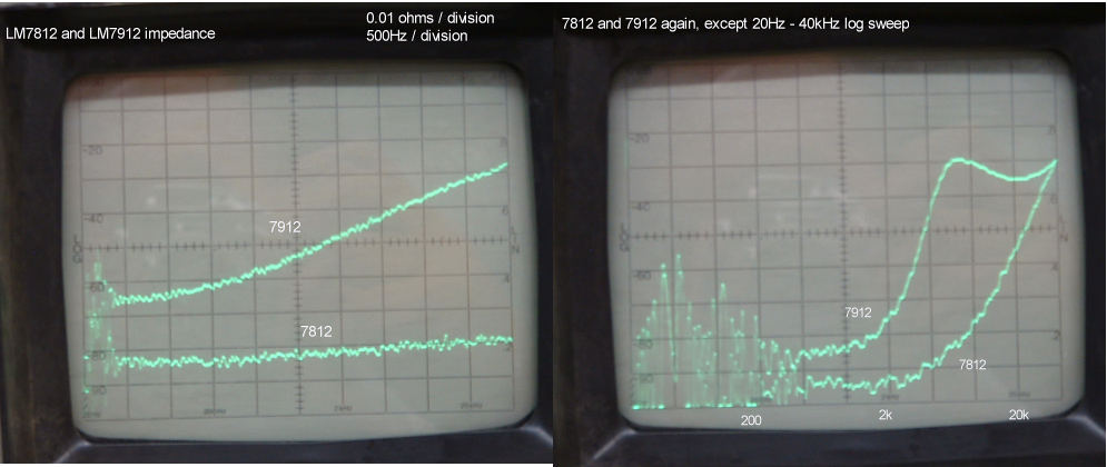

While I'm set up for measuring this, I thought it would be useful to look at the rails of one of the units I will be modding. It has 7812 and 7912 regulators, static load is 7 dual opamps plus four 5-volt regulators draw from it as well (3 from the +, one from the -). So load idle load current is certainly above the 25mA. I can't see the mfr of these IC's, they are buried behind the filter caps.
See the pics, same setup as yesterday, with 0.01 ohms per division. First pic DC-5kHz, followed by the 20Hz-40kHz log sweep. The 7912 is the worse performer in this duo. The 7812 is respectably good up to 4-5 kHz before it rises. The 7912 is higher overall and resonates at about 7kHz. Notice also that both units get better as they warm up, the right pic was made 10 minutes after the first and the baseline impedance had fallen quite a bit. (Now we have a measurement that shows why things sound better when they warm up.)
The LM7812 and LM337 results are the most similar of all those encountered. So to test my theory, I am going to optimize a pair using LM337 for the negative and LM7815 for the positive, install in the Sony dac, sweep again to make sure the curves match, and do some listening. Should be interesting.
Sorry, I mixed jbau 317 rising plot. Yes you are right. Mysterious. Here it is from Jung as CCS.
Salas, the graph of Jung's you posted is of ripple rejection, not output impedance. That said, I agree, the LM337 high-freq measurement result doesn't make sense. That the filter shape didn't trace down from DC is suspect too. I'll have to look into it.
