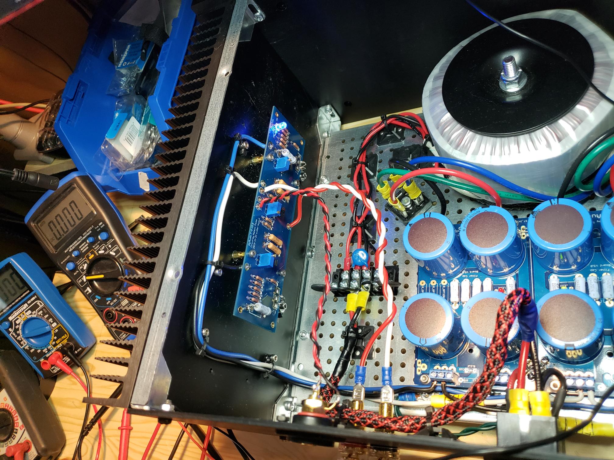

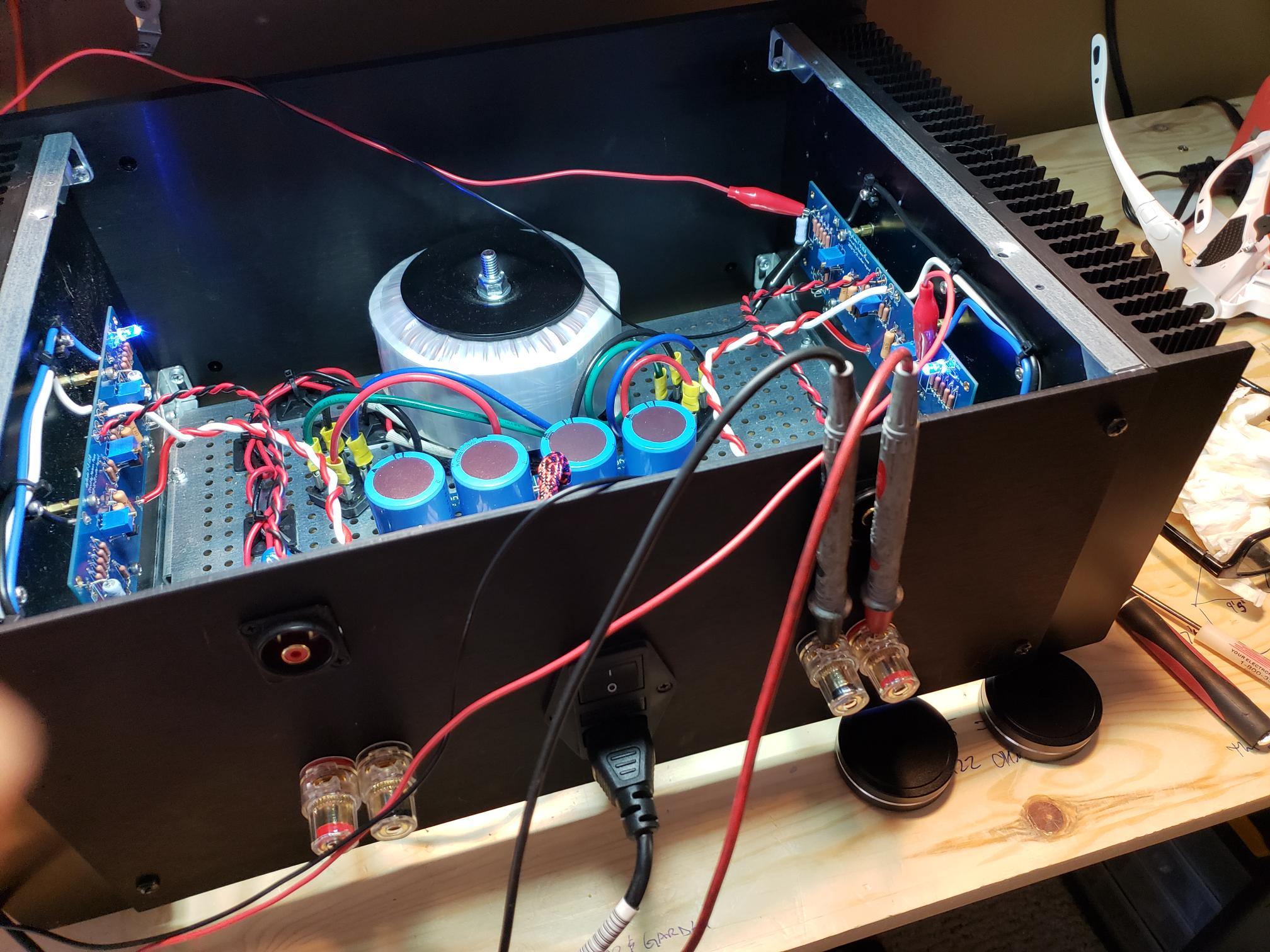

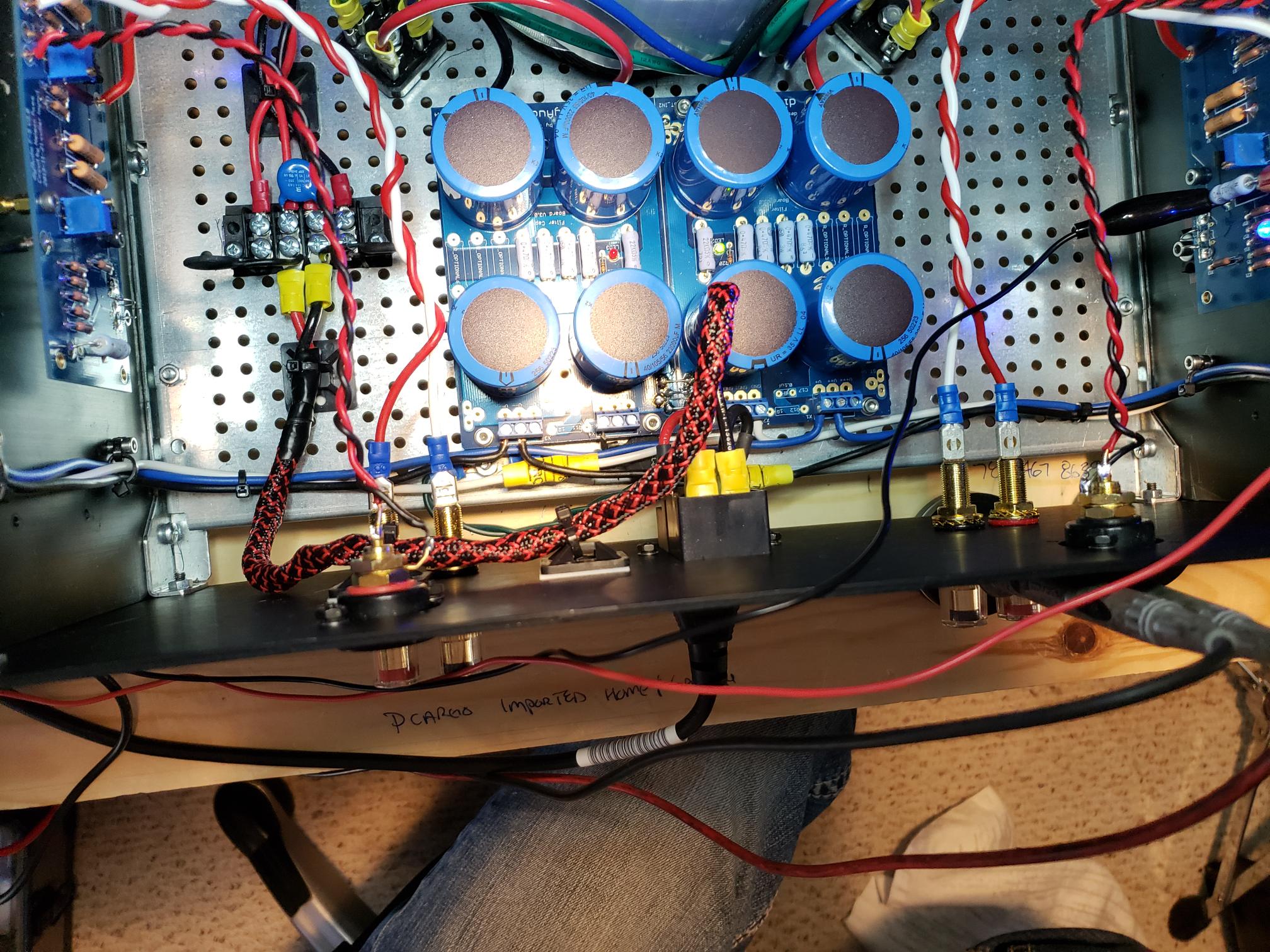

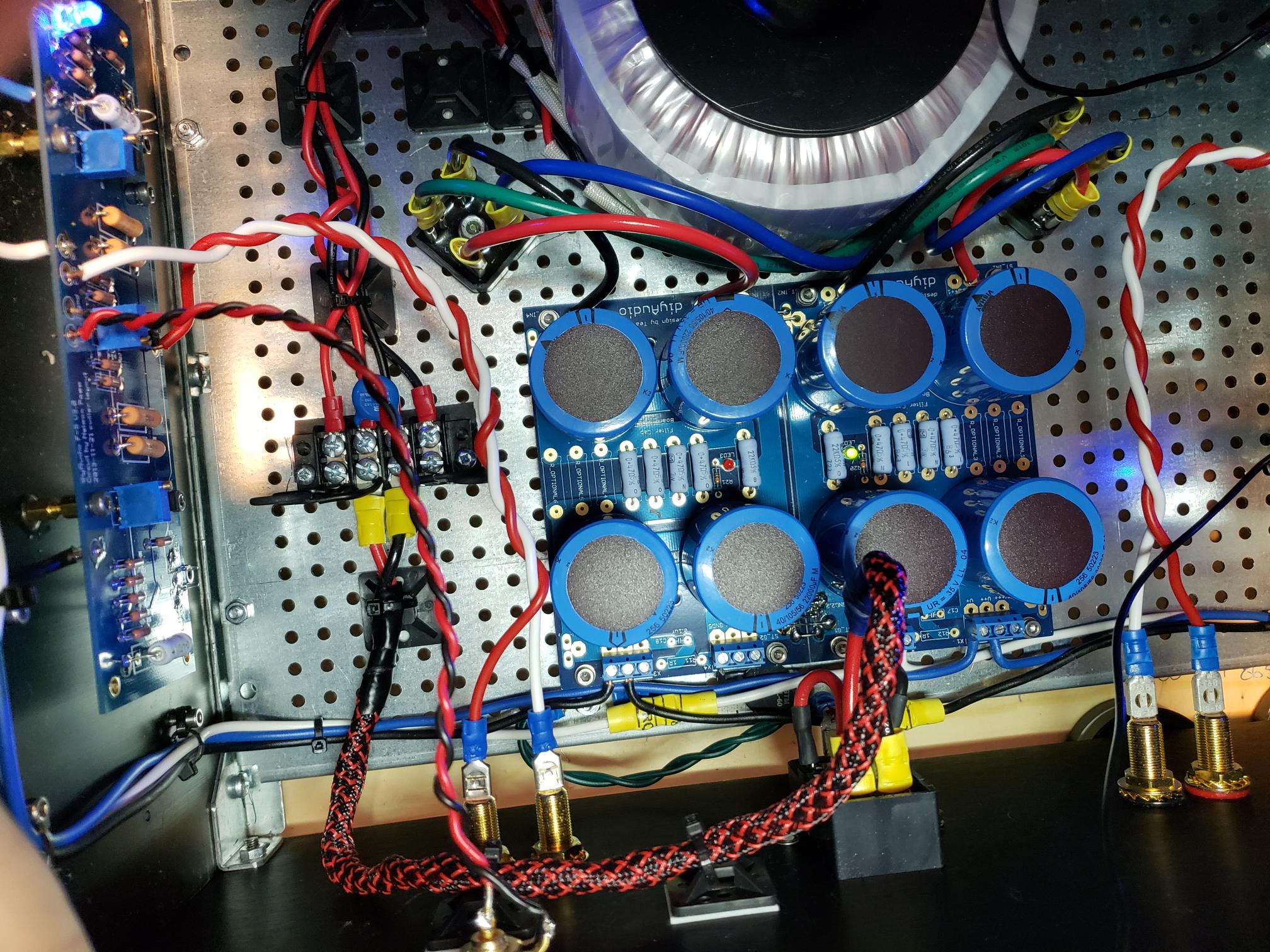

So yet again I seem to be having an issue. I have hooked up the left channel exactly as I had the right channel but I am getting no readings from R7 or 8. Nor is the speaker terminal value changing. The LED is on, and I have +22 ish between V+ and GND and -22 ish between V- and GND. turning either trim pot nets me no changes anywhere. I have turned each 10 full turns without any of the DMMs responding and I don't want to go further.
Gads.
When I finally get this sucker going, this whole post is going to be a gold mine of what to watch out for.....
Advice on trouble shooting?
Dave
Gads.
Dave
I have checked that R5 and R6 are changing as they are supposed to and had them zeroed out before starting.
What voltages are you seeing across R5 /R6? They need probably to be over 3.5V
before you will see voltage across R7/R8
