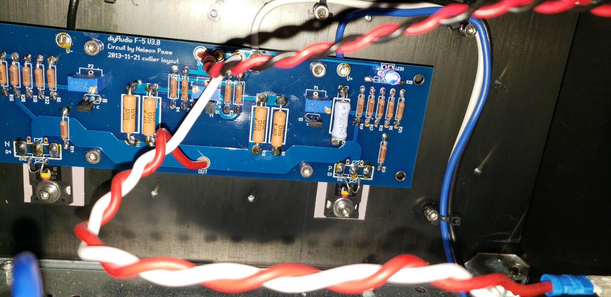

I spent a couple of hours this afternoon going over where I left off: I powered up and checked the Right channel: R7 is .598dcv, R8 is .592dcv and the speaker terminal is .01dcv.
I zeroed out the pots again for the left channel (down to .2 ohm) and started over but as before, there is never any change at R7, 8, or the terminals. Dennis mentions I need 3.5v across R5 and 6 to get anything through to 7 or 8 but I get no voltages across 5 or 6 either, doesn't matter what I do with the pots.

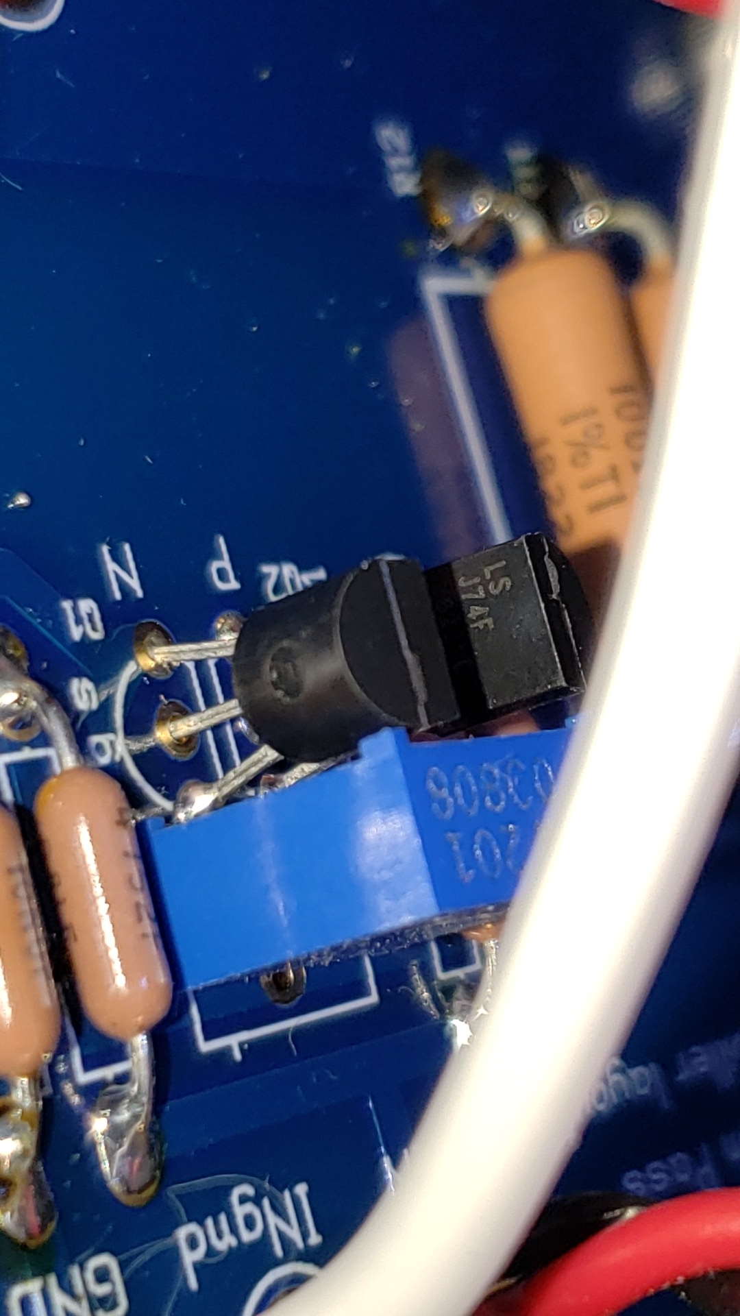

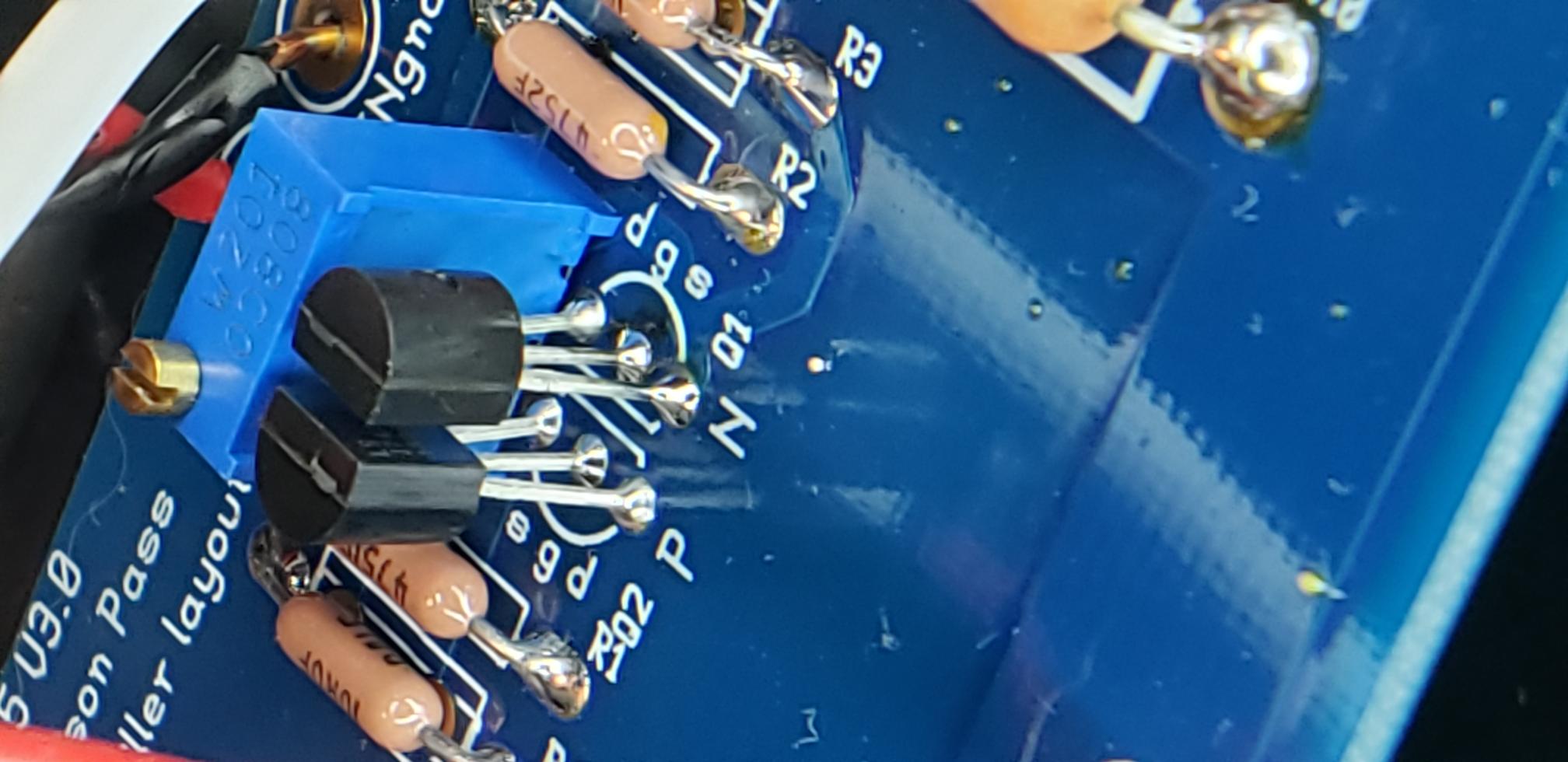

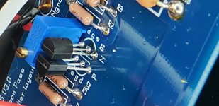

Try reflowing the JFET solder junctions. All of them should look like the D pin on your K170 (with the solder wicking up the pin). The S and G pins look a bit dodgy.
Hey Jeff. Okeedoee. I'll have to pull that side of the case off then. Back in a bit. Thx.
Check the resistance between the Source pin of the 2SJ74 and the ground on your power supply board.
Do the same between the Source pin of the 2SK170 and the ground on your PSU board.

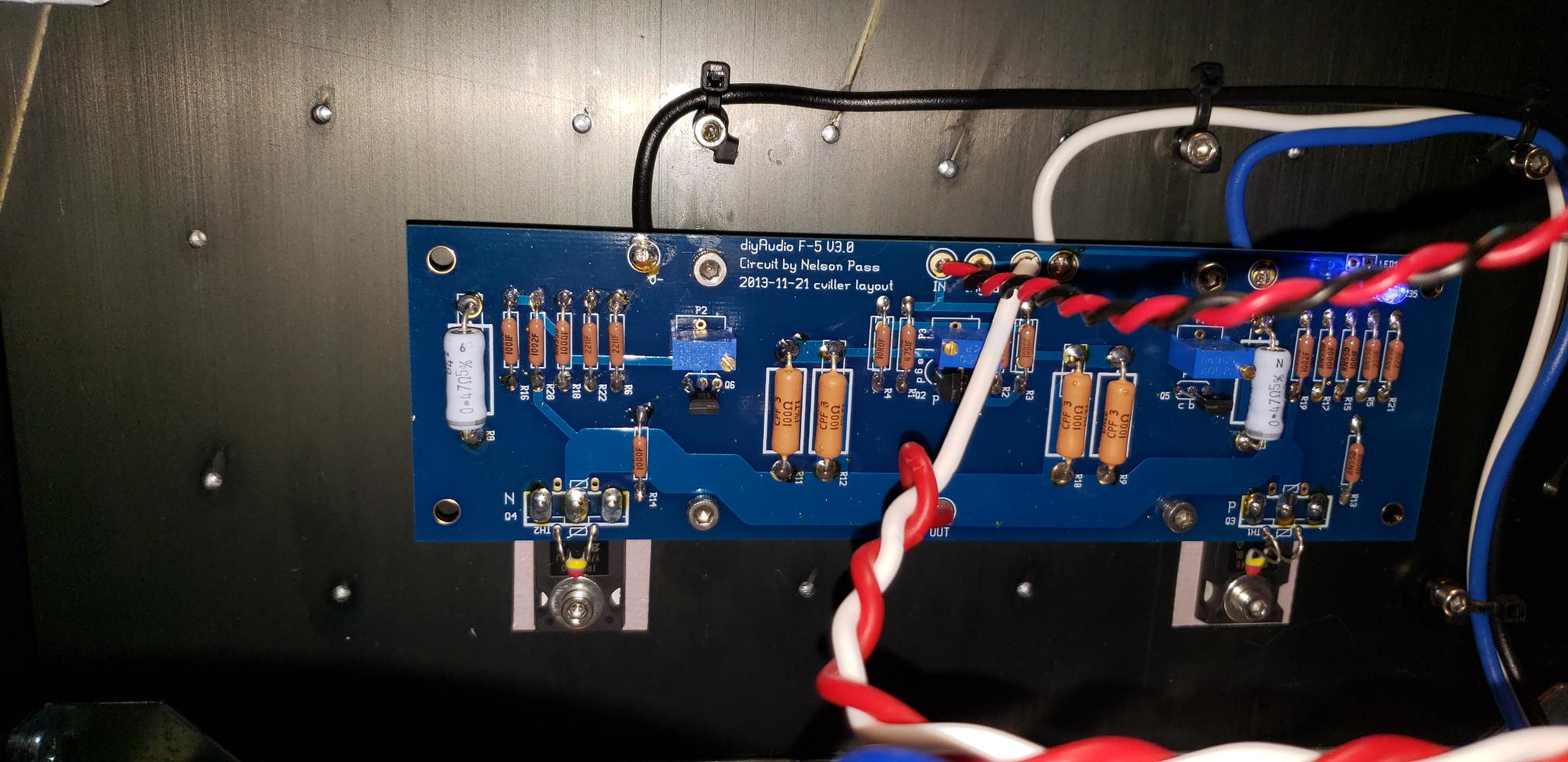

Your second picture shows you measuring the voltage across R5 and R6. Are those zero? If so, are both sides of R5 24V, and both sides of R6 -24V?
Can I assume the S leg is the Source pin? I have 15.2 ohms on the K170 & 9.0 ohms on the J74
And I am measuring voltages across R7 & 8 - they are zero. R7 is 22.7V off both sides and R8 is -22.7 off both sides.
