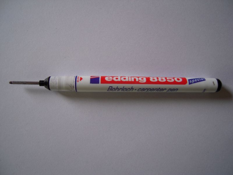

That's a pic of the EDDING 8850 CARPENTER PEN
with that extra long and thin tip to mark drilling holes.
