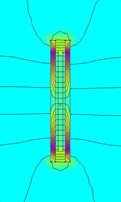

Hi ,here is a simmultion in femm 4.2.It dosen´t matter if polariety in the gabs are alike or reversed.
The dimensions are my idea´s ,if you want it i can make it from your dimensions
Fieldgab strength is app. 0.65 T.

Whats your opinion of this simulation
Very little field stray
But to me it also looks like the power stays in the iron, and not being very strong in the gap, shouldnt it at least be orange
Whats your experience when it looks like this
Wonder what would happen if there was a little airgap in the iron midpoint
Or maybe the gap should be at the other end, between the iron
But that would make constuction stability a bit difficult
Looking at below fig, yellow seems to be ok
Also, the little spread of the field, on each sides of the gap makes it possible to have 3 "strings" in each gap, with no need to have them on both sides of the diaphragm

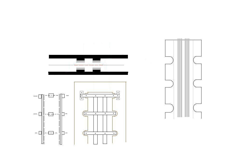

Hi again.
I cant tell, but it seems to be the draving thats wrong.
To me it seems that the iron is not sepperated in the middle, annyway here is my idea.
Fieldstrength is app. .55 T,i used ferite 10x20mm.
I have some ideas for the construction too.

Doesnt look better than original
But I also just got an idea to a change
I will make a drawing
My concern is also to achieve easy assembling, and maybe even less diffraction
Lets see where it goes 🙂
Which steel or iron is being used in these FEMM simulations?
Which magnets? (NdFeB40 ?)
Also, a FEMM question: How do you get FEMM to show that pop-up giving flux denisty at a particular point like that?
(I keep having to try and figure out "is this point mostly yellowish or orangish or greenish?" Not very precise at all.)

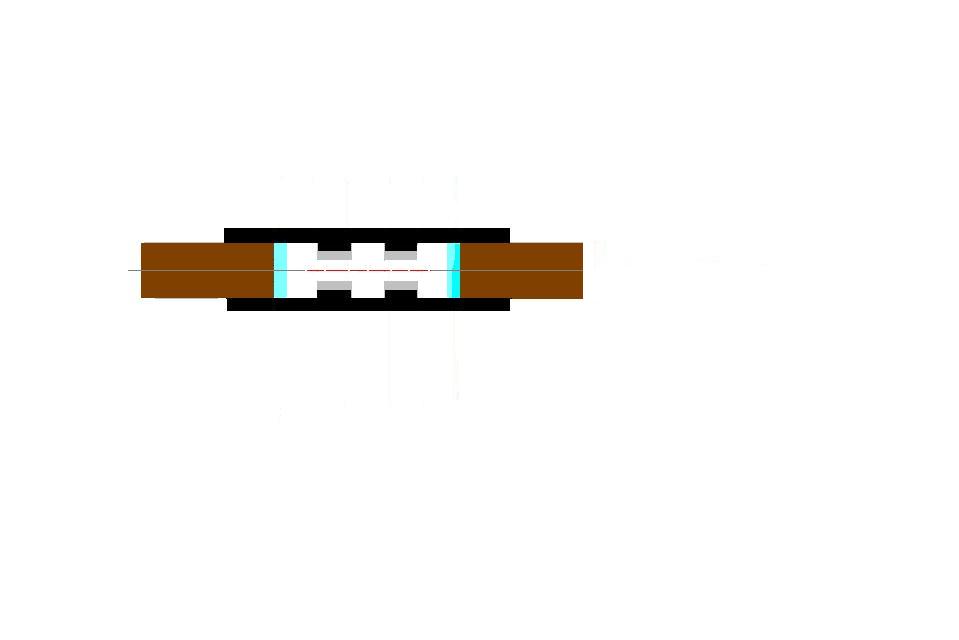

tinitus said:This might be the final version
Its easier to build/assemble, but still a tricky challenge
May need a small ribbon placed on top(10khz)

On my example you se in the window (B) 0,55T thets from the gab.
In the toolbox choose dot/point and plave the arrow where you want to "read" and clik.

båndsei said:In the toolbox choose dot/point and place the arrow where you want to "read" and click.
That's what I was trying to do and it never worked.
For me the problem was solved by going to the View menu and checking "Output Window." Then it was all working fine.

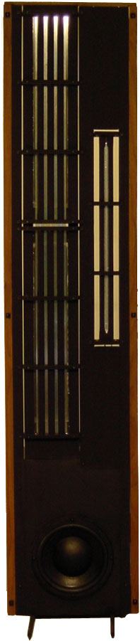

The first one, i build and the last one.Look in curved magnetostatic speaker,there is a picture of the last one.

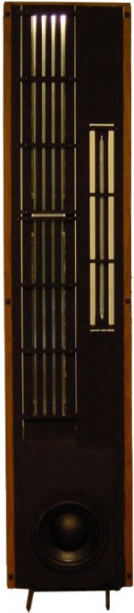

Bandsei ,
Could you describe it a bit for me ?
From the pics it looks planer magnetic . Are you saying it also has ribbon drivers ? are you using neo's?

Here is a close up.
It is planar and ribbon on the same "frame"
I use neos 10x6x70mm.
I think this belongs to the tread:curved magnetic speaker.

And everything possible should be done to free the planar of moving much
Fore that very reason I wont use it below 100hz, or maybe even cross it higher
Though the nice fullrange character of "bandsei" design really did give me high hopes
Whether the curved design has a say in this is unknown, and one can only speculate
Fore that reason I think I will leave the pushpull design alone
I fear the drawbacks are worse than whats gained
I will now focus on a planar with "FULLRANGE" character, to be used maybe 150-10khz
It may even be possible to have the diaphragm much closer to backmounted magnets instead
And a small true ribbon placed on top
Thanks again fore correcting this, before gotting out of hand
New project, or should I say, stick to the old
Or RUMANOID 😎
Though I thought the advantage of the rumanoid was tighter magnet gap, its also clear now that it can move a hell lot more, with no "touching" of magnets
Good luck guys 🙁
