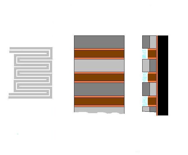

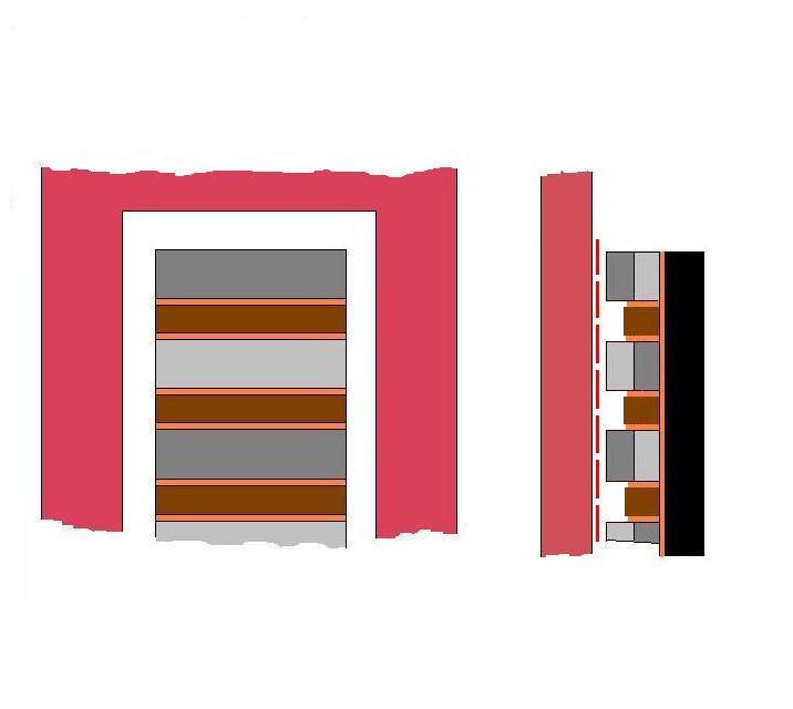

With 1/2" x 1/2" x ? magnets
They are easy to find
And it doesnt matter through which side they are magnetised
Very easy to make longer
And theres none of the usual strain on the iron
And as said, no glue needed
just about any width and length is possible
Apart from the sound it will be intersting how high the sensitivity will be

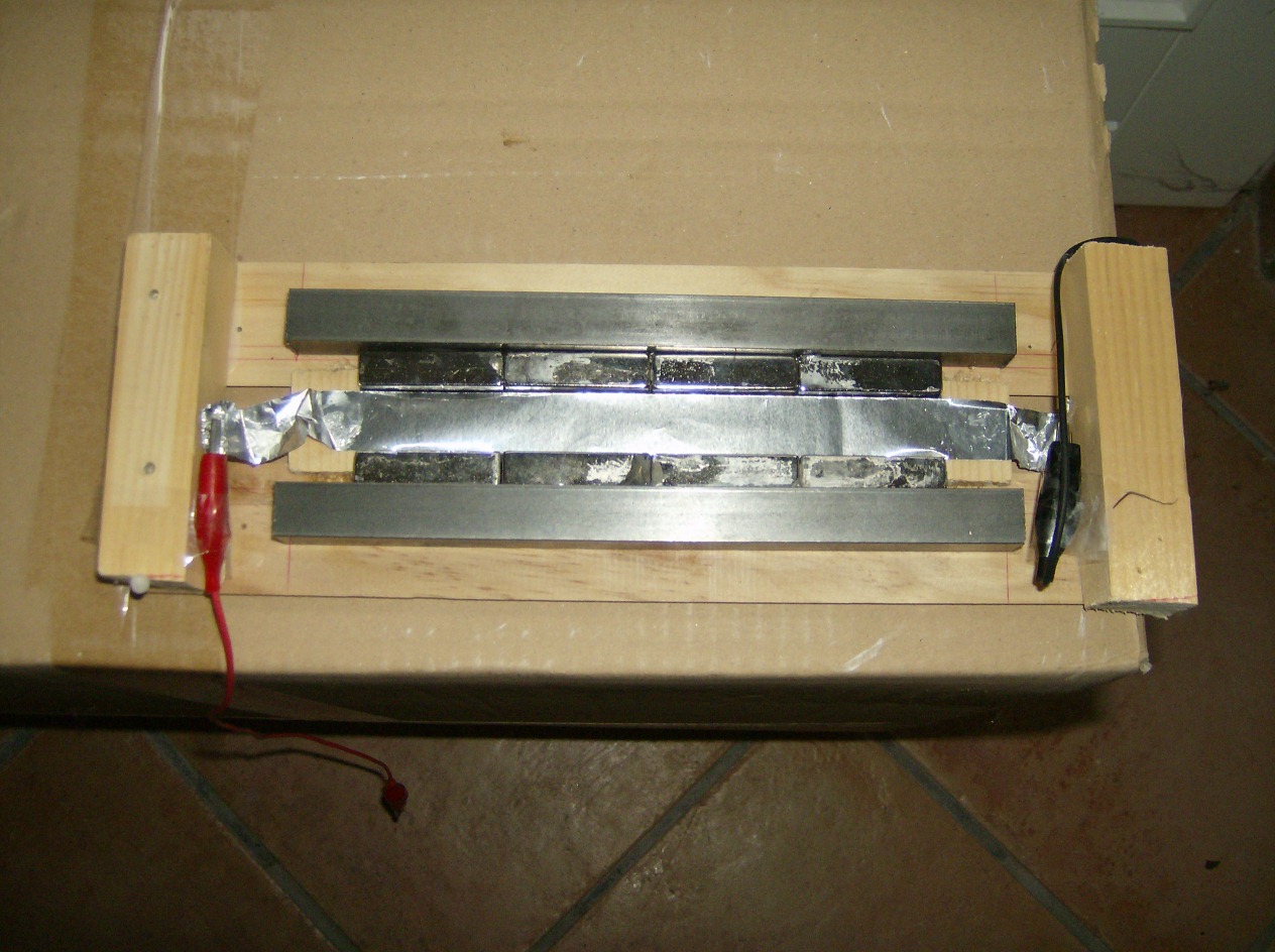

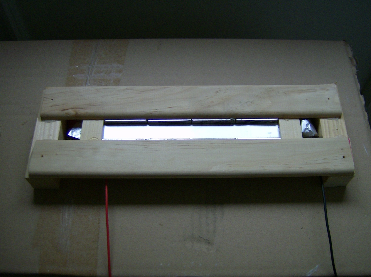

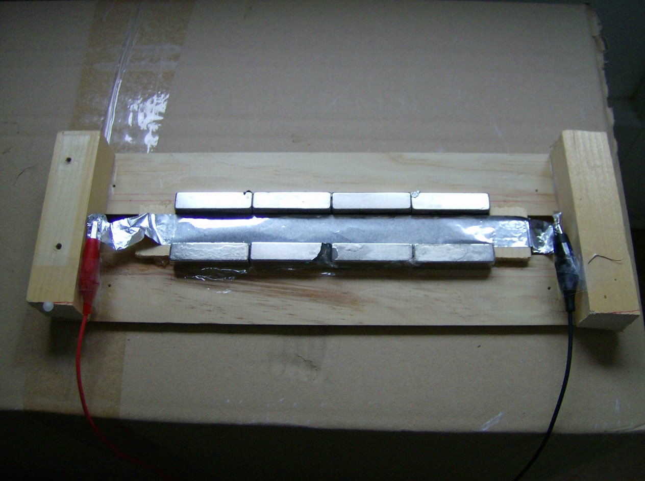

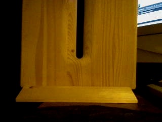

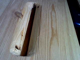

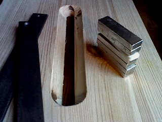

Pictures of my first ribbon tweeter
Here are the pictures of my first ribbon tweeter.
I have three versions:
1) without steel bars
2) two steel bars on the side of the magnets
3) four steel bars (loop).
Bruno
Bruno
