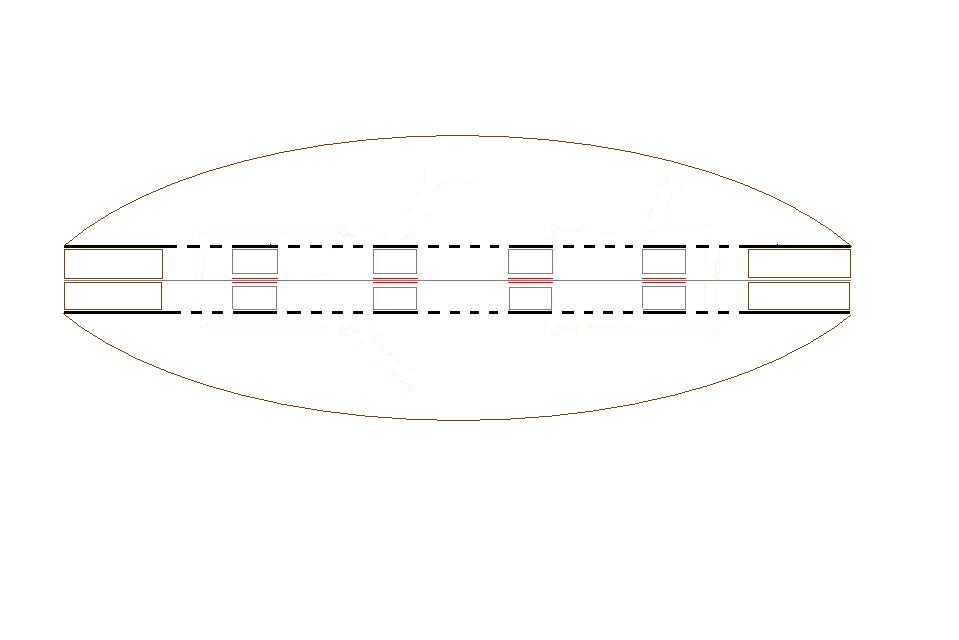

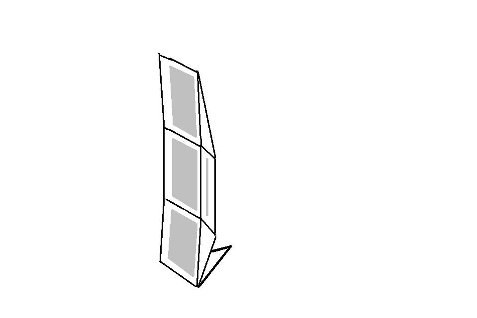

A midbass planar I would like to try 🙂
But theres a problem
I know how strong those magnets are, and Im pretty sure there could be problems with magnet clashing together :hot:
The build have to be very strong
Have to think about a solution
edit
Well, maybe solved
Or could be like this, to save on magnets and size...less work
Being smaller(narrow) it could be crossed higher
magnet "poleplates" would be made from maybe 5mm steel plate
Either a mate could have them lazer cut...or I would do it myself with drill and jigsaw, but a lot of work

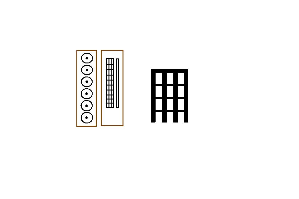

Yes very similar to what i had in mind ...🙂 ............except for the woofer tower
