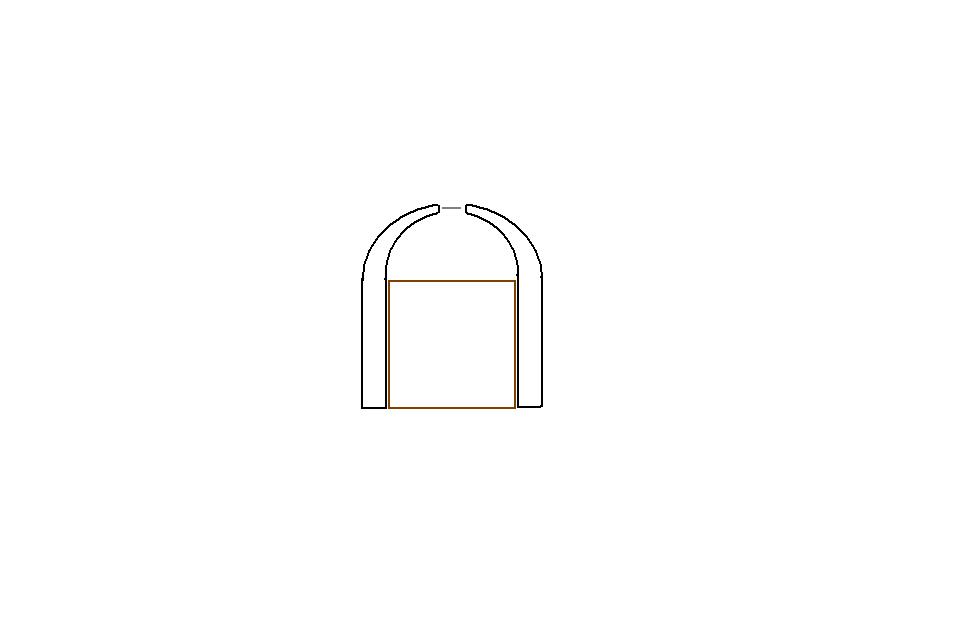

Sure, very positive ... look at the new RAVEN "point source"
To make a ribbon more effektive you can use VERY big magnets, AND lighter ribbon
With big magnets you need to use "poleplates"
I have "invented" this design ... but I guess you will find similar in commercial designs
You can use ceramic magnet and will only need ONE pr ribbon
It will take a while before I have time to build it, so you have my permission to try it first ... and to be honest, I am a bit scared of this magnet
This magnet measure 6x4x2 INCHES ... be very carefull, its dangerous, and I have no clew how to handle this "little thing" ... it would be more practical to assemble before magnetizing, but not possible in diy
