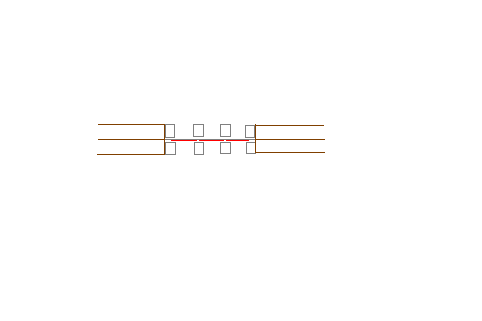

If you make the ribbon wider to use it at lower frequency, you will loose some sensitivity
And to get some of the lost sensitivity back, you make it longer
I would say the width should be 15-20mm wide (my own will be 15 x 250mm) - and might be used from 1000-10khz
What does it take to bring the ribbon to do down to 250hz?
Cheers
Ken
I would do it something like this - length between 1/2 to 1 meter
But you will need a smaller ribbon above 5-10khz, and impedance will still be low
And active crossover
In another thread "diy ribbon", "Andre´" has shown a long and narrow ribbon to be used down to 250hz - but the used very big NEO magnets are VERY expencive
Yeah, planars may be a better way to go. I won't have any comb filtering issues with a one-piece driver. Do you know of anyone who has built narrow planars? I would want something to cover from at least 500Hz to 20KHz without significant roll-off so Bohlender-Graebners don't fit the bill. Besides, those are PRICEY!!
A 3/4" wide and 60" long ribbon with heavy NEO magnets might get you down to 500hz with steep active xo, and will do 20khz too... but you will need a good choke fore impedanse
lets see ... looking at magnet 2x1x0.75in ...lets just say you will need at least 100 of those and they may cost around 30USD each at magnetman ... well those are best N50 quality... I hope they can be bought cheaper elsewhere
Another one...1x0.75x0.5in/N45 5USD each ... you will roughly need 200 = 1000USD
If you order a large quantity directly from hongkong or whatever, you might do better, or get larger magnet at the same price
VERY expencive if it fails:hot:
Another thing is that those large neo magnets can be quite dangerous/tricky to handle
I would say, build some smaller ones, and learn how to do it best before the big adventure😉
