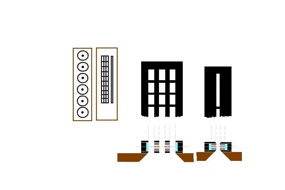

a.wayne said:
Yes very similar to what i had in mind ...🙂 ............except for the woofer tower
Yeah, woofer array was just fore looks 😀
I have been working on the idea
And done some cost calculations, and Im afraid neo magnets gets quite expencive
On the other hand, if it works it will be very hard to beat
I have magnets fore some small ribbons, though they will need transformers
To me, fore this to make sense, it should be done with no transformers, so only bigger will do
Still, I fear some difficulties in assembling such pushpull planar units
Magnets are very strong, and I have experienced that they could bent a 3x20mm metal bar...sidewards
Though, due to the push-pull the magnets may not need to be so big(thick)
Also, the design I have worked on here, uses a "not loaded" part of the diaphragm as the active part, and you could almost call it an Linesource-Manger
There may be ressonance issues
But it may depend a lot on diaphragm material...some use very thin "Japan-paper"...you know, like the paper used fore model airplanes
Its really tempting to try and do it 😎
Yes, I also figure about 10mm gap
Delrin bars instead of metal might make it much easier to assemble
Though, metal bars is part of the magnet system, but may not be important...so your right that it could work ok without the metal "pole"connection
Dont know how to simulate this thing 😡

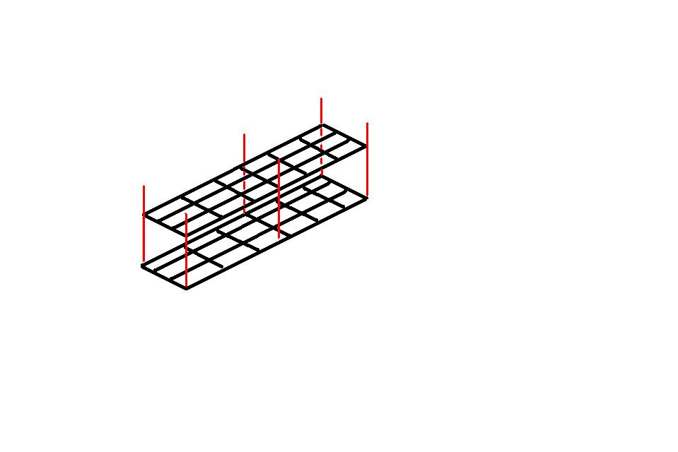

I may have solved some of he difficulties fore assembling my planars, so that magnets doesnt take control over the process
You see the 2 halfs ready to be joined together
Red lines are threaded rods
Looking at picture, there are threads fore the rods in the "top" section, and the rods are standing against the "bottom" section, so that they dont clash together
Bit by bit I may be able to put them together by turning the threaded rods
During "assembling" I may also use a MDF box to control any sidewards movement
I think its possible

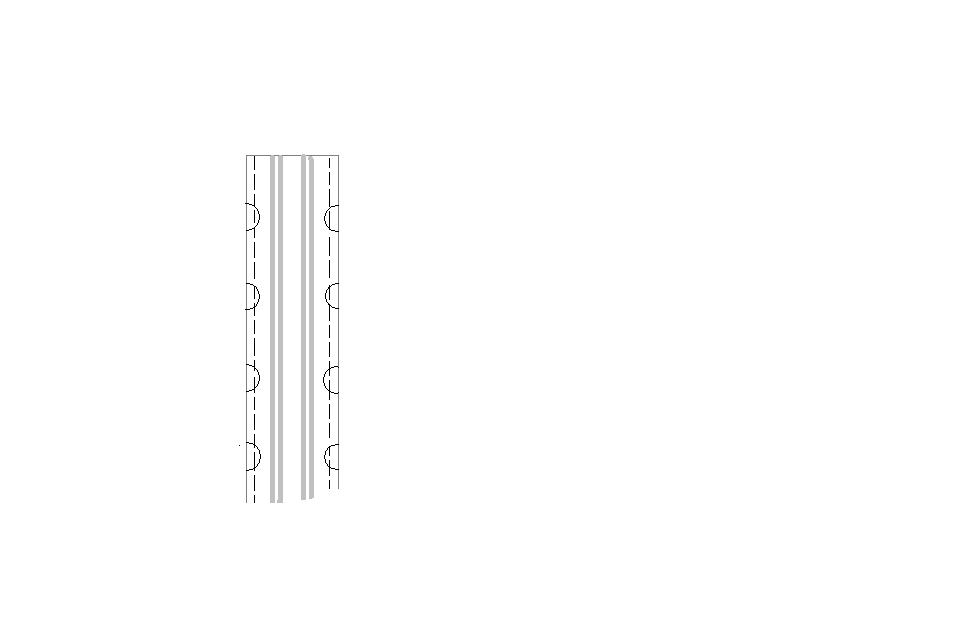

Think about doing half circular "cuts" along the sides of diaphragm, changing the ressonance issues, but in what way I dont know
When I looked at it, I was reminded of Thiel/Accuton 🙄
Beginning to think that it may be best to just do a tweeter/mid planar, and let the rest be done by ordinary woofers as I think they will be needed anyway

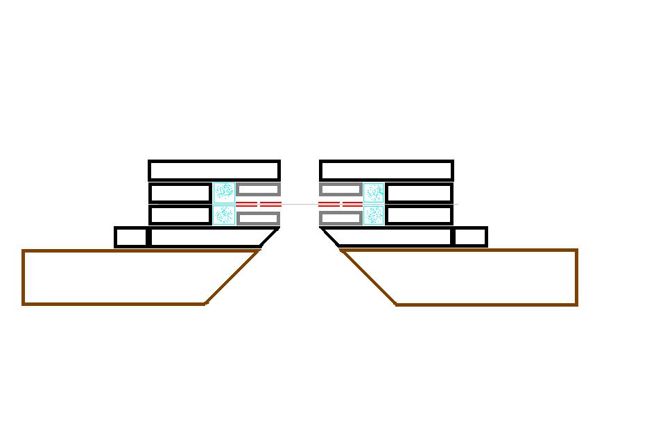

Push pull planer for bass , midbass. 😀
Standard ribbon midrange -high frequencies..........................
Maybe 😀
With N45-52 neos and pushpull...might result in very good sensitivity 😉
And the one I show could have reversed polarity, to make cable connections short
Found a nice one at Applied Magnets
http://www.magnet4less.com/product_info.php?cPath=1_5&products_id=673
Expencive, but theres a N42 with same size, which is pretty nice too
And its heavy, so costly shipping too
Hard to imagine the power of such a magnet gap
The N52 pulls 20kilo, and the N42 pulls 15kilo
Also, with foil on both sides of diaphragm theres lots of "signal" positioned in the gap, which is very good fore efficiensy
But I might talk to a danish company about magnets without nikkel plating, which I would expect to better...direct contact between magnets and poles, and might be cheaper too

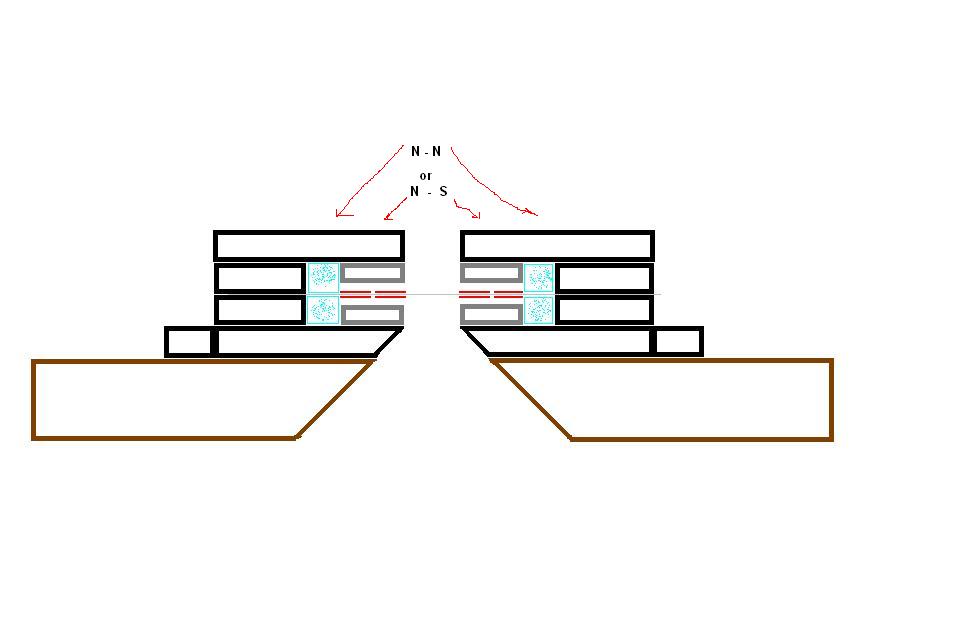

I wish I could
But sure, I would like to know what difference it makes if I reverse polarity on "left/rigt" magnetsystem in the planar I show
Reversed with N-S would be convenient, so that connections will be nice short and easy, right
I suppose the N - N configuration will look better on sims, but question is HOW much worse "field-stray" there would be with a N - S
Please note that it consists of two independant magnetsystems, one on each side of visible diaphragm
And I do know that theres a lot of diffraction issues with this design, but sensitivity and control is first priority
Any suggestion to the field stray issue ?
Dont know why thought that
The desired "N - S", left to right, logically appear to be the better one, in terms of "field-stray"...longer path, if it matter at all
But no doubt, field-stray there will be, which could be the achilles heel of this 🙄
Sorry guys, Im confused and posting too much, and confusing you as well
But it seem my head is spinning
Ofcourse I was right in the first place
The one with "reversed" polarity N - S, which I want, really is the one that may have the worst stray-field issues...what else
But probably nothing much to worry about
