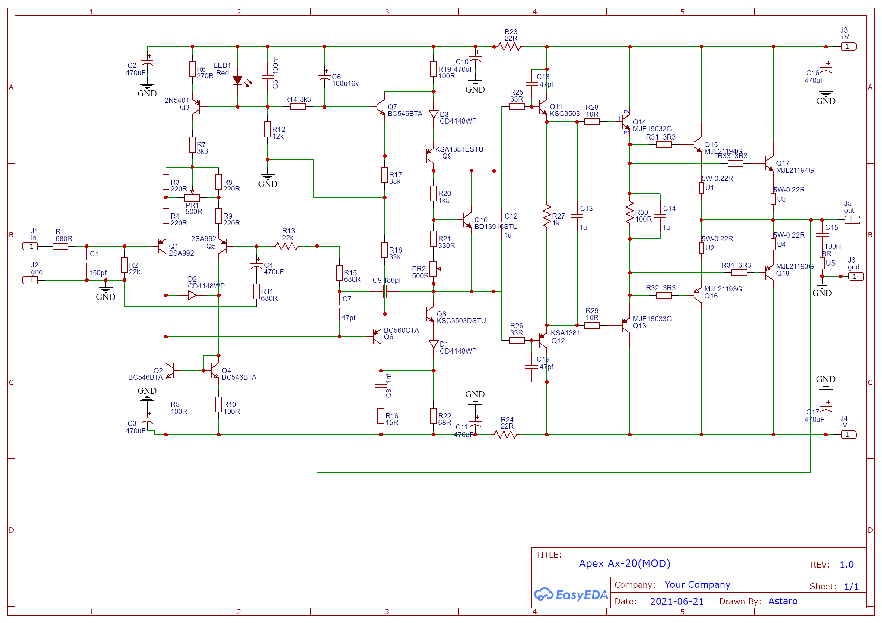

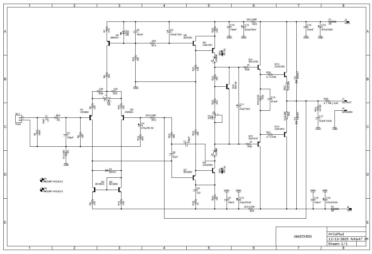

You once made a Super Apex-16. Tell me, if I redo the Apex-20 according to your scheme, will everything work fine?
Are there any other improvements or edits possible?

MJL21194 has fT only 4Mhz. You should check your simulation, because MJL21194 can not work with high slew rate. If your amplifier's slew rate is high, better to use MJL3281A https://www.onsemi.com/pdf/datasheet/mjl3281a-d.pdf
I do not know how to use the simulator program yet. that's why I wrote here, I thought you would do it
