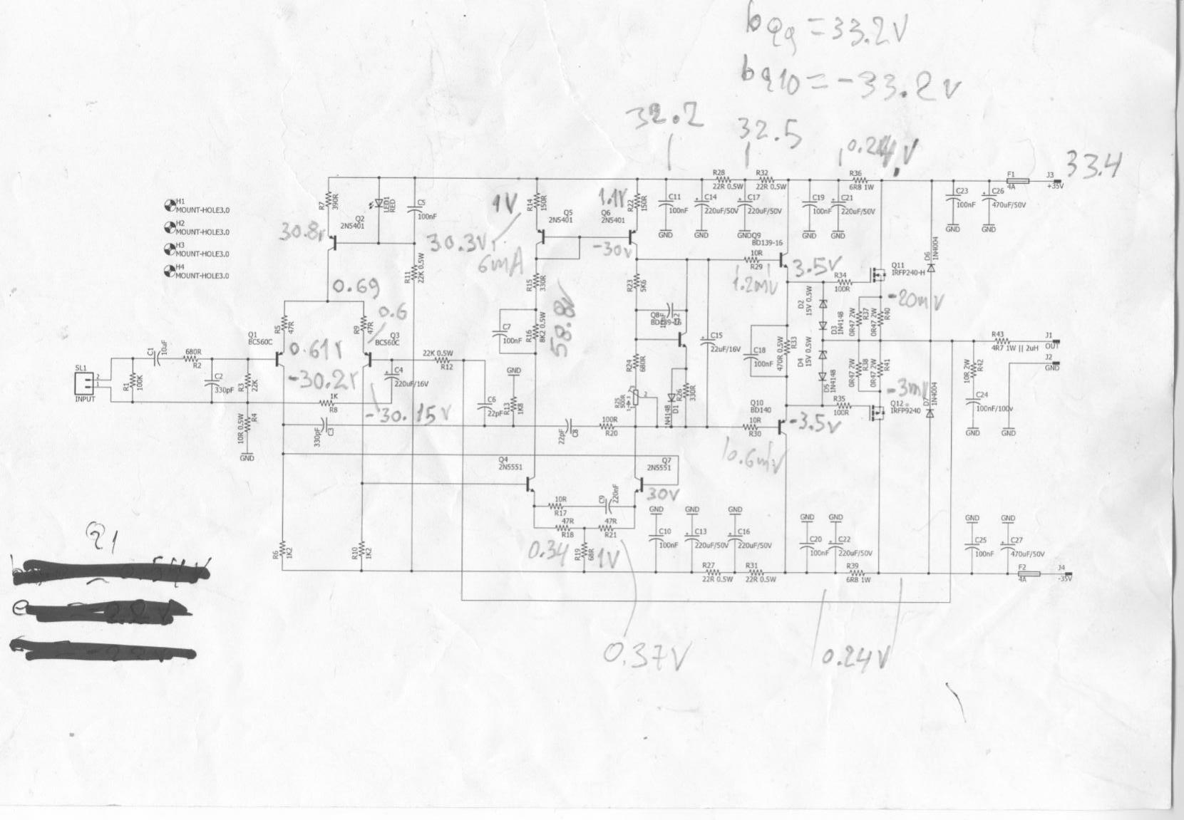

I will post the circuit diagram as built and measurements for easy troubleshooting if any interesting...

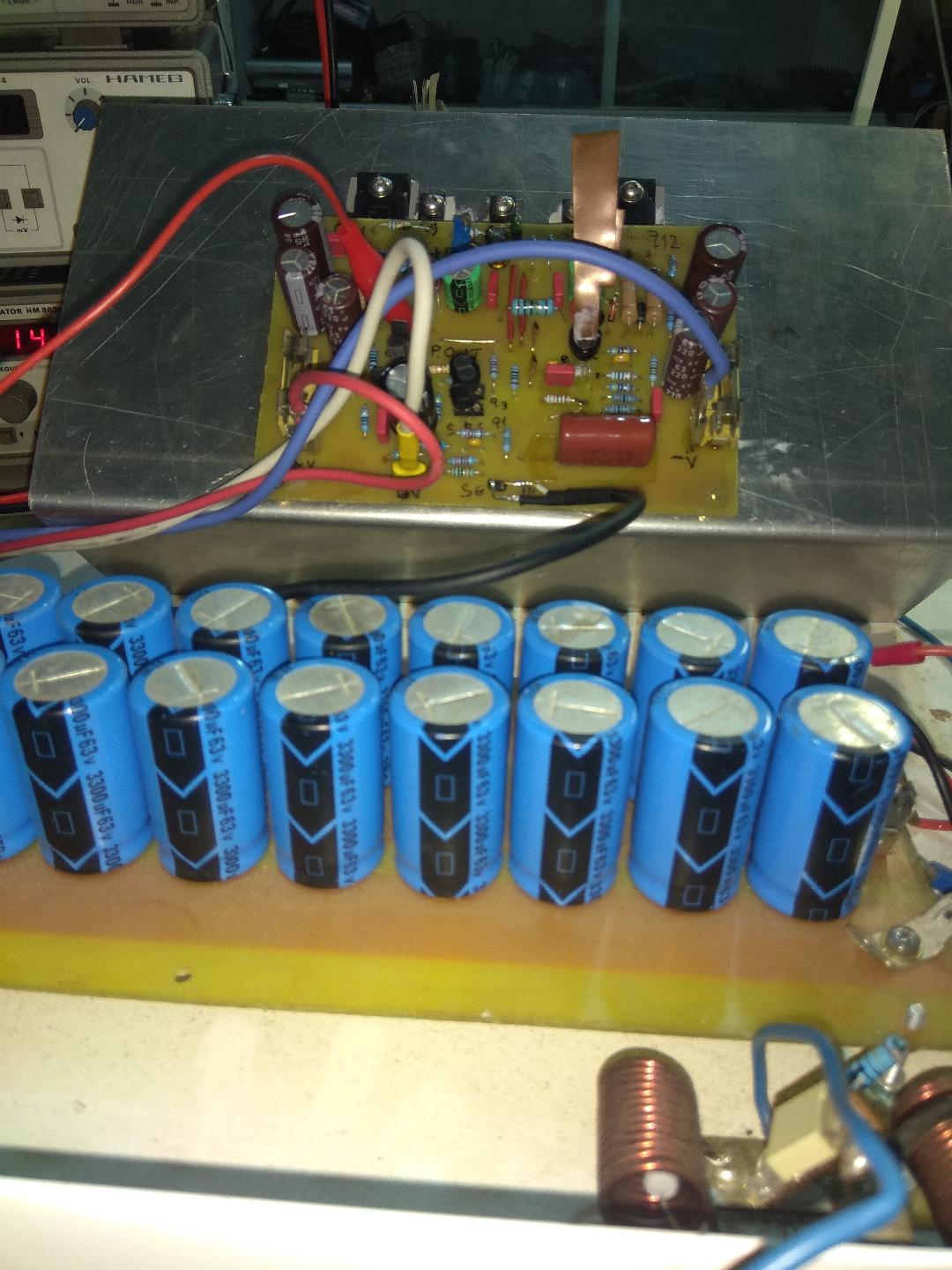

Yes,it is absolutely necessary to increase pads diameter.Is tis your first job done with PCB ?
I did a lot of work with PCB yours is great ... but try to reduce the diameter of the holes in the copper foil .... as small as you can only to give a center to start the drill bit, then you will keep as much copper as possible ... soldering will be easier and stronger.

I find it weird and counterintuitive that the thermal sensor is a mid power transistor (BD139) but power transistor drivers are flimsy TO92 low current transistors such as 2N5401/5551 , quite unsuitable for the task.

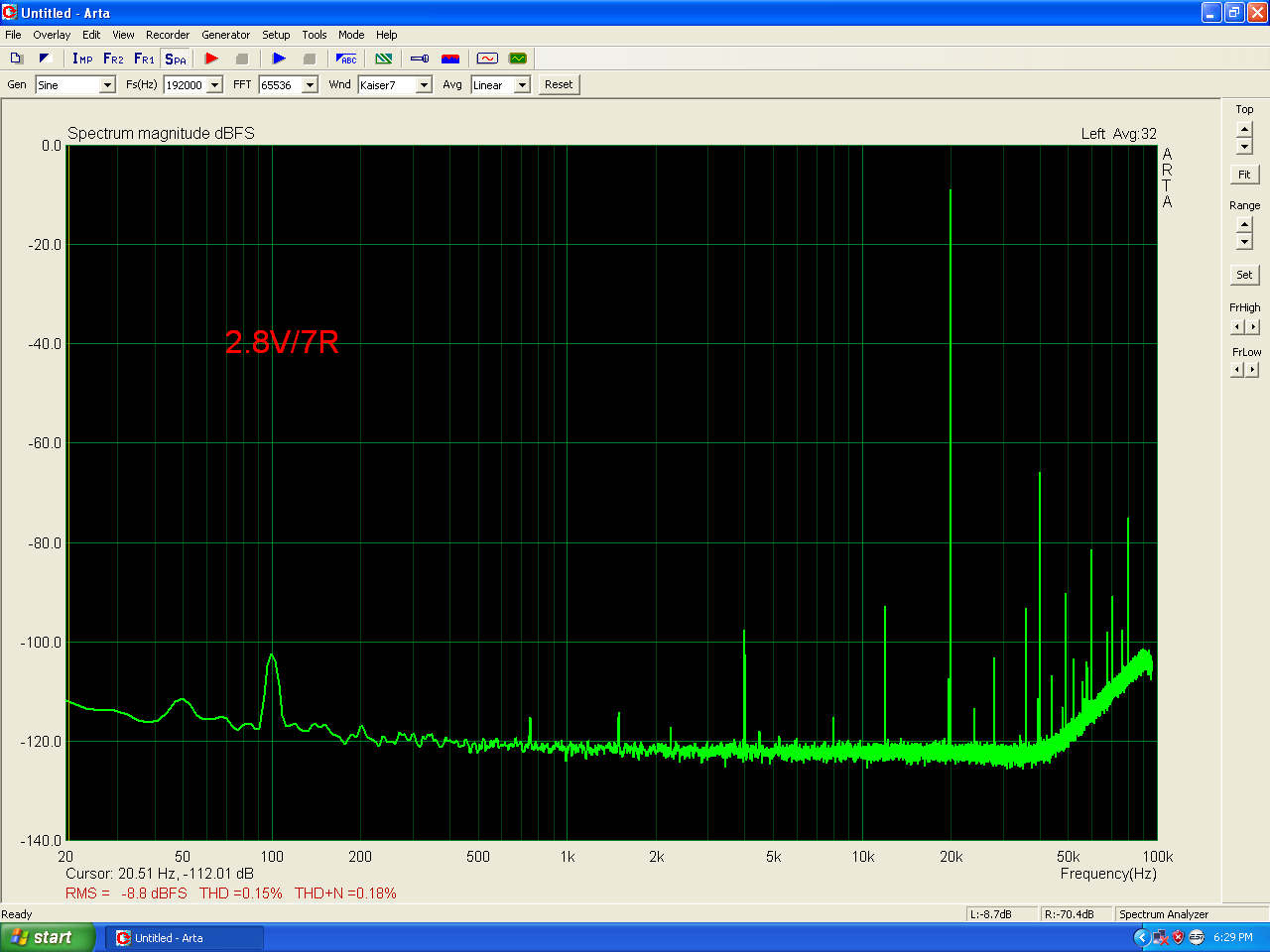

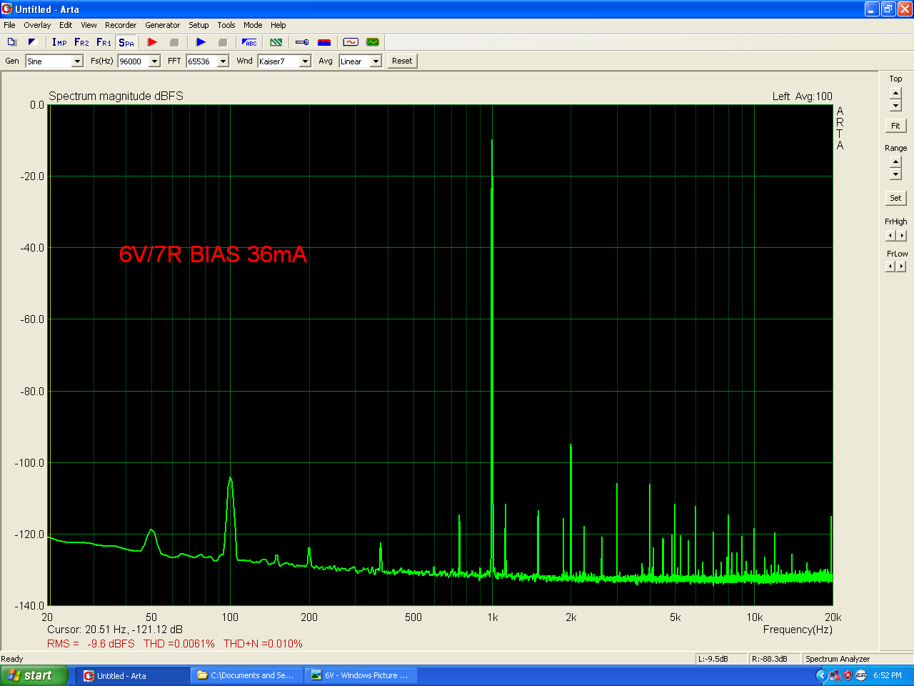

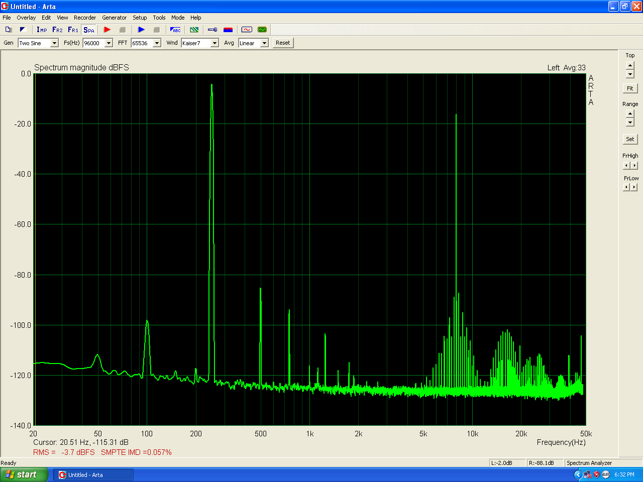

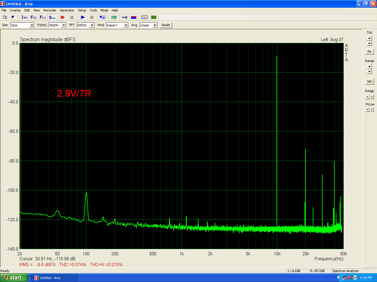

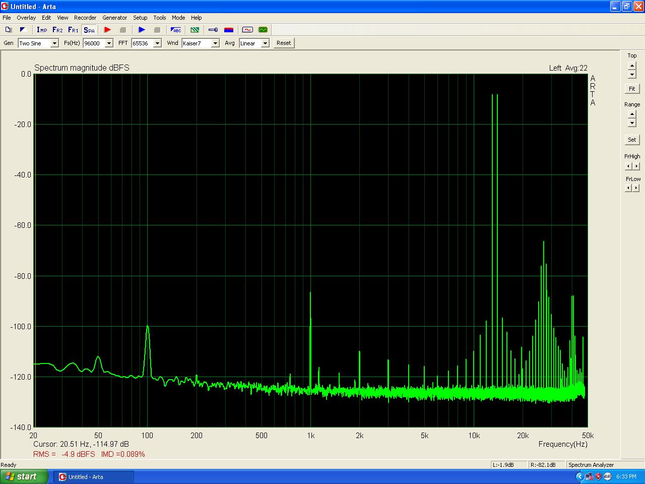

I want to see FFT of low level ex. at 1W/8Ohm and high level near clipping.
I found in simulation, OITPC compensation always make harmonic profile almost monotonic at low level, and sometime at high level too.

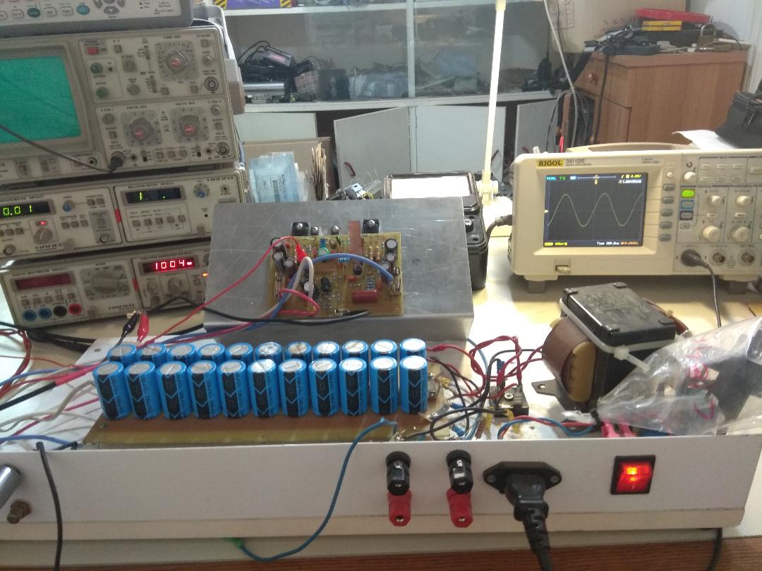

As built measurments
Here are measurments for easy troubleshooting.
Power Supply=+/-33v
Bias=20mA
Offset=3mV.
Sensivity.input signal=700mv Out=15.7v just before clip.
gain =22
Power out=35W RMS/7 ohm.
Power Supply=+/-33v
Bias=20mA
Offset=3mV.
gain =22

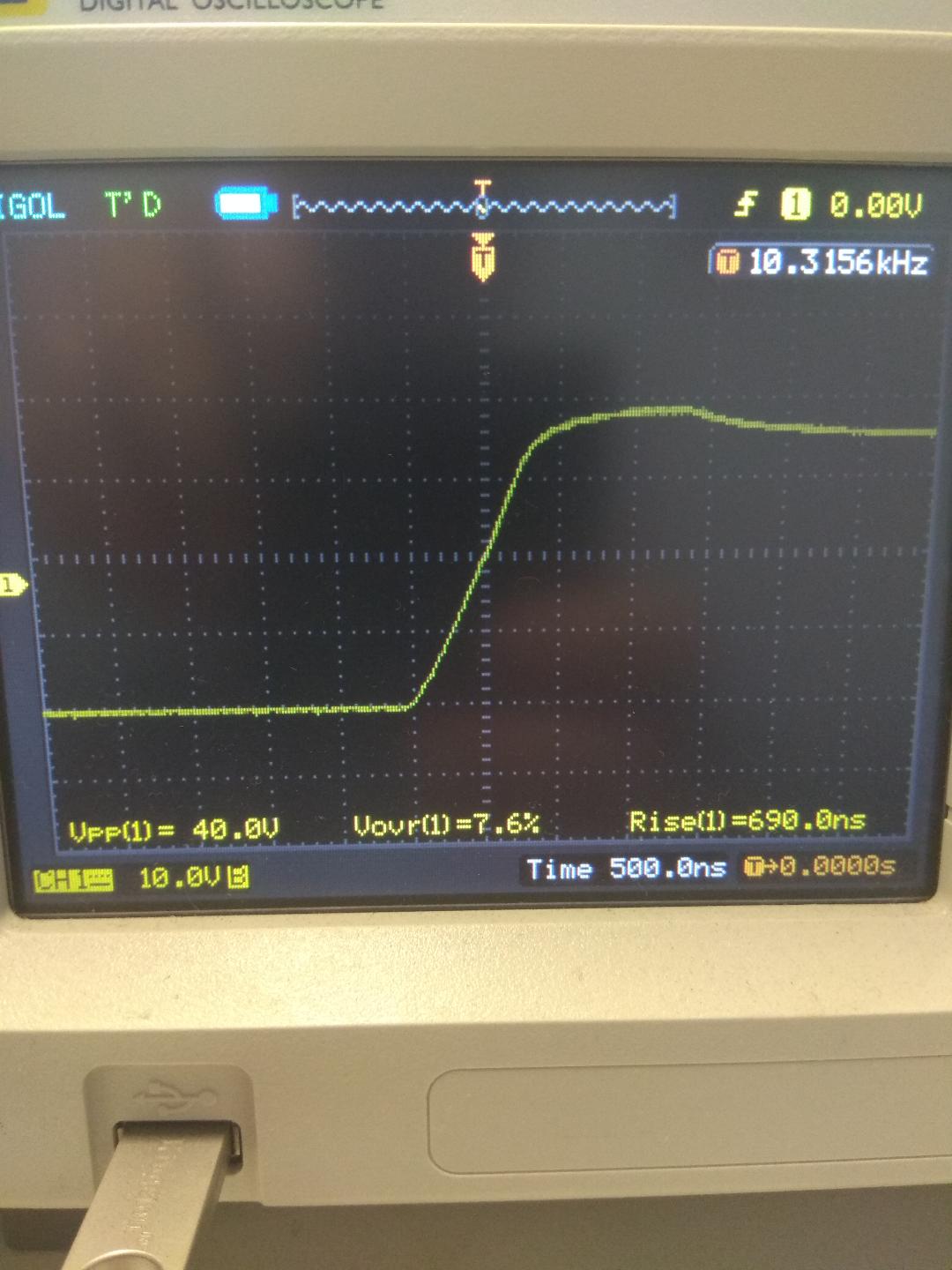

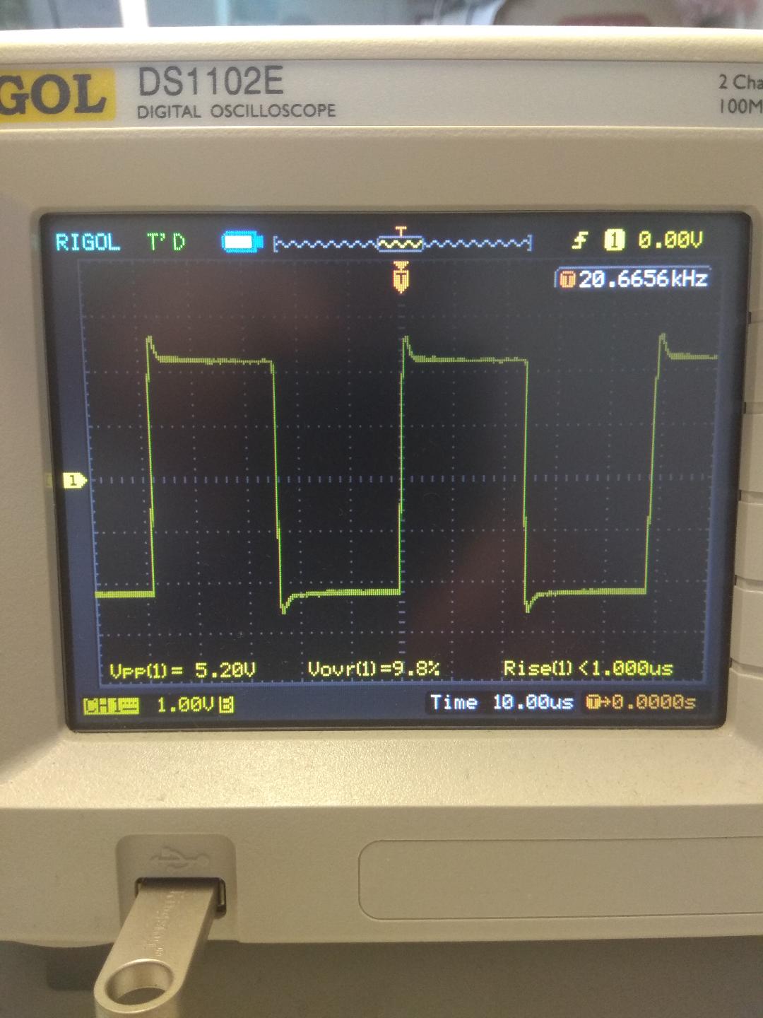

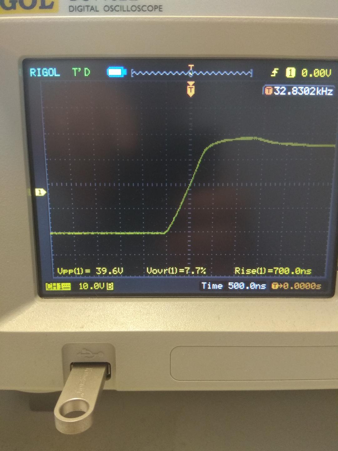

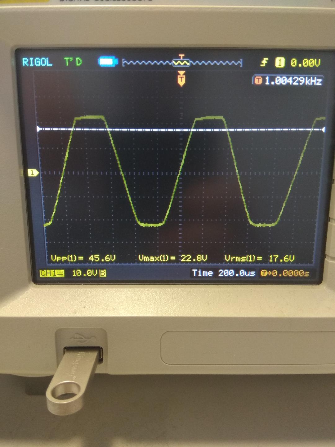

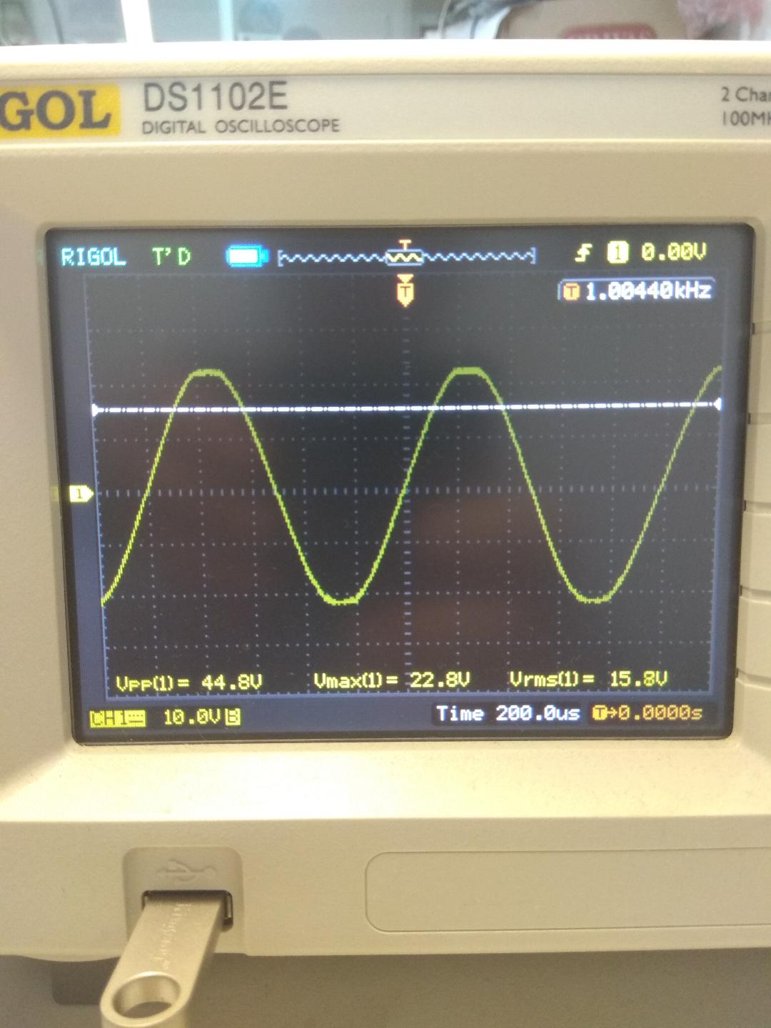

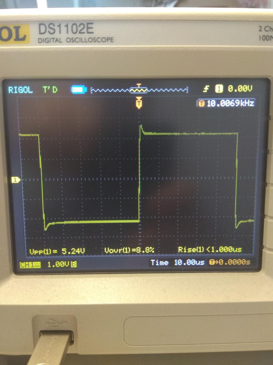

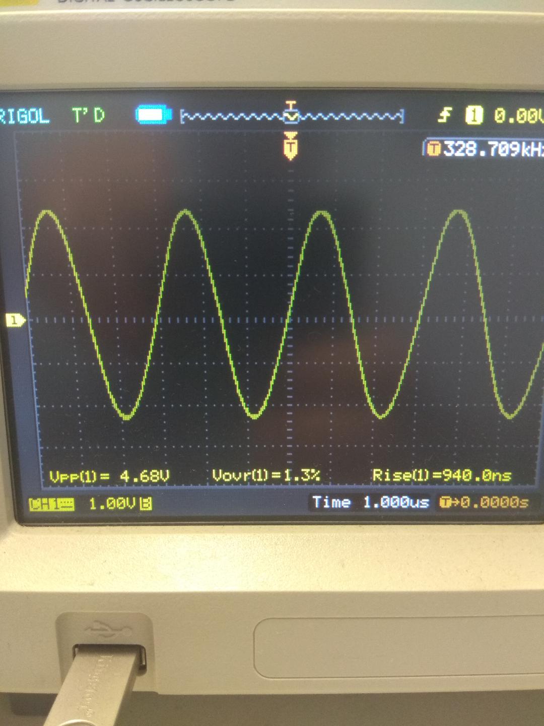

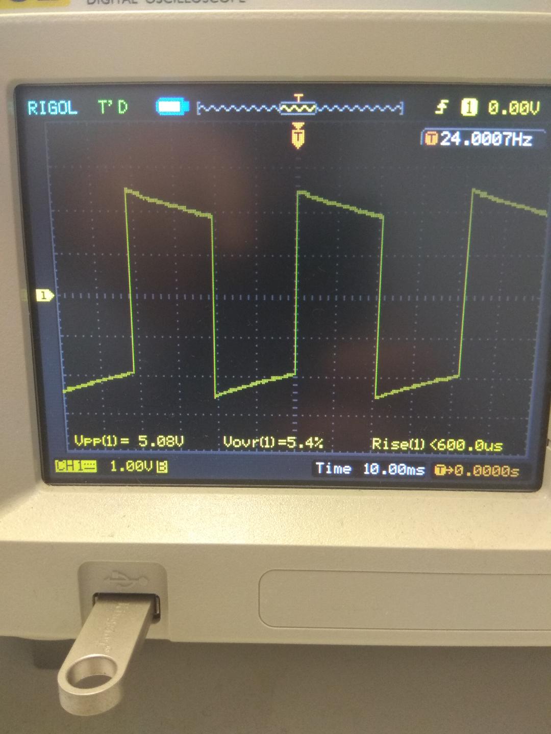

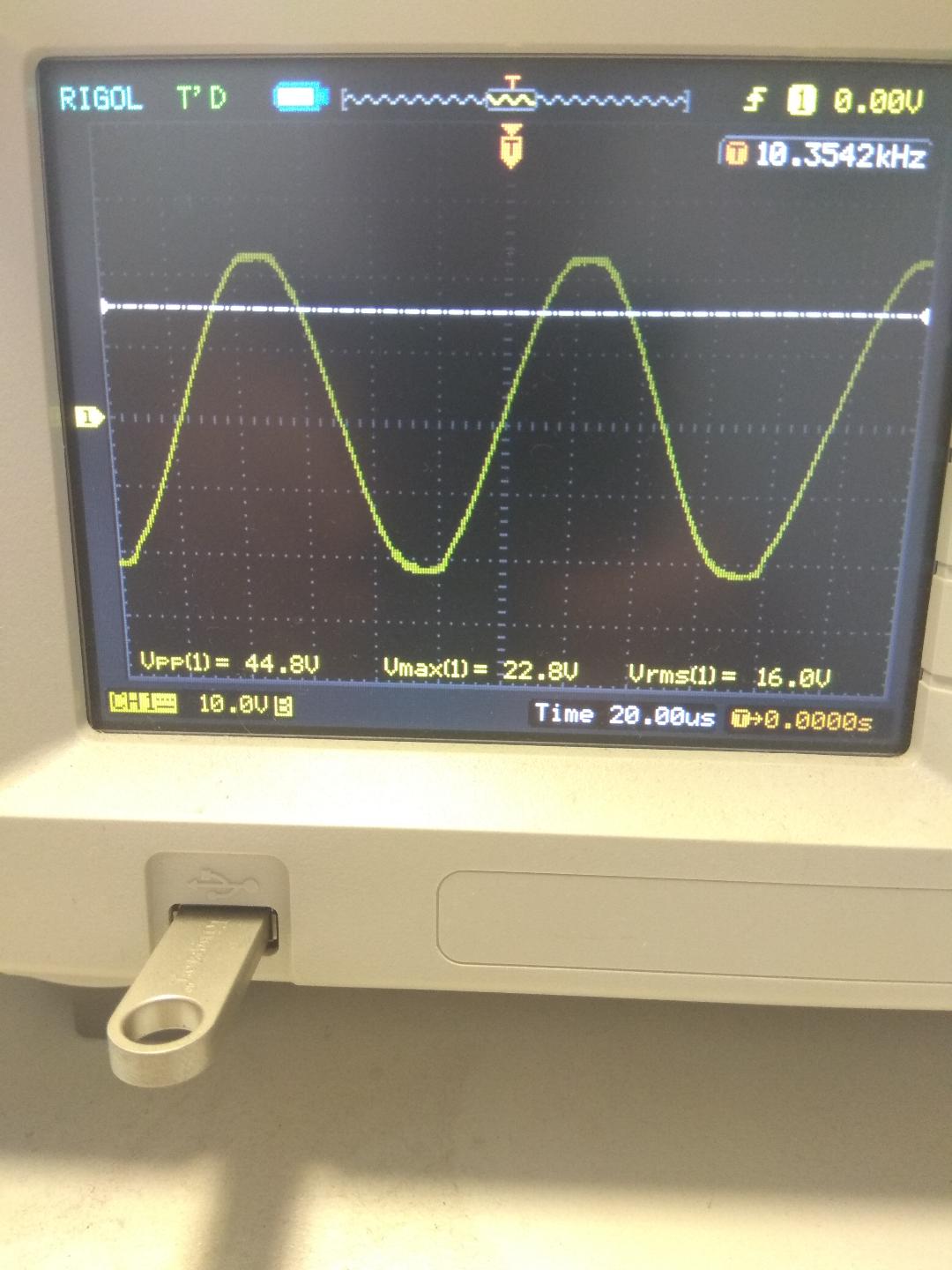

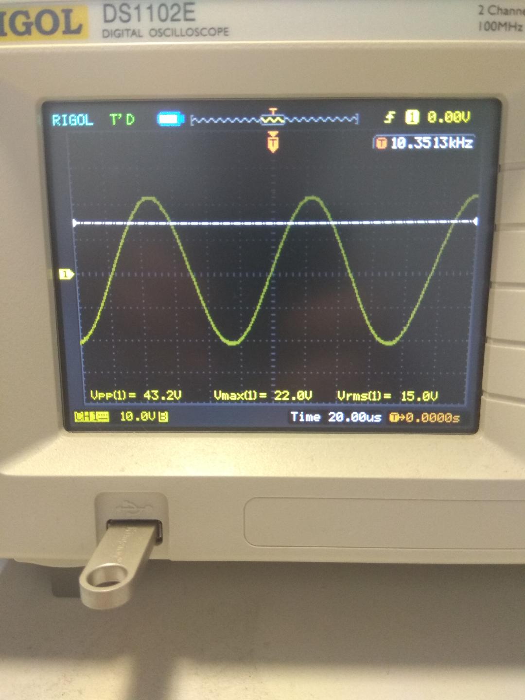

Scope test
Here is the scope measurements.
Clearly shown a little overshot.

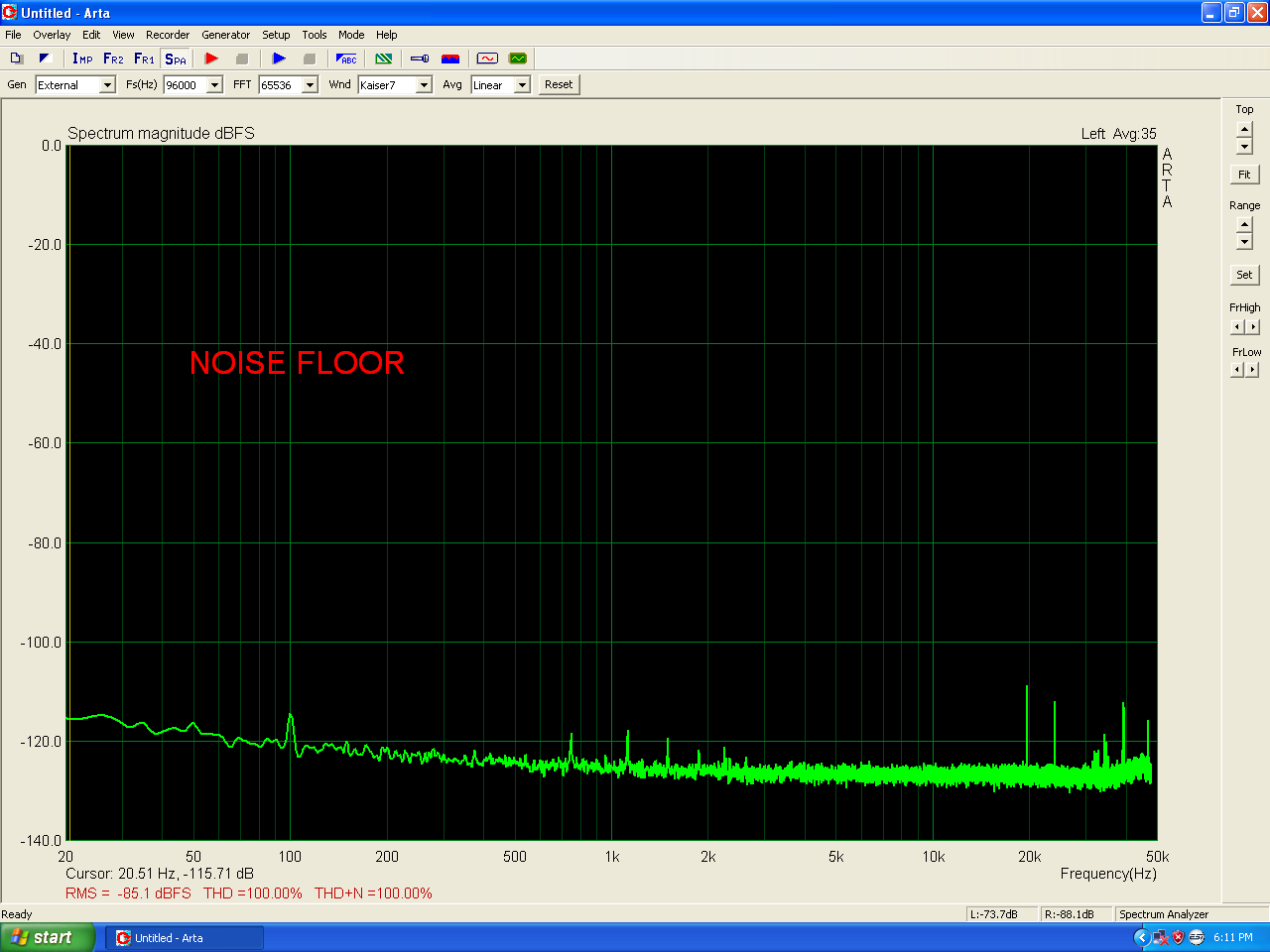

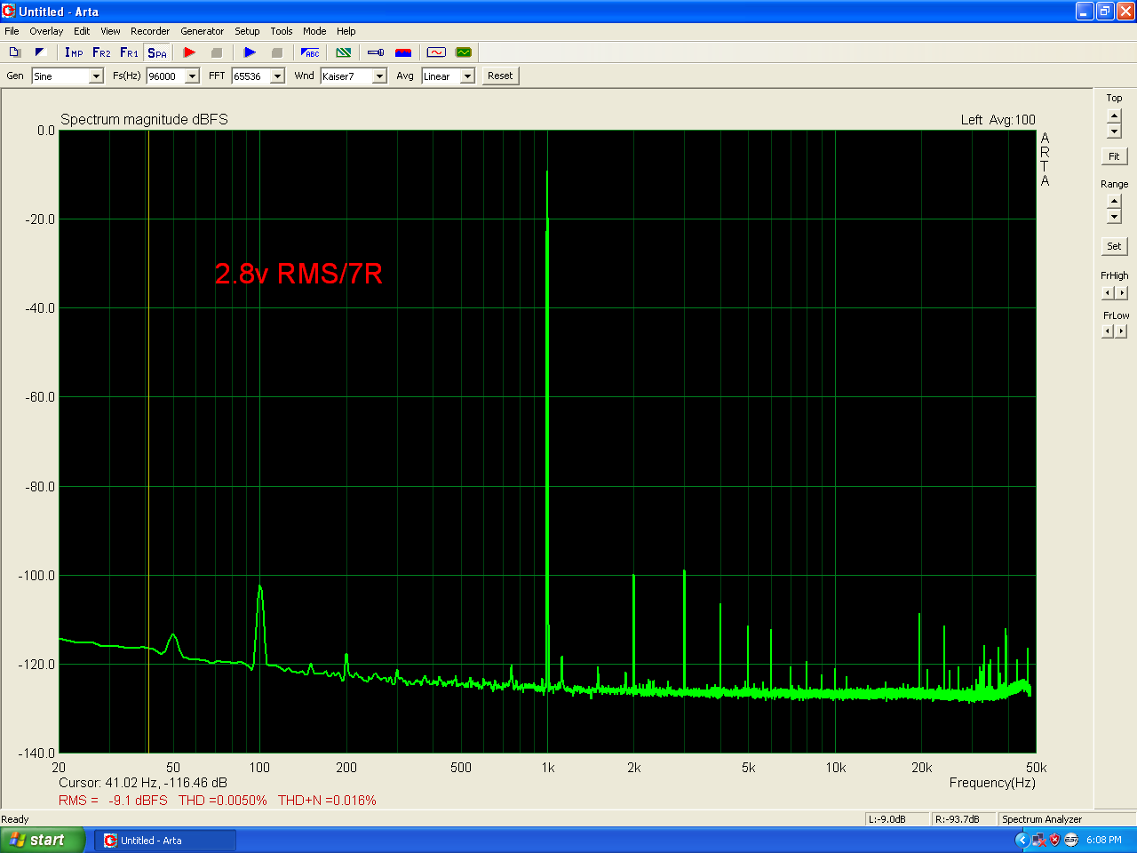

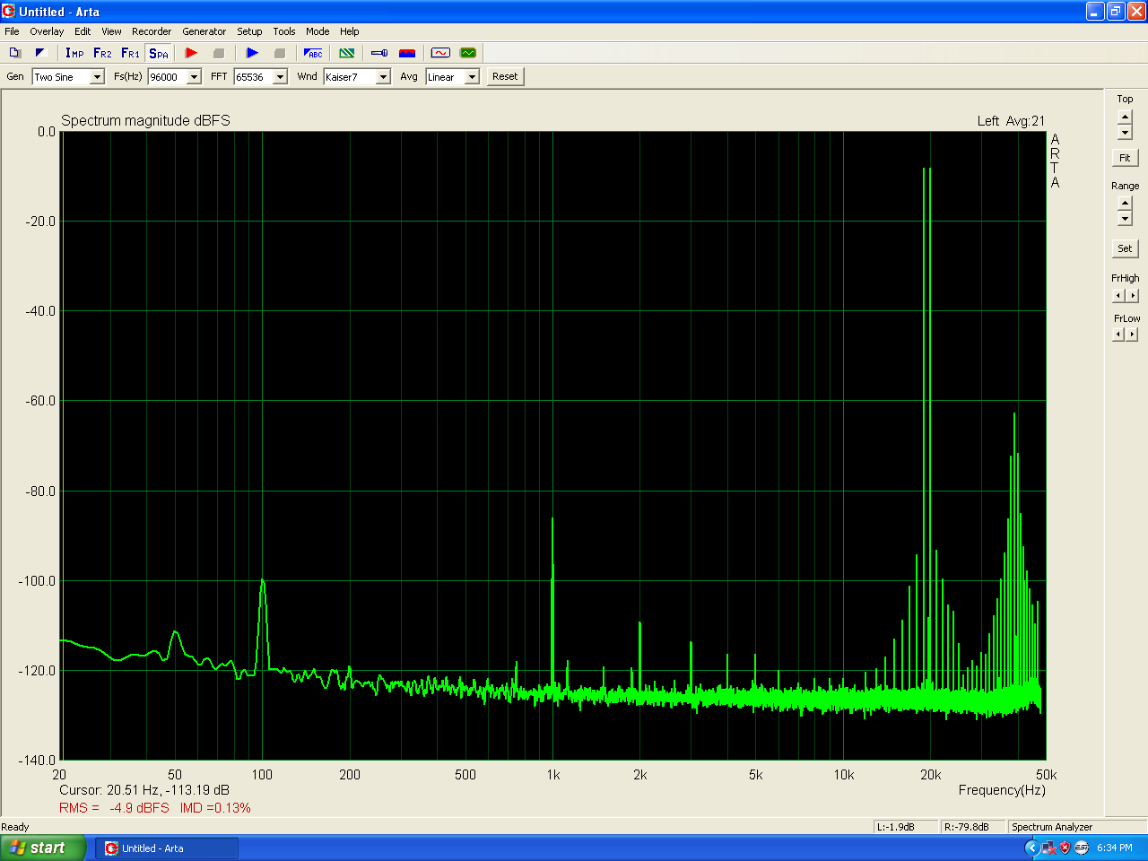

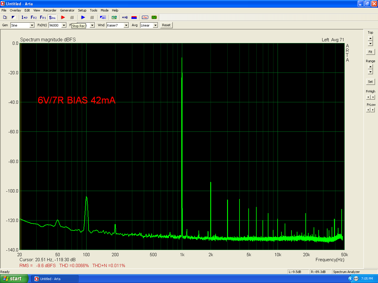

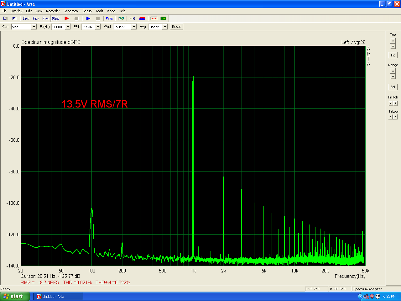

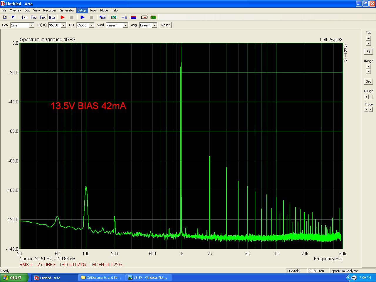

Here is the fft analyze.

Hi Thimios,
After seeing the schematic I was interested, and when I saw the harmonic profile I was VERY interested.......

Just checked Anistardi´s site to check the schematic.
I use transistor TO92 transistor driver only for amplifier with PSU 25VDC maximum. With optimal bias class AB, it is OK. It is verify on simulator, and many people was built them. Of course, it is can not use higher bias.
BD139 for thermal sensor, because it easy to mount and cheap 😀 😎

I'am afraid Thimios can not review of listening test, because as he said, he do not have proper speaker.
Hi, Mr. Hugh, I think you like harmonic profile of this amplifier 🙂
I think, the distortion can be reduce a bit if he use higher bias for the mosfet.

Yes, Bimo, very nice profile, but I would be quite happy with higher THD as long as the profile is just the same.
It's a very good amp, with good manners in all the difficult tests.
Congratulations to you, and to Thimios!

Thank you to Dadod, who invented OITPC compensation.
With some topology, wider loop gain can have monotonic harmonic profile.
